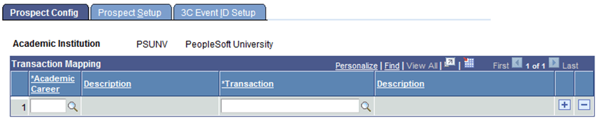

This example illustrates the fields and controls on the Prospect Config page.
Prospect Config (configuration) page
You can enter only online transactions in the Transaction field. PDL does not support online transactions so you should not populate this page.

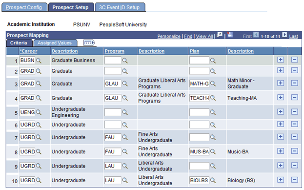

This example illustrates the fields and controls on the Prospect Setup page: Criteria tab. You can find definitions for the fields and controls later on this page.
Prospect Setup page: Criteria tab (Prospect/Admissions Data Load)

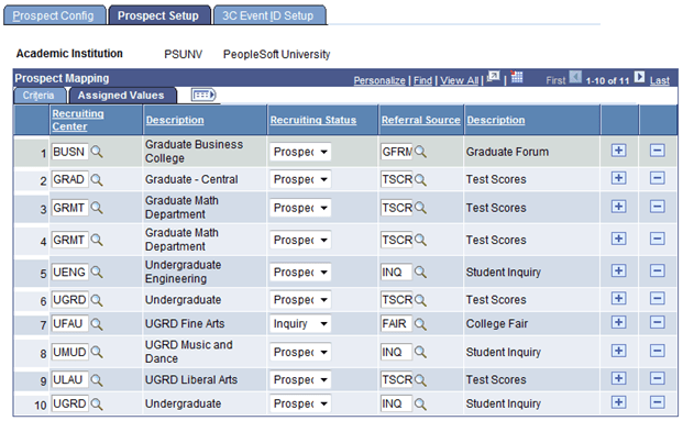

This example illustrates the fields and controls on the Prospect Setup page: Assigned Values tab. You can find definitions for the fields and controls later on this page.
Prospect Setup page: Assigned Values tab (Prospect/Admissions Data Load)
Ensure that all the academic career, program, and plan combinations for File Parser PDL transactions are mapped to a valid recruiting center on the Prospect Setup page.
Use the Criteria tab to define the selecting criteria — such as academic career, academic program, and academic plan — that will constitute a particular group of prospects. Use the Assigned Values tab to define the recruiting center that the system can assign to the particular prospect group. For batch prospects loaded through File Parser, a calculated field can be built on the file mapping definition to look at this setup to determine the recruiting center to populate.
The system requires a recruiting center to create a prospect. Therefore, you must map each career with a recruiting center on the Prospect Setup page to be used with a calculated field through File Parser unless you define a default recruiting center on the File Parser mapping definition.
Criteria
Field or Control Description
Career
Enter the career for which you want to assign a recruiting center.
Program
Optionally, enter the program for which you want to assign a recruiting center.
Plan
Optionally, if you have entered a program, enter the plan for which you want to assign a recruiting center.
When determining the recruiting center assignment, the delivered calculated field example uses the following order: academic plan, academic program, and academic career.
Assigned Values
Enter the recruiting center, recruiting status and referral source for the row entered on the Criteria tab.

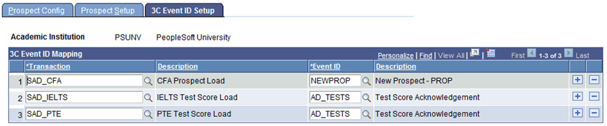

This example illustrates the fields and controls on the 3C Event ID Setup page. You can find definitions for the fields and controls later on this page.
This is an optional setup. If you want to assign a 3C event ID for a specific transaction, set up this page. The 3C event ID will be inserted into the 3C Trigger Results table upon posting the PDL transaction.
Only the event IDs that have the administrative functions GEN (General), PROS (prospect) and PROP (prospect program) are available. Select an event ID for PROP only if you are certain you will be populating prospect program. Define event IDs on the Event Definition page.
