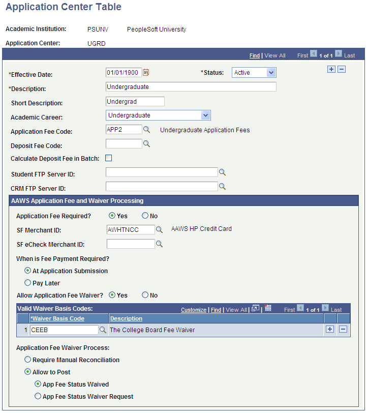

Setting Up Application Processing Centers
Access the Application Center Table page (Set Up SACR, and then Product Related, and then Recruiting and Admissions, and then Applicants, and then Application Center Table).
This example illustrates the fields and controls on the Application Center Table page. You can find definitions for the fields and controls later on this page.
You assign applications and link recruiters to application centers. This helps you to identify the applications and recruiters who belong to a particular admissions office.
Application centers are where admissions applications are processed. By defining application centers, you can track which office is handling a specific application. This is especially useful if you have decentralized processing for academic careers.
Field or Control Description
Academic Career
Select an academic career if this application center is for only one academic career. If you want this application center available to all careers, leave this field blank. Define academic careers on the Academic Career Table page.
Application Fee Code
Select the appropriate application fee code for this application center. Define application fee codes on the Application Fees page in PeopleSoft Student Financials. If you do not charge an application fee, you can leave this field blank.
Deposit Fee Code
Select the appropriate deposit fee code used for this application center. Define deposit fee codes on the Deposit Fees page in Student Financials. If you do not charge deposits, you can leave this field blank.
Calculate Deposit Fee in Batch
Select if you want to allow users to save applications without calculating a deposit fee. When you enter a status of Admitted on the Application Program Data page, the system does not prompt you to calculate the deposit. Rather, you use the Deposit Fees Calc (deposit fees calculation) batch process (SFPBADEP) to calculate the deposit fee. This enables you to automate the deposit fee calculation process.
If you clear this check box, the system does prompt you to calculate a deposit fee when you enter a status of Admitted on the Application Program Data page.
AAWS Application Fee and Waiver Processing
AAWS application fee processing uses staging data in the Application Transactions component.
Use this group box to set up the options for AAWS application fee and waiver processing.
SF Merchant ID and SF eCheck Merchant ID
Select a SF Merchant ID (for credit card) or a SF eCheck Merchant ID or both for AAWS fee processing. Based on this setup, during the AAWS fee calculation and payment process, a List of Values web service determines which payment methods are available to an applicant on the external User Interface site.
A merchant ID is a user-defined element that defines the rules for interfacing with a third party payment processor. Define Student Financials merchant IDs on the SF Merchants page (Set Up SACR, Common Definitions, Self Service, Student Financials, SF Merchants).
See Student Financials: Setting Up SF Merchants.
When is Fee Payment Required
If you select Pay Later, the payment processing must be handled outside of AAWS processing. The online application can be submitted and be posted to the core production Application Maintenance component but your institution must follow up with the applicant and process the payment outside of AAWS processing.
Allow Application Fee Waiver
If you select Yes, the Valid Waiver Basis Codes group box and Application Fee Waiver Process fields become available.
You can select from waiver basis codes that have been set up on the Application Fee Waiver Basis page (Set Up SACR, Product Related, Recruiting and Admissions, Applicants, Application Fee Waiver Basis).
  • If you select Require Manual Reconciliation, an administrator must approve or deny the waiver in the Application Transactions staging component before the application can be posted to core production.
  • If you select Allow to Post, the application can be posted to core production and the administrator assesses the waiver request in the Application Maintenance component.
    If your school allows waivers but automatically grants the waiver without review or assessment, you can select App Fee Status Waived as the Allow to Post option. When the application is posted, the Fee Status field value in Application Maintenance is set to Waived.
    If your school requires waiver requests to be assessed, select App Fee Status Waiver Request as the Allow to Post option. When the application is posted, the Fee Status field value in Application Maintenance is set to Waiver.
