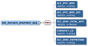

Input Message: SSF_INITIATE_EPAYMENT_REQ
This image shows the input parameters that the SSF_INITIATE_EPAYMENT service operation receives from an online application.
SSF_INITIATE_EPAYMENT_REQ Message Parameters
Required data that the online application must supply to the service operation:
  • Payment Application
  • Payment Application Key (Application Number)
  • Payment Amount
  • Currency Code
  • Payment Method (Credit card or electronic check)
The following is an example of the SSF_INITIATE_EPAYMENT_REQ message that the SSF_INITIATE_EPAYMENT service operation receives from an online application:
<?xml version="1.0"?>
<SSF_INITIATE_EPAYMENT_REQ xmlns="http://xmlns.oracle.com/Enterprise/HCM/services">
  <SCC_PMT_APPL>SADAAWS</SCC_PMT_APPL>
  <SCC_PMT_APPL_KEY>00024828</SCC_PMT_APPL_KEY>
  <SCC_EPAY_TOTAL_AMT>20</SCC_EPAY_TOTAL_AMT>
  <CURRENCY_CD>USD</CURRENCY_CD>
  <SCC_EPAY_PAYMETHOD>CC</SCC_EPAY_PAYMETHOD>
</SSF_INITIATE_EPAYMENT_REQ>
