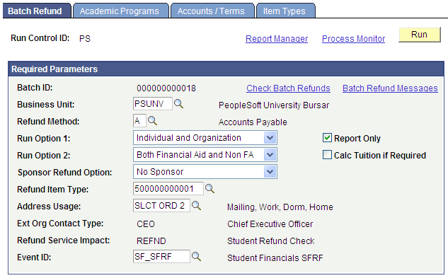

Defining General Parameters
Access the Batch Refund page (Student Financials, and then Refunds, and then Process Batch Refunds, and then Create Refunds, and then Batch Refund).
This example illustrates the fields and controls on the Batch Refund page. You can find definitions for the fields and controls later on this page.
Batch Refund page
Field or Control Description
Batch ID
Displays the unique ID assigned after you save your batch refund parameters.
Check Batch Refunds
After you run the process, click to access the Batch Refund Lines page and view created refunds.
Batch Refund Messages
After you run the process, click to access the Review Batch Messages page and view warnings or errors that the system encountered during the process.
Refund Method
Select a refund method.
The value in the Refund Method field on the Refund Setup page (SF Business Unit component) appears here by default.
If you select the Allow Changes in Refund Method check box on the Refund Setup page, you can change the value in the Refund Method field here.
Run Option 1
Select the type of recipients to create refunds for. Values are: Individual Only, Organization Only, or Individual and Organization.
Run Option 2
Select the types of credits to create refunds for. You can create refunds for financial aid credits (credits with an item type classification of Financial Aid), nonfinancial aid credits (credits with an item type classification other than Financial Aid), or both.
Report Only
Select to generate a report listing what refunds the system would create. When selected, the process does not actually create the refunds listed in the report.
Calc Tuition if Required (calculate tuition if required)
Select to calculate tuition for students who have not already had their tuition calculated or who need tuition recalculated.
Sponsor Refund Option
Select whether you want to include sponsors in the process, and if so, what types of sponsors.
Refund Item Type
Select the item type to assign to the refunds that the Batch Refund process creates.
Address Usage
Enter how the system chooses the proper address for each refund.
External Org Contact Type (external organization contact type)
Displays the contact type that you specified on the Refund Setup page of the SF Business Unit component. The system uses this contact type to determine the recipient of any organization refunds generated by the batch process.
Refund Service Impact
Displays the refund service impact that you specified on the Refund Setup page of the SF Business Unit component. The system uses this service impact during the batch process to identify any students who should be prevented from receiving a refund.
Event ID
This field is available only if A/P is selected in the Refund Method field on the SF Business Unit - Refund Setup page.
The value that appears in this field by default is based on the Event ID field value on the Refund Setup page in the SF Business Unit component.
The batch refunding process stamps the refund data with the event ID that you select here and the 3C engine uses the value when it generates email notifications.
See Understanding Refunding Setup.
