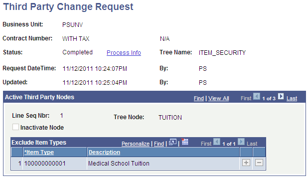

Creating Third-Party Contract Change Requests
Access the Third Party Change Request page (Student Financials, and then Payment Plans, and then Third Party Contract, and then Contract Node Change Request, and then Third Party Change Request).
This example illustrates the fields and controls on the Third Party Change Request page. You can find definitions for the fields and controls later on this page.
Field or Control Description
Contract Number
This field is populated when a request is created. Only active third party contracts are available for processing.
Status
Select a status:
  • Open: Indicates that a request has been created and is waiting to be processed. Only one request per contract can have a change status of Open at the same time. An open request can be modified and submitted for processing. A status of Open is selected by default.
  • Canceled: The administrator has canceled the request. An administrator can change an Open request to Canceled.
  • Completed: This status is set after the Process Node Change Request has completed successfully.
  • Submitted: This status is set once the Process Node Change Request has been submitted for processing.
  • Error: This status is set if errors occur during the Process Node Change Request processing.
Process Info
Click this link to view additional details for requests with a status of Completed or Error.
Tree Node
All active tree nodes in the associated tree are displayed.
Inactivate Node
Select this check box to inactivate the entire node. All associated item types are excluded. For example, if housing charges are not to be paid by the third party, inactive the HOUSING node.
You can inactivate a node at any time, unless it is the only active node.
If the Inactivate Node check box is selected, the Exclude Item Types scroll is hidden.
Item Type
Enter the item type that you want to exclude. For example, if a third party does not want to pay the Internship Tuition, exclude the item type 100000000016 from the TUITION node. In this case, charges for the specific item type are not paid by a third party.
The change request is stored in a staging table. After you make a request, you must run the Process Node Change Request (SFPTPREQ.CBL) process.
See Processing Third-Party Contract Change Requests.
