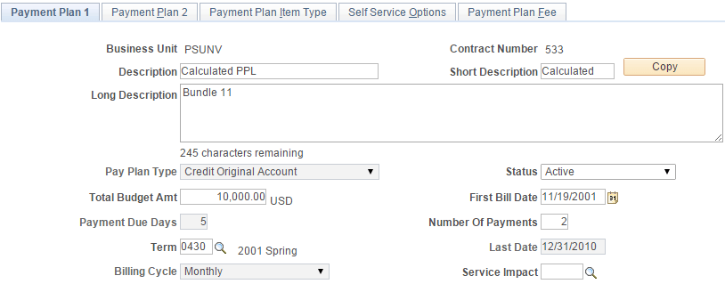

Defining Basic Payment Plan Contract Parameters
Access the Payment Plan 1 page ((Student Financials, and then Payment Plans, and then Payment Plan, and then Create, and then Payment Plan 1).
This example illustrates the fields and controls on the Payment Plan 1 page. You can find definitions for the fields and controls later on this page.
Payment Plan 1 page
Field or Control Description
Description
Enter a description. This also appears in Self Service Enroll in a Payment Plan.
Pay Plan Type
Define how the system credits payments made to this plan. Values are:
Credit the Original Account: Select to credit all eligible charges and create a new payment plan charge.
Create Billing Entries: This option should not be used with any of the three payment plans.
Status
Specify whether the payment plan contract is active or inactive. You can change the status of a contract to Inactive regardless of the status of any students that are associated with it.
Note: You should change the contract status to Inactive on any calculated payment plans for previous terms. This enhances performance because of the way the system automatically recalculates active contracts. An active contract is one for which both the contract and student status have a value of Active, and the last date of the contract is greater than the current system date. When the system recalculates contracts for a student, it evaluates all active contracts for that student. You do not need to set the student status to Inactive to receive this performance benefit as long as you have set the appropriate contract status to inactive.
Total Budget Amt (total budget amount)
This should be defined in conjunction with all eligible charges. Enter the maximum amount of installment payments that a student can make through the payment plan account. Carefully consider all eligible charges when you establish this figure to make sure that it is high enough to cover all the intended costs.
For lump sum plans, the total budget amount becomes the default lump sum amount. You can adjust this amount for each student who is linked to the plan.
First Bill Date
Set the date on which you generate the first bill for the payment plan. The system uses the first bill date and the billing cycle to set the billing dates for the duration of the payment plan. You can override this setting for each student who is linked to the plan.
Note: The billing program does not acknowledge the payment plan until on or after the first bill date specified. For example, if your first bill date is set for November 16 and you run your billing process on the 15th, the system does not process Payment Plan billing until the next run.
Payment Due Days
Enter the number of days after the bill date that the payment is due.
Number of Payments
Enter the number of payments (installments) that students must make to pay off the plan. The system uses the information in this field as the default value. You can override the number of payments for each student who is linked to the plan.
Term
This field is required for calculated payment plans. Enter the term that the system posts on the payment plan credit and the installments.
This field is optional for existing and lump-sum payment plans.
Note: When a payment plan covers charges in more then one term, you must clear the Account Per Term check box on the Accounts Types page for the payment plan account type.
Last Date
Enter the last date that charges can be added or adjusted and still be picked up by the plan.
Billing Cycle
Specify the frequency of creating a bill.
You should not select a value of User Selected for calculated payment plans or payment plans that are used in Self Service.
Service Impact
Enter the service impact that would prevent enrollment into the payment plan.
This prevents enrollment into the payment plan through Batch Assignment, Assign Page, and Self Service.

Defining Payment Plan Administrative Fees
Access the Payment Plan Fee page (Student Financials, and then Payment Plans, and then Payment Plan, and then Create, and then Payment Plan Fee).
This example illustrates the fields and controls on the Payment Plan Fee page. You can find definitions for the fields and controls later on this page.
Type of Assessment
Select the type of assessment. You can leave this field blank if you do not want to assess a fee. When you leave the field blank, all of the other fields on the page become unavailable. If the majority of the students who are associated with this payment plan should be assessed a fee, select one of the following options. When linking each student to the payment plan, you can waive the fee on an individual basis.
Monthly Interest Rate: Select to charge interest that is calculated monthly against the outstanding balance in the plan. When you select this option, you must also set a monthly interest rate.
Note: This option is not available with calculated payment plans.
Payment Plan Fee: Select to assess a fixed amount fee. If you select this option, the Payment Plan Fee, Assessment Fee Split, and the Assessment Item Type fields become available.
Percentage of Payment Plan: Select to assess a fee based on a percentage of the plan's initial balance. If you select this option, the Percentage of Payment Plan, Assessment Fee Split, and the Assessment Item Type fields become available.
Payment Plan Fee
Enter an optional flat-amount payment-plan fee if your institution assesses a flat fee for payment plans. This field is available only if you select Payment Plan Fee in the Type of Assessment field.
Enter the percent amount that you want the system to use when you select Percentage of Payment Plan in the Type of Assessment field.
Enter a monthly interest rate that you want to charge when you select Monthly Interest Rate in the Type of Assessment field.
Select how you want to split the assessment fee. This field is available only if you select Payment Plan Fee or Percentage of Payment Plan in the Type of Assessment field.
Add to first installment: Select to apply the entire assessment fee to the first payment of the contract.
Add to last installment: Select to apply the entire assessment fee to the last payment of the contract.
Split over all installments: Select to divide and apply the assessment fee equally over all payments.
Enter the item type that you want to use for the assessment fee.
