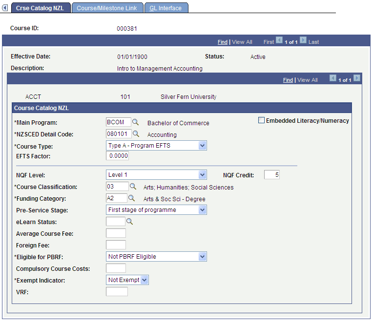

Crse Catalog NZL (course catalog New Zealand)
SSR_CRS_CAT_NZL
Curriculum Management, and then Course Catalog, and then Course Catalog, and then Crs Catalog NZL
Set up SDR and EFTS data for a course.
Note: The fields on this page are available only if you select the New Zealand Catalog, SDR, EFTS, StudyLink check box on the Academic Institution 6 page. You should also select the New Zealand NSI and SDR Personal Data, SDR Degree check box on the SA Features page in the Student Administration Installation component.

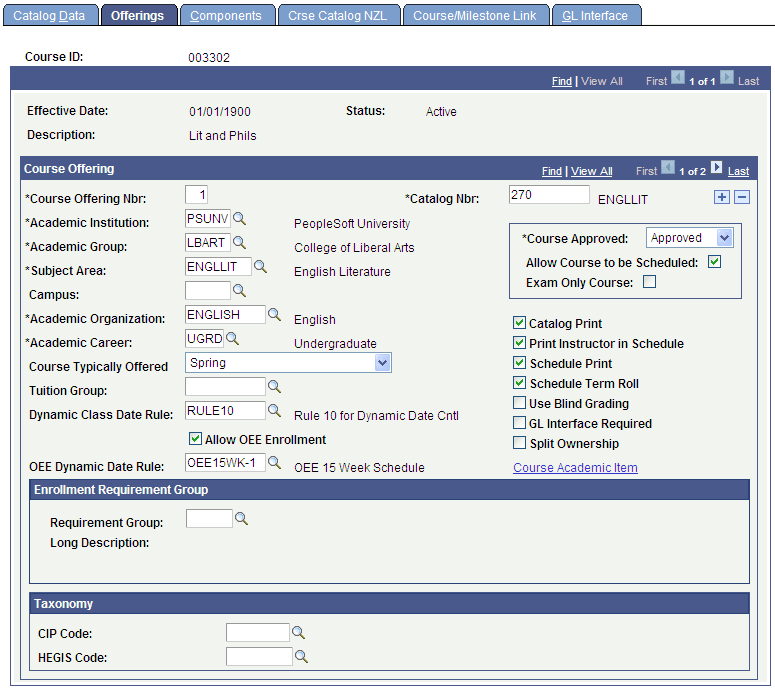

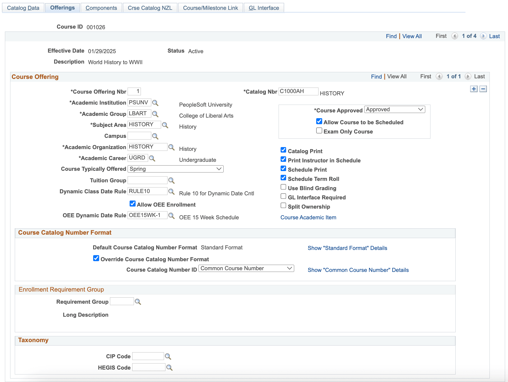

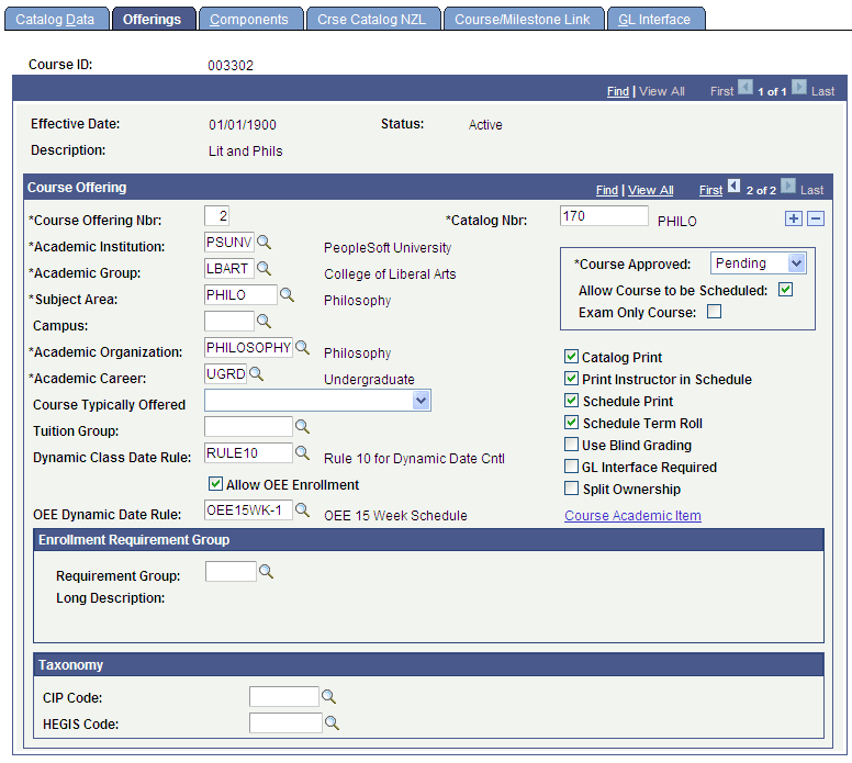

Defining Course Offerings
Access the Offerings page (Curriculum Management, and then Course Catalog, and then Course Catalog, and then Offerings).
This example illustrates the fields and controls on the Offerings page. You can find definitions for the fields and controls later on this page.
Offerings page
Field or Control Description
Course Offering Number
The system generates the course offering number and uses it for sequencing. The system also uses the course offering number to distinguish cross-offered courses for which the course ID is the same, as are the requisites, but the course itself is listed in different subject areas, academic groups, and so on.
Catalog Number
Within an academic group, catalog number ranges are linked to academic careers on the Academic Group Table page. If you have already specified an academic group for this course offering, the system automatically displays the appropriate academic career when you enter a catalog number. This field is 10 digits. The system reserves the four left digits exclusively for numeric characters, and the right six digits for both alpha and numeric characters. A field edit enforces this programming.
Course Typically Offered
Values available here are defined in the Course Typically Offered component.
See Defining When a Course is Typically Offered.
The system automatically reformats the catalog number you enter to fit the defined system format, as this table illustrates:
Catalog Number N N N N A/N A/N A/N A/N A/N A/N
The system displays the academic institution by default. Multiple institutions can offer the same course by way of multiple course offerings.
Academic Group
Enter the academic group to which this course offering belongs. You can define global notes by academic group, which can appear on the Schedule of Classes report. In addition, academic group controls the valid meeting pattern values and their corresponding normal class duration values. Academic group values are defined on the Academic Group Table page.
Subject Area
Enter the subject area of the course offering. Subject area values are defined on the Academic Subject Table page.
Campus
Enter the campus at which your institution offers the course. If the course is offered at one campus, you should place a value in this field. If the course can be offered at multiple campuses, leave this field blank.
Academic Organization
The system populates this field by default from the academic organization linked to the subject on the Academic Subject Table page. You can override the value.
Academic Career
Enter the academic career to which this course offering belongs. The system automatically displays the default values of the Dynamic Class Data Rule, Allow OEE Enrollment, and OEE Dynamic Date Rule fields according to your settings for these fields in the Academic Career Table component. The default values of these fields vary depending on the academic career that you enter and the effective date of the course. Academic career is important because it specifies which students can enroll in the class (in accordance with the Academic Career Pointers page specifications), as well as which grading bases are available.
Tuition Group
The system charges tuition based on the student’s enrollment records. If the tuition group that you set on this page matches the student’s assigned tuition group, the additional fee defined on the course component is assessed.
Dynamic Class Date Rule
If you have specified a dynamic class data rule for the academic career to which you assign this course offering, the system displays that rule by default in this field. You can override the default value. Select a dynamic class date rule to have the system assign that rule by default to all dynamic class sections of this course offering that you schedule (excluding open entry and open exit sections). Attaching your rule to the course offering rather than to the class section ensures consistency and eases maintenance because you only have to attach the rule to a course one time (to apply to all class sections), rather than having to attach a rule to each course offering that you schedule. The system requires dynamic date calculation for each class section that you schedule for this course offering. After you schedule the class sections, you can run the Dynamic Class Dates process to calculate landmark dates for each class section. The process automatically uses the rule that you specify here for all dynamic date class sections. You can override this default rule on a section-by-section basis through the Dynamic Class Date page. This field prompts you with only the dynamic class data rules that have not been designated for OEE enrollment on the Dynamic Class Dates page. If you leave this field blank and schedule the course within a dynamic date session, you receive a warning message indicating that a rule has not been defined. You need to define a rule on the Dynamic Class Dates page.
Allow OEE Enrollment (allow open entry/exit enrollment)
The system assigns the value of this check box by default based on the Allow OEE Enrollment check box on the Academic Career Table page for the academic career with which you have associated this course offering. You can override this default on an offering-by-offering basis. Select this check box to attach a dynamic date rule to the offering, thus enabling students to enroll in OEE class sections of this course offering. The OEE Dynamic Date Rule field becomes available for edit. If you do not select the check box, you can always define the rule on the Dynamic Class Dates page.
OEE Dynamic Date Rule (open entry/exit dynamic date rule)
The system assigns the value of this field by default based on the OEE Dynamic Date Rule field on the Academic Career Table 2 page for the academic career with which you associate this course offering. An open entry/exit (OEE) dynamic date rule is a dynamic class date rule that has been designated for OEE enrollment. The enrollment engine uses the OEE dynamic date rule to calculate significant class dates for a student whenever a student enrolls in an open entry/exit class. This field is available for edit only if you select the Allow OEE Enrollment check box for this course offering. Select an OEE dynamic date rule to have the system assign that rule by default to all OEE class sections of this course offering that you schedule. Attaching your rule to the course offering rather than the class section ensures consistency and eases maintenance because you only have to attach the rule to a course one time (to apply to all class sections), rather than having to attach a rule to each course offering that you schedule. The system thus automatically requires dynamic date calculation for each OEE class section that you schedule for this course offering. After you schedule the class sections, you can run the Dynamic Class Dates process to calculate landmark dates for each class section. The process automatically uses the rule that you specify here for all OEE class sections. You can override this default rule on a section-by-section basis through the Dynamic Class Data page. The system prompts you with only the dynamic class data rules that have been designated for OEE enrollment on the Dynamic Class Dates page.
If this field is blank and you schedule the course within an OEE session, you receive a warning message that indicates a rule has not been defined. You can then save the page and define the rule on the Dynamic Class Dates page.
Course Approved
Enter the course approved status. Values for this field are delivered with your system as translate values. Do not modify these values in any way. Any modifications to these values requires a substantial programming effort. Enter Pending or Denied to prevent anyone from scheduling the class—the system does not list the course in the class scheduling function. Enter Approved and select the Allow Course to be Scheduled check box to enable scheduling of the course offering.
Select this check box so that the course can be scheduled for a term. A course can only be scheduled for a term if you select this check box and set the Course Approved field to Approved.
Exam Only Course
Select this check box when a course will have no class sections scheduled and the only requirement for the course is that students must complete an examination. When the check box is selected, the Allow Course to be Scheduled field is disabled and the field defaults to the Activity Registry when this course is entered as the Course Control Record.
For courses that are set up solely as transfer articulation courses, set the Course Approved field to Approved but clear the Allow Course to be Scheduled check box. This setting ensures that you never accidentally schedule the course.
Catalog Print
Select to display the course offering in the course catalog report.
Print Instructor in Schedule
Select to display the names of all the assigned instructors in the schedule of classes report.
Schedule Print
Select to display the course offering in the schedule of classes. The system selects this check box by default.
Schedule Term Roll
Select to enable the prior term copy function for this course offering.
See Copying Classes from One Term to Another.
Use Blind Grading
Select to enable grade rosters for blind grading. The system populates this field by default from the Academic Subject Table page.
When you generate grade rosters for a course that invokes blind grading, instead of student names on the roster, the system generates random numbers.
See Printing Grade Rosters
See Entering Grades Online
GL Interface Required
Select to include this class in the GL Interface process. If you select this check box, the system requires you to enter the necessary data into the GL Interface page of this component.
Split Ownership
Select if multiple academic organizations own the course. If you select this check box, the Owner group box becomes available for entry.
Course Academic Item
Click to access the Course Academic Item page.
See Creating Academic Items for Courses
Course Catalog Number Format
Override Course Catalog Number Format
Select to change the delivered course catalog number format for a specific course offering. Select the catalog number ID to edit the catalog number for a specific course offering.
Enrollment Requirement Group
Requirement Group
Enter the requirement group that links the appropriate requisites to this course.
Enrollment requirement group values are defined on the Course Requisite page and can consist of a variety of elements: courses, units, GPA, and so on.
Long Description
The system enters the long description of the enrollment requirement group from the Course Requisites page.
Taxonomy
CIP Code (Classification of Instructional Programs code)
Enter the CIP code for the course. CIP codes provide a taxonomic scheme that support the accurate tracking, assessment, and reporting of fields of study and program completions activity. The system prompts you from the CIP Code Table page.
HEGIS Code (Higher Education General Information Survey code)
Enter the HEGIS code for the course. HEGIS codes provide a taxonomic scheme that support the accurate tracking, assessment, and reporting of fields of study and program completions activity. The system prompts you from the HEGIS Code Table page.
(AUS) Field of Education Code
The system enters the Australia Department of Education, Science and Training (DEST) field of education code that you entered on the Subject Taxonomy page for this course.
Note: This field is available only when you select the DEST, HECS, Centrelink, TAC check box on the Academic Institution 6 page.
(AUS) HECS Band ID (higher education contribution scheme band ID)
The system enters the Australia DEST HECS band ID for the field of education code.
(AUS) Work Experience Indicator
Select the work experience indicator for this course.
This value is used to confirm whether the course is considered wholly or partially work experience in industry for Australian DEST reporting purposes.
(AUS) Summer School Full Fee Ind. E551
Select to indicate whether the unit is a full-fee summer or winter school unit of study.
(AUS) Year Long Indicator E622
Select to indicate that the unit of study is a full year unit.
(AUS) Exclude from HEIMS Reporting
Select to indicate you don’t want to report this course to HEIMS.
(AUS) Use Discipline Group From Plan
Select to disable the discipline group field. The system uses the discipline group from a student's plan when a student enrolls in this course.
(AUS) Discipline Group Code
The system enters the discipline group from the Subject Taxonomy page.
Ownership
Use this group box to link course offerings to multiple academic organizations.
The system assumes a course offering has a single academic organization owner, unless you indicate split ownership on this page. Course ownership data is tracked for reporting and analysis purposes at the course offering level.
Important:
The Ownership group box is only available if you select the Split Ownership check box.
Enter the academic organization owners of the course offering. The system prompts you from the Academic Organization Table page.
Percent Owned
Enter the percentage of ownership. The total percentage must equal 100.

The following examples show the defined course ID number 003302, Literature and Philosophy. It is a cross-offered course in both the English and Philosophy departments. In all ways, the two course offerings are exactly the same. They possess the same description, equivalencies, and so on. On the Offerings page, the course offering number distinguishes the two offerings. In course offering number 1, we indicate that Literature and Philosophy is listed under the English Literature subject area, catalog number 270.
Offerings page example 1
Add another row for course offering number 2. The second offering of Literature and Philosophy is listed under the Philosophy subject area, catalog number 170.
Offerings page example 2
Select the Catalog Print and Schedule Print check boxes to enable printing of both course offerings in the catalog and schedule.

(NZL) Setting Up Government Reporting Data
Access the Crse Catalog NZL (course catalog New Zealand) page (Curriculum Management, and then Course Catalog, and then Course Catalog, and then Crs Catalog NZL).
This example illustrates the fields and controls on the Crse Catalog NZL page. You can find definitions for the fields and controls later on this page.
Crse Catalog NZL (New Zealand) page
Main Program
Enter the main program for this course.
When you generate the SDR course register file, the prospectus code from the program you select here is reported as a qualification code.
NZSCED Detail Code
Enter the NZSCED field of study code for this course.
Set up NZSCED field of study codes on the NZSCED Field of Study NZL page.
Course Type
Enter the course type for this course.
Values are:
  • Type A - Program EFTS
  • Type B - Hourly EFTS
If you enter Type B, the system displays the Hours field, in which you can enter the total hours for the course. The system calculates the EFTS factor based on the new value.
If you enter Type A, the system recalculates the EFTS factor whenever the values change for the UNITS_ACAD_PROG, UNITS_MINIMUM, and UNIT_MAXIMUM fields in the CRSE_CATALOG record. The system calculates the EFTS factor for type A courses by multiplying the academic progress units for the course by the EFTS Translation A value defined for the institution.
EFTS Factor
The system automatically calculates the EFTS factor for the course whenever you add a new course or whenever you change the course type or hours for the course. The system calculates the EFTS factor by multiplying the course hours by the EFTS Transaction B value defined for the institution.
NQF Level
Enter the New Zealand Register of Quality Assured Qualifications level for the credits in this course.
NQF Credit
Specify the number of New Zealand Register of Quality Assured Qualifications credits contained in this course.
Course Classification
Enter the course classification code for this course.
Define course classifications on the Course Classification NZL (SSR_CRS_CLSF_FNDC ) page.
Only Course Classifications that have an effective date less than or equal to the current date and a status of Active are available for selection in the Course Classification field.
Funding Category
Enter the funding category for this course.
Define funding categories on the Funding Category NZL (SSR_FUND_CAT_NZL ) page.
Pre-Service Stage
For courses that are part of a teacher training program, enter the pre-service stage code for the course.
eLearn Status
Enter the eLearn status to indicate whether or not this course is offered through the internet.
Average Course Fee
Enter the average fee for the students enrolled in this course for the reporting period.
Foreign Fee
Enter the tuition fee paid by foreign, fee paying students.
Eligible for PBRF (eligible for Performance Based Research Fund)
Use this field to indicate if a course is eligible for the Performance Based Research Fund.
Compulsory Course Costs
Enter a dollar amount for the total compulsory fees for this course.
Exempt Indicator
Indicate if a course was granted an exemption from FCCM (Fees/Course Costs Maxima).
VRF (Volume of Research Factor)
Use this field to capture Volume of Research Factor data. This field is for informational purposes only.
Embedded Literacy/Numeracy
Select this check box to indicate that the course has an embedded literacy or numeracy component. The check box is cleared by default.
