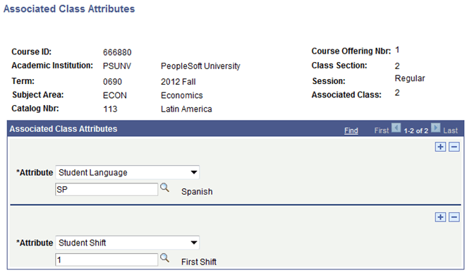

Associated Class Attributes
SSR_ASSOC_CAF
Click the Associated Class Attributes link on the Basic Data page.
Add class association attributes.

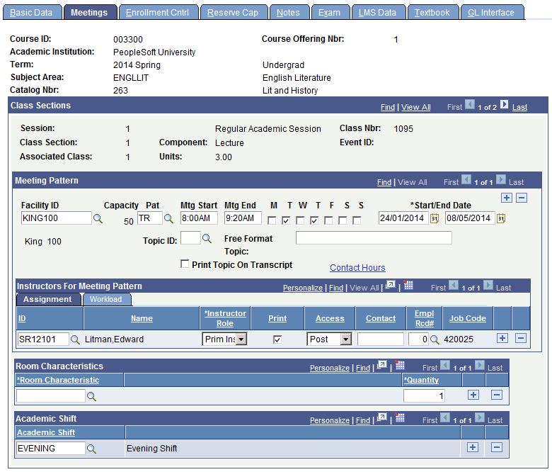

Schedule of Classes - Meetings
CLASS_MTG_PATTERN
  • Curriculum Management, and then Schedule of Classes, and then Schedule New Course, and then Meetings
  • Curriculum Management, and then Schedule of Classes, and then Maintain Schedule of Classes, and then Meetings
Define class meeting patterns and facilities, link instructors to classes, assign instructor workload values, specify room characteristics, and select academic shifts.
Instructor Contact Hours
CLASS_MTG_PAT_HRS
Click the Contact Hours link on the Meetings page.
Review total course contact hours, weeks of instruction, and other contact hours information.

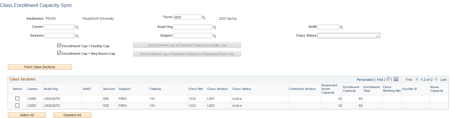

Class Enrollment Capacity Sync
SSR_CLSMTGCAP_SYNC
Curriculum Management, and then Schedule of Classes, and then Class Enrollment Capacity Sync
Review and manage enrollment capacities against facility and requested room capacities.

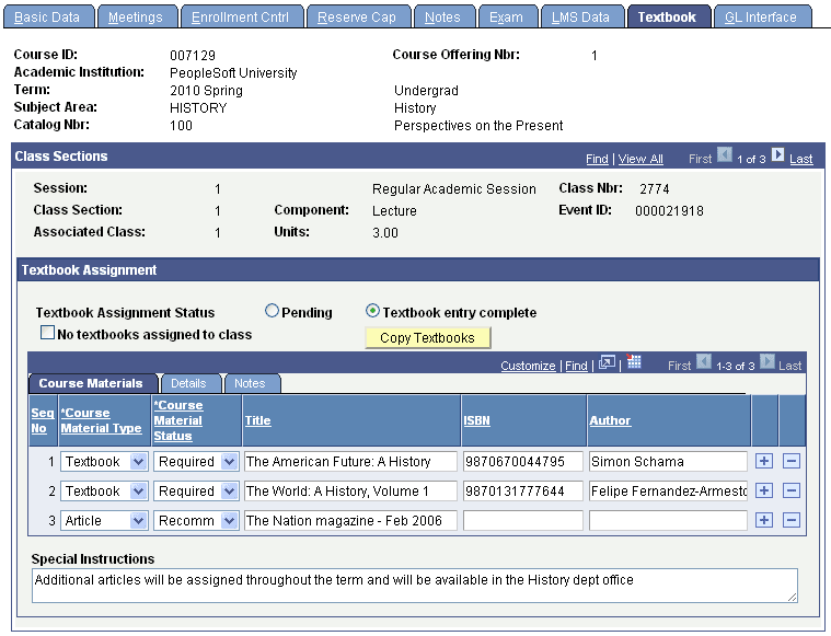

Textbook
SSR_CLASS_TEXTBOOK
  • Curriculum Management, and then Schedule of Classes, and then Schedule New Course, and then Textbook
  • Curriculum Management, and then Schedule of Classes, and then Maintain Schedule of Classes, and then Textbook
Assign textbooks to class sections.

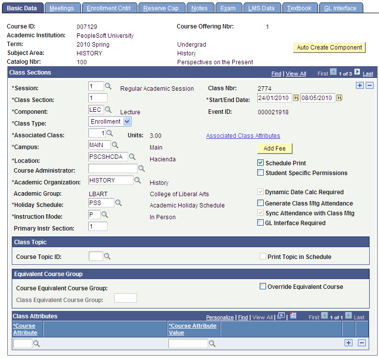

Defining Basic Data for Class Sections
Access the Schedule of Classes - Basic Data page (Curriculum Management, and then Schedule of Classes, and then Schedule New Course, and then Basic Data).
This example illustrates the fields and controls on the Schedule of Classes - Basic Data page. You can find definitions for the fields and controls later on this page.
Field or Control Description
Auto Create Component
If you click this button, the system automatically creates one component for each of the components that you selected to auto create on the Course Catalog - Components page. The system populates the pages in the schedule of classes with the required data for each component. This saves you data entry and ensures that one section for each component is scheduled. If you have multiple class sections for each component type, you must still define the remaining class sections manually.
Class Section
For each component that the system creates automatically, enter the class section number. The system defaults into the Class Schedule Entry page the field values of the preexisting class section.
Note: If you have begun to schedule sections of a course and you then click the Auto Create Component button, the process only creates a section for those components that are set to Auto Create on the course catalog and have not yet been scheduled.
Session
Enter the type of session to which the class sections of this course offering belong. If you want to schedule open entry/exit class sections, you must define them within an OEE session. Session values are delivered with your system as translate values. You can modify the codes and descriptions of these values except for OEE, where you can modify the descriptions only. Any modification to this code requires a substantial programming effort. In order for students to enroll in the OEE class sections that you define, you must either define the OEE Dynamic Date rule for each class section on the Dynamic Class Dates page or the Course Catalog - Offerings page.
Class Nbr (class number)
The system creates a unique class number identifier that students can use when they enroll in a class. The class number appears on the Schedule of Classes report. The system increments this number automatically, based on the number that you specify on the Term Value page.
Class Section
Enter the class section. It must be unique within course offering and session.
Start/End Date
The system populates this field by default to the start and end dates of the session (as specified on the Session Table page). You can override the dates for an individual class. The schedule of classes start and end dates can extend beyond the boundaries of the session begin and end dates.
Component
The system populates this field by default to the graded component on the Catalog Data page (such as Lecture, Laboratory, Discussion, and so on) of the course. You can have multiple components and sections within a course offering.
Class Type
The class type of Enrollment indicates which section is the primary section at enrollment time. The class type of Non-Enrollment is used to indicate that the section choice is the student's secondary enrollment option, or that the section is used in auto-enrollment. Within a class, only one component can possess the class type of Enrollment.
For example, at PSUNV Microbiology 240 has Lecture, Laboratory, and Discussion components. There are 5 lecture, 10 laboratory, and 15 discussion sections. We might select the discussion sections as the Enrollment sections, the lecture sections as the Non-Enrollment section using auto-enrollment, and the laboratory sections as Non-Enrollment sections with a student choice of lab section at enrollment time.
Associated Class
Select an associated class number from the list box, or enter an associated class value of your own. By using associated class numbers, you link class sections that constitute a single course offering. For instance, in our previous example, we'd gather a certain number of lecture, lab, and discussion sections into one associated class number to indicate that the three components are related to one another. If you are scheduling a new section, the system populates the Associated Class field to 1 by default.
When you schedule the first section of a course offering and use the prompt box, the system only displays this default value. You can use a prompt value, or you can manually enter any new one- to four-digit number into the field. Upon saving the page, the system extracts the necessary course data from the course catalog, creates a row in the Class Associations component for this class association number, and populates the row with the appropriate course catalog data. When a student enrolls in a class, the system verifies that the student has enrolled in a section with all required components of the course from within the same associated class number.
If you add a new class associations value to a scheduled class, and you want to make changes to the class association data that the system extracts from the course catalog, you must make your changes on the Class Associations component.
A special associated class number, 9999, enables you to associate a section with any other section. However, you can only use this associated class number for nongraded components.
Click to access the Associated Class Attributes page and add class associations attributes.
See Adding Class Association Attributes Using the Schedule of Classes Component
See Defining Class Associations
Units
The units value is a related display based on the unit range defined on Class Associations component. When first scheduling a course, the system populates the Associated Class field to 1 by default. Once the section is saved, the unit value is defaulted from the Course Catalog to the Associated Class and is displayed on the Schedule of Classes. If the class association unit range is modified, the assigned unit value is accurately reflected on the Schedule of Classes.
On subsequent pages within the Schedule of Classes, the unit range is displayed within the Class Sections group box.
Campus
The system populates the Campus field by default from the Course Catalog - Offerings page, indicating the campus that offers the course. You cannot revise this default. If a specific campus was not identified in the course catalog and does not default, then you can, on a section-by-section basis, schedule classes at various campuses.
Note: Because you cannot revise the campus value if one was provided on the course catalog level, it is best if you do not identify a specific campus on the Course Catalog - Offerings page unless absolutely necessary.
Location
Enter the location of the campus. Location values are linked to campuses on the Campus Table page. A campus must be specified before you select a location.
Course Administrator
Select the course administrator ID of the person in charge of the course (usually the primary instructor). This field is informational only.
Academic Organization
The system populates the academic organization by default from the Course Catalog - Offerings page. The academic organization refers to the organization that offers the class. You can override this value.
Academic Group
The system populates the academic group by default from the Course Catalog - Offerings page.
Note: You can define global notes by academic group, which can appear on the Schedule of Classes report. In addition, academic group controls the valid meeting pattern values and their corresponding normal class duration values.
Instruction Mode
The system populates this field by default to In Person, but you can override the value. The instruction mode indicates whether the class is taught In Person or using Interactive TV, World Wide Web, Correspondence, and so on. Instruction mode values are defined on the Instruction Mode page.
Important: You can generate attendance rosters for only those classes with an instruction mode value of P.
Primary Instr Section (primary instructional section)
Enter the primary instructional section number if applicable. This field is specifically used for distance learning classes. You can use this field to indicate in which section the instructor resides. This field is for informational purposes only.
Schedule Print
The setting of this check box populates by default to the setting on the Course Catalog - Offerings page. Select this check box to display the class in the schedule of classes. If you clear this check box, the section does not display in student or visitor class search when accessed through PeopleSoft Campus Self Service. Students can enroll in these classes, but only if they enter the exact class number (without using the class search feature).
Student Specific Permissions
Select this check box to set up student-specific class permissions.
Student-specific permissions enable instructors or administrators to control section enrollment by granting advance add permission to individual students.
Note: This applies only to add permissions. Drop permissions are always student specific, whether or not the check box is selected.
Include in Dynamic Date Calc (include in dynamic date calculation)
Select this check box to include this component of the class section in the Dynamic Class Dates process. The value that you select here populates by default from the corresponding field for the course offering component on the Course Catalog - Components page. For nonprimary components of a course offering, this check box is optional. You can override the default value on a section-by-section basis. For primary components, however, the system automatically selects and makes unavailable this check box because the Dynamic Class Dates process always uses the scheduled class section of the primary component to calculate the landmark dates on a dynamic academic calendar. The process uses for the primary component the value as defined on the Class Associations - Class Components page. If you decide to include additional components of the class section in the Dynamic Class Dates process calculations, the process includes in its calculations the meeting times that fall within the start date and end date range of the primary component.
For example, the lecture section is the primary component. The start and end dates for the lecture are 10 weeks apart, with the lecture meeting every Monday. For the dynamic class date rule, you use a rule scheme for drop dates that is based on the number of class meetings, and that each subsequent class meeting defines the next level drop deadline. If you include only the lecture in the Dynamic Class Date process calculations, the first drop deadline would be the second lecture, the second drop deadline would be the third lecture, and so on. However, you may also have a discussion component that meets once every Thursday for 10 weeks, starting the same week as the lecture. If you select to also include the discussion in the calculations, the first drop deadline would be the first discussion because it is the second class meeting. The second drop deadline would be the second lecture, the third drop deadline the second discussion, and the final drop deadline the third lecture.
Dynamic Date Calc Required (dynamic date calculation required)
The system automatically selects this check box whenever you make a change to the class meeting pattern or class dates of a class section within a dynamically dated session because these changes can potentially impact the Dynamic Class Date process calculations. When you run the Dynamic Class Dates process using the Process Scheduler (Dynamic Class Dates page), you have the option to use this field as a parameter.
You can thus, for example, recalculate the landmark academic calendar dates for only the classes in which the class meeting pattern has been changed.
SeeCampus Solutions Application Fundamentals: Understanding Dynamic Academic Calendars
SeeCampus Solutions Application Fundamentals: Creating Dynamic Class Date Rules
SeeCampus Solutions Application Fundamentals: Creating Dynamic Academic Calendars by Term
Generate Class Mtg Attendance (generate class meeting attendance)
Select this check box to indicate that you want the system to always generate attendance rosters for this class. This value defaults from the Course Catalog - Components page each time that you schedule a new course. By selecting this check box, you flag the class so that when you generate attendance rosters through the Attendance Roster Generator page and you select the Obey Generate Class Mtg Attendance check box, the generator creates attendance rosters only for classes that have this flag selected and that meet your processing criteria. If you clear this check box on the Attendance Roster Generator page, the system generates attendance rosters for all classes that meet your processing criteria, regardless of the check box setting on the Basic Data page. You can generate attendance rosters through the Class Attendance page regardless of this check box value.
GL Interface Required
Select this check box to include this class in the GL Interface process. If you select this check box, you must enter the necessary data into the GL Interface page of this component.
Add Fee
To add a class section fee, you must click the Add Fee button for each new class section.
Class Topic
Course Topic ID
Enter a course topic ID to link course topics to class sections. Select a topic ID for the section. Topic ID values are defined on the Catalog Data page. Additionally, you can also attach topics to specific class meeting patterns.
Print Topic in Schedule
If you enter a topic ID, this check box becomes available for entry. The system selects this check box by default. You can change the setting.
Note: In order for the topic to appear on the transcript, you must select the Print Course Topic check box on the Transcript Type - Enrollment/Statistics page.
Equivalent Course Group
Course Equivalent Course Group
If the course is linked to an equivalent course group on the Catalog Data page, the system displays that information in this field and the Override Equivalent Course check box becomes available for entry.
Select to override the Catalog Data setting for this class section.
Class Equivalent Course Group
Enter another equivalent course group for the class section in this field.
Class Attributes
Course Attributes and Course Attribute Value
Use the Course Attributes field to link attributes to class sections. The system populates this field and the related course attribute values from the course catalog. You can override or amend these values. Values for course attributes are defined on the Catalog Data page.
Note: Course attributes are used primarily for institutional research and reporting purposes and to print repetitive text in the course catalog and schedule of classes. Course attributes are not used by the Academic Advisement application.
Access the Associated Class Attributes page (click the Associated Class Attributes link on the Basic Data page).
This example illustrates the fields and controls on the Associated Class Attributes page. You can find definitions for the fields and controls later on this page.
Use this page to add Class Association attributes as you add new class sections or maintain existing class sections.
Attribute
The name of the attribute. This value comes from the description of the attribute on the Common Attribute component.
Value
This field changes depending on the type of attribute. This could be a numeric, date, time or text field. Alternatively, the field could prompt against a list of values if one has been defined for the attribute.
See Campus Community Fundamentals: Defining a Common Attribute

Defining Class Meeting Patterns
Access the Schedule of Classes - Meetings page (Curriculum Management, and then Schedule of Classes, and then Schedule New Course, and then Meetings).
This example illustrates the fields and controls on the Schedule of Classes - Meetings page. You can find definitions for the fields and controls later on this page.
For institutions that schedule large numbers of sections of a class and have facility conflict check activated, use the Schedule Class Meetings component to schedule facility and meeting pattern information. Because the system only performs edit checks on an individual class section (rather than for all the sections of the class), you benefit from faster performance. To use the Schedule Class Meetings component to schedule facility and meeting pattern information, enter all information for the class, except facility and meeting pattern in the Schedule of Classes or Schedule New Course components. Then go to the Schedule Class Meetings component, enter the subject and catalog number for the class, select the first section, and then update the facility/meeting pattern information one section at a time, using the Next in List button on the tool bar to scroll through all the sections for the course.
Multiple views of this page are available by clicking the tabs in the scroll area. We document fields common to all views first.
Common Page Information
Event ID
The system creates a unique event ID record in the Event table when you schedule a class with a meeting pattern and facility ID. The Event table is used to record class and non-class events for room scheduling.
Facility ID
Enter a facility ID for the class. Facility values are defined on the Facility Table page.
To show warning or rejection messages when the schedule or enrollment capacity exceeds the requested facility or room capacity limit, see Campus Solutions Application Fundamentals: Setting Academic Institution Defaults and Options.
Capacity
The system populates this field by default to the setting on the Facility Table page.
Pat (pattern)
Enter the class meeting pattern. Meeting patterns associated with the academic group for the class are available. Meeting pattern values are defined on the Academic Group Table - Standard Meeting Pattern page.
Note: It is important that you enter the most important meeting pattern first. In some places in the system when viewing classes you can only see the meeting pattern which was entered first. Also, the system assigns a final exam code based on the first class meeting pattern.
Mtg Start (meeting start) and Mtg End (meeting end)
Enter the class meeting start and end times. The system defaults an end time after you enter a start time, based on the default Normal Class Duration set on the Academic Group table - Standard Meeting Pattern page.
M (Monday), T (Tuesday), W (Wednesday), T (Thursday), F (Friday), S (Saturday), and S (Sunday)
The system populates the meetings days by default based on what you enter in the Pat field.
Start/End Date
For the first meeting, the system populates these fields to the start and end date from the Session table. For all subsequent meetings you add, the system populates this field to the start and end dates on the Basic Data page. The meeting start and end dates must be assigned within the start and end date range assigned to the class on the Basic Data page.
Topic ID
Select a class topic ID for this class meeting pattern. For example, at PSUNV, ENGLLIT 299 meets on MWF and TTH. The MWF class covers "The Mystery Genre," while the TTH class covers "British Influence on US Writers." You can also link class topics to entire classes on the Basic Data page. Topic IDs are defined on the Catalog Data page.
Free Format Topic
Enter a free format topic if a predefined topic ID is not suitable. For example, if a professor wants to teach ENGLLIT 299 as "19th Century Novelists," but the topic had not been set up as a topic ID, you could enter it as a free format topic. You can only link free format topics to class meeting patterns.
Note: You cannot assign class meeting pattern topic IDs to combined sections. This would cause data integrity problems. For this reason, after sections are combined, the system makes the Topic ID field unavailable on the Meetings page. Instead, only assign free format topics to combined sections. In addition, if you combine sections that already have class meeting pattern topic IDs assigned to them, the system deletes the topic IDs.
See Creating Combined Sections.
Print Topic On Transcript
Select this check box to allow course topics to appear on the advisement report.
Course topics defined at the class meeting pattern must have this check box selected, as well as the Display Topics in AA Reports check box on the Transcript Type - Basic Data page, for the class meeting topic to appear.
See Designating Enrollment and Statistics Data.
Note: Selecting this check box allows the class meeting pattern topic to be printed on both transcripts and advisement reports. To allow the topic to print on only one of the reports, correctly set the option to print topics on the transcript type for each report type.
Contact Hours
Click to access the Instructor Contact Hours page, where you can review total course contact hours, weeks of instruction, and other contact hours information.
Course Contact Hours
Derived from the course catalog.
Weeks of Instruction
Derived from the Session table.
Total
Equals the course contact hours multiplied by the weeks of instruction.
Total Course Contact Hours (Actual)
Calculated from the class meeting pattern. Equals the sum of the end time minus the start time for every meeting date, excluding holidays. The system only calculates this value for the graded component if a facility is booked for the class.
Combined Section
Click to access the Combined Section Detail page, where you can view all of the classes in the combined section. This link only appears for combined classes.
Note: After you combine classes, you must perform updates to meeting pattern and instructor information through the Schedule Class Meetings - Meetings page. Within the Schedule of Classes and Schedule New Course components, the facility/meeting pattern and instructor information is unavailable for entry for combined sections.
Assignments Tab
See the Meetings page exhibit for a view of this tab.
ID
Enter the ID of the instructor for the course. The system prompts you from the Personal Data view or one of seven Instructor/Advisor views. The prompt values depend on:
  • The Edit Instructor Against option and the Assign Instructor By check box that your institution selects on the Academic Organization Table page for the academic organization to which this class belongs.
You can associate one or more instructors with each meeting pattern. The system carries forward the instructor ID from the previous meeting pattern when you add a new meeting pattern. Override the instructor ID if necessary.
Note: In order to accommodate the Instructor Workload feature, a single instructor may be assigned to more than one row, although this may not be common practice. For example, you may want to assign instructor A to teach 50 percent load factor with an assignment type of Internet, and another 50 percent load factor with an assignment type of In Class Lecture.
SeeWalking Through Instructor Workload
Instructor Role
Enter the instructor role for the corresponding ID number. Values for this field are delivered with your system as translate values. You can modify these values. Insert rows to add multiple instructors and their corresponding instructor roles.
Note: For independent study courses for which the student can select one of several instructors, assign multiple instructors the Primary instructor role. If you select an Instructor Edit field value of Class Instructor Edit on the Class Associations page, only the primary instructors defined for the class on the Meetings page display on the Enrollment Request page during enrollment.
Print
Select to display the instructor's name on the Schedule of Classes report. The system populates this check box by default to the setting on the Course Catalog - Offerings page.
Access
Enter the grade roster access for this instructor. Values for this field are delivered with your system as translate values. Do not modify these values in any way. Any modifications to these values require a substantial programming effort. The values work in hierarchical fashion:
Approve: Instructor can enter grades and approve the grade roster.
Grade: Instructor can only enter grades for the class.
Post: Instructor can enter grades, approve the roster, and post the grades.
Contact
The values you enter in this field have no impact elsewhere in the system. The Contact field on this page has no programming tied to it, and does not relate to the delivered Instructor Workload feature in any way.
Empl Rcd# (employee record number)
Relates job information to instructors for reporting purposes. In addition, the system displays a warning message if the FULL_PART_TIME value on the job does not coincide with the same field value on the instructor assignment class record related to the instructor assignment class on the Term Workload page.
Job Code
Displays the value specified on the Accommodations page for a particular employee record.
Workload Tab
Select the Workload tab.
Assign Type (assignment type)
Appears on this page if the Calculate Workload check box is selected on the Academic Institution 4 page. The system populates the field by default from the Academic Institution 4 page and can be overridden. Only those assignment types current as of the term begin date and with the View on Schedule of Classes check box selected are available.
App Load (apply load)
Appears on this page if the Calculate Workload check box is selected on the Academic Institution 4 page. The check box indicates whether the assignment counts toward an individual's total term full time equivalent (FTE). percentage. The field corresponds to the Include Assignment in Workload check box on the Assignment Type page and cannot be overridden. The only way to change the setting of this check box is to select a different assignment type.
Load Factor
If desired, you can use this field to divide one course component into multiple assignments across instructors. Inserting multiple rows per course component and assigning each one a load factor (percent) enables you to divide a component into different assignment types among instructors. For example, you can assign instructor A to teach 30 percent of the lecture component, and instructor B to teach 70 percent of the lecture component. It is your responsibility to set the load factor. The total load factor on one course component should equal 100 percent. The system displays a soft warning message if the total does not equal 100 percent.
Work Load
In order to provide maximum ease in assigning workload hours to individuals, the system auto calculates default workload hours when you schedule classes. The system bases calculations on the academic progress units or course component workload hours for the class (set up on the class association and class component pages), multipliers both per subject/component and per instructor, and load factor. The Work Load field stores the resultant workload hours.
Manual modifications to work load hours are enabled and effect the Assigned FTE%.
See Course Component Workload Hours Formula.
Auto Calc (automatic calculation)
Appears on this page if the Calculate Workload check box is selected on the Academic Institution 4 page. Select this check box if you want to have the workload value recalculated any time the user manually updates assignment type or load factor. The default is selected.
Note: Manually entering a value in the Work Load field clears the Auto Calc check box so that the manual entry is not overridden automatically if you change the assignment type or load factor. You can select the Auto Calc check box again; however, doing so recalculates workload.
Assignment FTE% (assignment full time equivalency percentage)
Appears on this page if the Calculate Workload check box is selected on the Academic Institution 4 page. This value represents the particular assignment's weight based on the 100 percent weekly workload hours or the 100 percent OEE workload hours for the assignment type. For example, if the assignment type Lecture has 100% weekly workload hours set to 15, and you assign an instructor to teach a 3 hour lecture component with an assignment type of Lecture, the assignment FTE % is 20 (because 3 hours out of 15 makes 20%).
It is calculated and cannot be modified by the user.
Room Characteristics
Room Characteristic and Quantity
Use the Room Characteristic field to link room characteristics to classes. The system populates the Room Characteristic field and the Quantity field from the Course Catalog - Components page. You can override these values. The Room Characteristic field is used for interfacing to the Universal Algorithm's product, Schedule25. The maximum quantity of room characteristics for Schedule25 is 96. Therefore, be sure that you select values between 01 and 96.

Access the Class Enrollment Capacity Sync page (Curriculum Management, and then Schedule of Classes, and then Class Enrollment Capacity Sync).
This example illustrates the fields and controls on the Class Enrollment Capacity Sync page. You can find definitions for the fields and controls later on this page.
Use this page to review the classes where the enrollment capacity is greater than the facility or requested room capacities. Search for the institution and the term, and then retrieve the list of classes.
Enrollment Cap > Facility Cap
Select this option and the classes you want to update, and then click Set Enrollment Cap of Selected Classes to Facility Cap to modify the enrollment capacity so that it matches the facility capacity.
Enrollment Cap > Req Room Cap
Select this option and the classes you want to update, and then click Set Enrollment Cap of Selected Classes to Requested Room Cap to modify the enrollment capacity so that it matches the requested room capacity.
You can enable warning or rejection messages if you want to prevent class enrollments to exceed facility capacities. This applies to administrator overrides, or if students use a class permission number that causes the total class enrollment to exceed facility capacity.

Defining Textbooks for Classes
Access the Schedule of Classes – Textbook page (Curriculum Management, and then Schedule of Classes, and then Schedule New Course, and then Textbook).
This example illustrates the fields and controls on the Schedule of Classes – Textbook page. You can find definitions for the fields and controls later on this page.
Schedule of Classes - Textbook page
Course materials entered on this page appear on the Class Detail page and on the Faculty and Student Textbook Summary pages. When the Textbook Assignment Status is Pending, the data is available only on administrative, Instructor and Advisor pages. Students and visitors receive a message: Textbooks to be determined. When the Textbook Assignment Status is Textbook entry complete, the data is then available to students and visitors.
Select Pending to indicate that the textbook data that you are entering for the class is not final.
The system displays pending textbook information to administrators, instructors and advisors only. Students and visitors cannot view pending textbook information. They receive a message: Textbooks to be determined.
Pending is selected by default.
Select Textbook entry complete after you complete entering textbook assignments. This option indicates that the textbook data is final. When you select this option, the textbook data is available to all users, including students and visitors.
No textbooks assigned to class
Select this check box if no textbooks are to be assigned to the class section, for example, no textbooks are required for MUSIC 398, Individual Instruction. The Textbook Assignment Status must be set to Textbook entry complete, in order for students to view the message: No textbooks required for this class.
Copy Textbooks
Click this button to copy the textbook and special instructions from another class to the current class. The copied assignments replace any existing assignments and special instructions for the current class.
Course Materials
Select the Course Materials tab (view this tab in the previous example of the Textbook page.
Course Material Type
For each course material assignment, enter the course material type. Valid values are defined on the Course Material Type table. Examples include textbook, article, and other course materials.
See Defining Course Material Types.
Course Material Status
Enter the course material status. Values for this field are delivered with your system as translate values. The values are Required and Recommended. You can modify these values.
ISBN
No edits are performed on the ISBN field.
Details
Select the Details tab.
The values in the Course Material Type, Course Material Status, and Title fields are carried forward from the Course Materials tab.
Year Published
Enter the year that the course material edition was published.
Price
Enter the recommended retail price.
Currency Code
Enter the currency code. The base currency code defined on the Installation Table (Setting Up Common Objects, and then Install, and then Installation Table, and then Settings and Defaults) is selected by default.
See:
Notes
Select the Notes tab.
