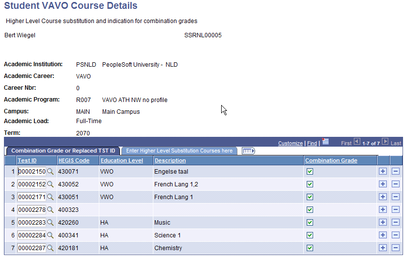

Access the Student VAVO Course Details page (Records and Enrollment, and then Test Administration NLD, and then VAVO Course per Student, and then Student VAVO Course Details).
This example illustrates the fields and controls on the Student VAVO Course Details page: Combination Grade or Replaced TST ID tab. You can find definitions for the fields and controls later on this page.
Student VAVO (Voortgezet Algemeen Volwassenen Onderwijs) Course Details page: Combination Grade or Replaced TST (test) ID tab
Field or Control Description
Test ID
Select a test ID for which you want to add a combination grade indication or a higher level substitution course.
Combination Grade
Select to indicate that the test ID should count towards an overall combination grade calculated result. If you select this check box, the Calculation process uses the combination grade test result and counts it towards the overall combination grade calculated result set up through the Test Catalog.
Education Level
Displays the course education level. Education level is set up for each HEGIS Code that is related to a course (Set up SACR , Foundation Tables, Reporting Codes, HEGIS Code Table).
Select the Enter Higher Level Substitution Courses here tab.
