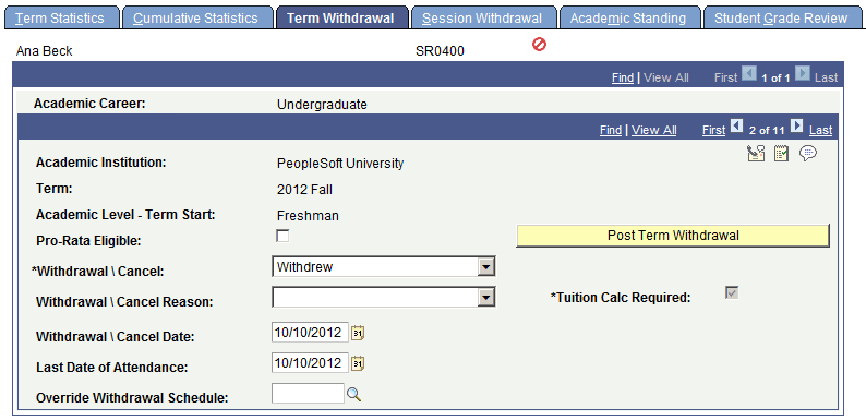

Posting Withdrawals and Cancellations for Terms
Access the Term Withdrawal page (Records and Enrollment, and then Student Term Information, and then Term History, and then Term Withdrawal).
This example illustrates the fields and controls on the Term Withdrawal page. You can find definitions for the fields and controls later on this page.
Important:
Posting a student's term cancellation request refunds 100 percent of the student's fees. Posting a student's term withdrawal request refunds her or his fees according to the adjustment calendar associated with the student's tuition group.
Documentation about some fields on this page is provided in the earlier topic: Common Elements Used to Process Withdrawals and Cancellations.
Field or Control Description
Academic Institution
The academic institution for which you want to process the student's withdrawal or cancellation request.
Term
The term for which you want to process the student's withdrawal or cancellation request.
Academic Level - Term Start
The student's academic level at the start of the specified term.
Pro-Rata Eligible
Select to enable pro-rata refunding—a refund to a student attending your academic institution for the first time and withdrawing on or before the 60 percent point in time. Clear this check box to not have the student considered for such a refund. Most U.S. academic institutions do not issue refunds after the 60 percent point in time.
Override Withdrawal Schedule
Select the override withdrawal schedule value. These values are specifically for refund calculations and are defined by Student Financials.
