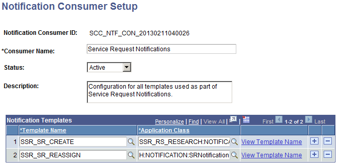

Using the Notifications Framework for Service Request Notifications
Use the Notifications framework to set up service request notifications so that when a service request is created or reassigned, the system automatically sends a notification to the administrator to whom the request has been assigned/reassigned.
The Notification Consumer ID: SCC_NTF_CON_20130211040026 Service Request Notifications is delivered:
This example illustrates the fields and controls on the Notification Consumer Setup page example for Service Requests. You can find definitions for the fields and controls later on this page.
Delivered settings for Service Request Notifications:
Notification Trigger Template Name Generic Template Application Classes Notes
Entry of a new Service Request by a student or administrator from the Service Request pages.
SSR_RS_CREATE
SSR_RS_CREATE
SSR_RS_RESEARCH:NOTIFICATION:SRCreateTemplateProvider
You must use the delivered template name. You can change the notification to use a different notification channel instead of email. If the Notification Type is set to Alert, a PeopleTools alert is generated in the Notifications region of a fluid homepage as well as a Notification Framework alert in the Notifications Center.
Use the sample generic template as an example for creating your own notification content. The sample template defines the available field variables that can be used in the notification message content.
Reassignment of an existing service request from the administrator Service Request pages.
SSR_RS_REASSIGN
SSR_RS_REASSIGN
SSR_RS_RESEARCH:NOTIFICATION:SRReassignTemplateProvider
See Notes in the row above.

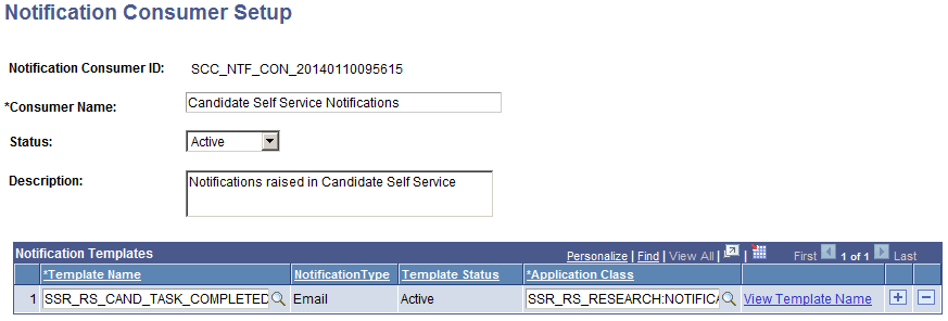

Using the Notifications Framework for Service Item Notifications
Use the Notifications framework to set up service item notifications so that when a service item is created from the Candidate Center, the system automatically sends a notification to a designated administrator.
The Notification Consumer ID: SCC_NTF_CON_20140110095615 Candidate Self Service Notifications is delivered:
This example illustrates the fields and controls on the Notification Consumer Setup page example for Service Items.
Delivered settings for Candidate Self Service Notifications:
Entry of a new Research Service Item from the Candidate Center by the student.
SSR_RS_CAND_TASK_COMPLETED
SSR_RS_RESEARCH:NOTIFICATION:RSTaskTemplateProvider
