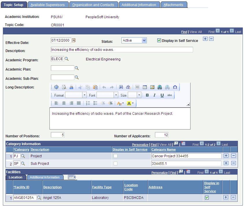

Defining Research Topics
Access the Research Topic Setup – Topic Setup page (Set Up SACR, and then Product Related, and then Student Records, and then Research Management, and then Research Topic Setup, and then Topic Setup).
This example illustrates the fields and controls on the Research Topic Setup page. You can find definitions for the fields and controls later on this page.
Field or Control Description
Display in Self Service
Select if you want the system to display this topic on the Search for Research Topics self-service page.
The Academic Program, Academic Plan, and Academic Sub-Plan fields on the Topic Setup page are used to control whether a topic is available to a research candidate. Because of the defined relationships between the fields, the page validates entries to prevent an invalid combination of values. A research topic can be defined as valid for:
  • An academic program only.
  • An academic program and academic plan combination.
  • An academic plan and academic sub-plan combination.
  • An academic program, academic plan, and academic sub-plan combination.
Academic Program
Select the academic program to which the research topic belongs.
Academic Plan and Academic Sub-Plan
Select the academic plan and sub-plan (if any) to which the research topic belongs.
Long Description
Enter a description of the research topic.
Number of Positions and Number of Applicants
Enter the total number of available positions and maximum number of applicants for the research topic. These fields are informational only.
Category Information
Category
The Category Code assigned to the topic. The Category value is optional.
This check box is display-only on the Topic Setup page.
Use the Display in Self Service check box on the Research Topic Category page to indicate whether category information should display on the Search for Research Topics self-service page.
See Defining Research Topic Categories
See Setting Up Self-Service Research Topic Search
Category Name
Use this optional field to provide additional information to identify the assigned category.
Facilities
Set up information about the location and facilities used for this research.
See:
If the Display check box is selected for FACILITY on the Fields Setup page, and you select this check box, data displays for the topic on the Search for Research Topics self-service page.

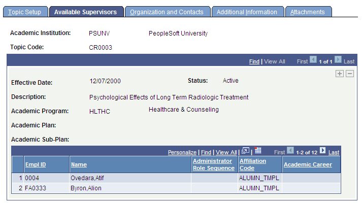

Reviewing Available Research Supervisors
Access the Research Topic Setup - Available Supervisors page (Set Up SACR, and then Product Related, and then Student Records, and then Research Management, and then Research Topic Setup, and then Available Supervisors).
This example illustrates the fields and controls on the Research Topic Setup - Available Supervisors page. You can find definitions for the fields and controls later on this page.
The Available Supervisors page is display-only.
See Setting Up Research Administrators

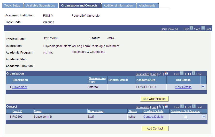

Associating Organizations and Contacts with Research Topics
Access the Research Topic Setup - Organizations and Contacts page (Set Up SACR, and then Product Related, and then Student Records, and then Research Management, and then Research Topic Setup, and then Organization and Contacts).
This example illustrates the fields and controls on the Research Topic Setup - Organizations and Contacts page . You can find definitions for the fields and controls later on this page.
Organization
You can associate external organizations or academic organizations with a research topic.
External organizations are defined in the Organization Table (Campus Community, Organization, Create/Maintain Organizations, Organization Table).
See Campus Community Fundamentals: Understanding Organizations.
Academic organizations are defined in the Academic Organization Table (Setup SACR, Foundation Tables, Academic Structure, Academic Organization Table).
See Campus Solutions Application Fundamentals: Defining Academic Organizations.
Description
Click this link to access the Organization Table (EXT_ORG_TABLE) page or the Academic Organization Table (ACADEMIC_ORG_TBL) page. The link is available only for users who are authorized to access the relevant component.
View Details
Click this link to access a display only page (External Organization Details page or Academic Organization Details page). This link allows users who do not have security access to the Organization Table or Academic Organization Table components to view the relevant organization data.
See Campus Solutions Application Fundamentals: Securing Academic Organizations
Add Organization
When you click the Add Organization button, you are taken to the Add Organization (SSR_RS_TPC_ORG) page:
Depending on the option that you select, the External Organization or Academic Organization field appears and you can select the organization with which to associate the research topic.
Contact
You can also associate contacts with a research topic. Contacts must have an EmplID in the system.
Contact Details
Click this link to access the Contact Details (SSR_RS_TPC_CNCT) page and view address, email, and phone details for the contact. The Demographic Data Usage settings determine the contact details to display.
If the Display check box is selected for CONTACT, CONTACTEMAIL and CONTACTPHNBR on the Fields Setup page and you select this check box, then the contact name, email and phone data displays for the topic on the Search for Research Topics self-service page.
Select this check box to indicate that candidates can view contact details in the Research Topic Search self-service page.
Add Contact
When you click the Add Contact button, you are taken to the Add Contact (SSR_RS_TPC_ADDCNCT) page:
ID
When you select an ID, the address, phone, and email details appear here based on the address, phone, and email types that have been set up on the Demographic Data Use page.
See Setting Up Demographic Data Usage
Active
Use the Active check box to indicate whether the contact is active or inactive.

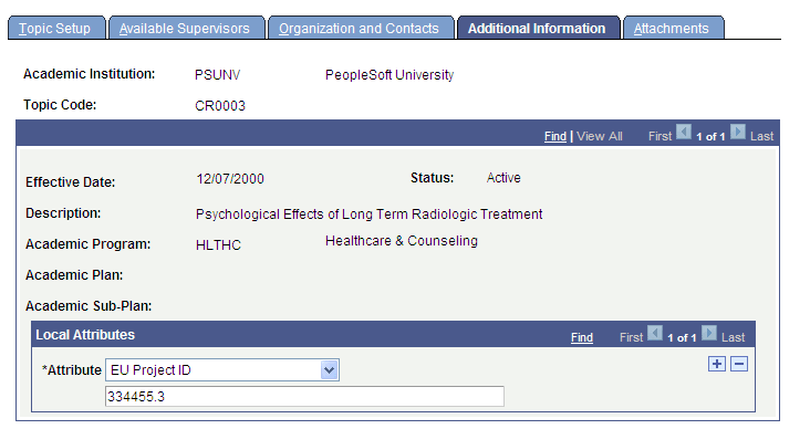

Entering Additional Information
Access the Research Topic Setup – Additional Information page (Set Up SACR, and then Product Related, and then Student Records, and then Research Management, and then Research Topic Setup, and then Additional Information).
This example illustrates the fields and controls on the Research Topic Setup – Additional Information page. You can find definitions for the fields and controls later on this page.
Use this page to enter and review Common Attribute fields associated with the research topic.
This page appears only if common attributes have been created for the research topic setup using the Common Attribute Framework.
See Using Common Attribute Framework for Research Tracking
See Campus Community Fundamentals: Defining a Common Attribute
Campus Community Fundamentals: Associating a Common Attribute to a Record
