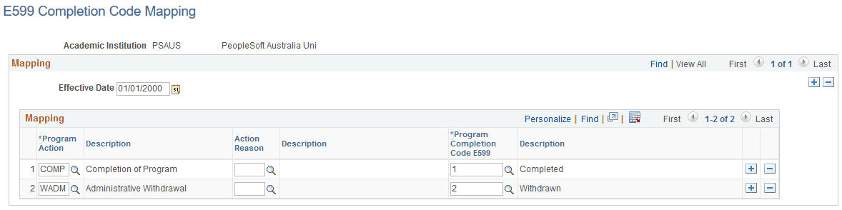

E599 Completion Code Mapping
SSR_HEIMS_PCC_MAP
Set Up SACR, and then Product Related, and then Student Records, and then Enrollment Reporting Codes, and then AUS Regulatory Report Setup, and then E599 Completion Code Mapping
Map program actions and action reasons to E599 program completion codes.

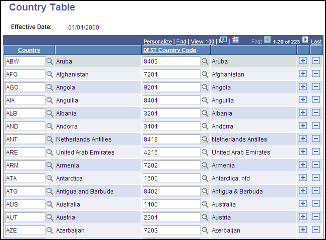

Mapping Country Codes to TCSI Country Codes
Access the Country Table page (Set Up SACR, and then Product Related, and then Student Records, and then Enrollment Reporting Codes, and then AUS Regulatory Report Setup, and then Country Table, and then Country Table).
This example illustrates the fields and controls on the Country Table page. You can find definitions for the fields and controls later on this page.
Country Table page
Set up TCSI country code values on the Country Code Table page.
Field or Control Description
Country
Select a PeopleSoft defined country code.
DEST Country Code
Enter the equivalent TCSI defined country code.

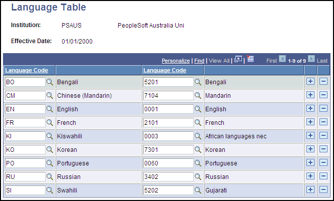

Mapping Language Codes to TCSI Language Codes
Access the Language Table page (Set Up SACR, and then Product Related, and then Student Records, and then Enrollment Reporting Codes, and then AUS Regulatory Report Setup, and then Language Table, and then Language Table).
This example illustrates the fields and controls on the Language Table page. You can find definitions for the fields and controls later on this page.
Language Table page
Set up TCSI language code values on the Language Code Table page.
Language Code (on left.)
Select a PeopleSoft defined language code.
Language Code (on right.)
Enter the equivalent TCSI language code.

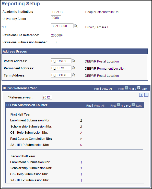

Setting Up TCSI Processing
Access the Reporting Setup page (Set Up SACR, and then Product Related, and then Student Records, and then Enrollment Reporting Codes, and then AUS Regulatory Report Setup, and then Reporting Setup, and then Reporting Setup).
For each new collection year, you must access this page and enter a new reference year row.
This example illustrates the fields and controls on the Reporting Setup page. You can find definitions for the fields and controls later on this page.
University Code
Enter your institution's TCSI university code.
This code is used in the file name for your submissions.
ID
Enter the ID for your institution's TCSI contact.
Address Usages
Postal Address
Select a value to determine the data for address elements 406, 407, 409, 466, 467, 468, 728.
Permanent Address
Select a value to determine the data for address elements 320, 410, 411, 413, 469, 470 and 471.
Term Address
Select a value to determine the data for address element 319.

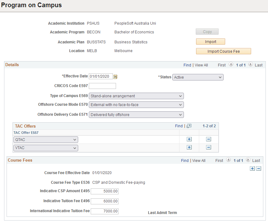

Setting Up Program on Campus
Access the Program on Campus page (Set Up SACR, and then Product Related, and then Student Records, and then Enrollment Reporting Codes, and then AUS Regulatory Report Setup, and then Program on Campus).
This example illustrates the fields and controls on the Program on Campus page. You can find definitions for the fields and controls later on this page.
Course fees can change over time. Use this page to make sure new course fees take effect based on a predetermined date. The first Course Fee record should have a Course Fee Effective From Date that matches the Effective Date of the parent Course on Campus record.
The main Program on Campus record is effective-dated in CS, but only a single "effective from date" record is reported as a TCSI Course on Campus, so you won't be able to add new effective-dated rows here.
Copy
Click to add a new Program on Campus record. This allows you to select an existing record of a similar program and copy its details. After copying, you can edit the data before saving.
You may need to correct the effective dates and ensure that the first Course Fee record has a Course Fee Effective Date that matches the Effective Date of the Course on Campus record.
Import
Click to import a complete Program on Campus record from a comma-separated file (CSV). The CSV file contains a header row and any number of comma-separated data rows. It should also include the first Course Fee record which is given the same effective date as the parent record.
Import is enabled when viewing an existing record.
Import Course Fee
Click to import new course fees for existing Program on Campus records (as they change over time).
Import Course Fee is enabled when viewing an existing record.
Course Fees
To change course fees over time, add a new row and specify a later date in Course Fee Effective From Date.

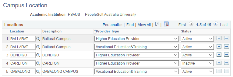

Identifying CS Locations for TCSI
Access the Campus Location page (Set Up SACR, and then Product Related, and then Student Records, and then Enrollment Reporting Codes, and then AUS Regulatory Report Setup, and then Campus Location).
This example illustrates the fields and controls on the Campus Location page.
Use this page to identify which locations should be considered a campus for TCSI, and associate a provider type. If a location is both a HEP and VET campus, you should have two entries.

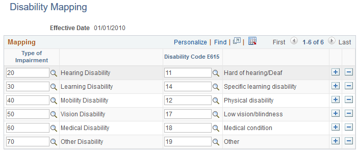

Map Types of Impairment With Disability Codes
Access the Disability Mapping page (Set Up SACR, and then Product Related, and then Student Records, and then Enrollment Reporting Codes, and then AUS Regulatory Report Setup, and then Disability Mapping).
This example illustrates the fields and controls on the Disability Mapping page.
Use this page to map the types of impairment with E615 disability codes.
The type of impairment should be unique for an effective date. You can map multiple types of impairment to a disability code.

Access the E599 Completion Code Mapping page (Set Up SACR, and then Product Related, and then Student Records, and then Enrollment Reporting Codes, and then AUS Regulatory Report Setup, and then E599 Completion Code Mapping).
This example illustrates the fields and controls on the E599 Completion Code Mapping page.
Use this page to map program actions and action reasons to a program completion code. You can map multiple program action and action reason to the same completion code.
