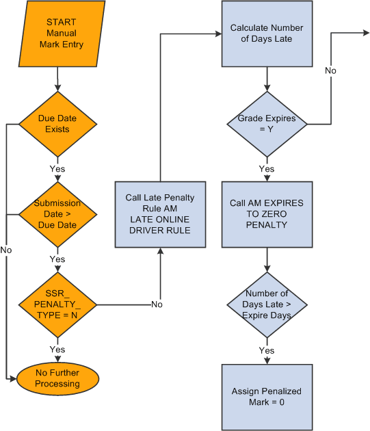

The existence of the Late Penalty Option Inclusion Record on any Assessment Item, along with a submission date that is later than a due date, triggers the Rules Engine to run the AM Late Penalty Online Driver Rule. The rule may call additional expert-level rules for additional calculation. The system then inserts a late penalty result into the student’s result record SSR_IAM_RESULT. Late penalty rows are used in the primary result type calculation. The late penalty inclusion data is setup on the following components: Activity Definition, Activity Registry, Activity Manager, and the Individual Activity Manager.

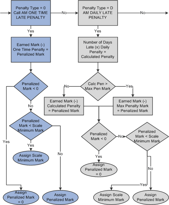

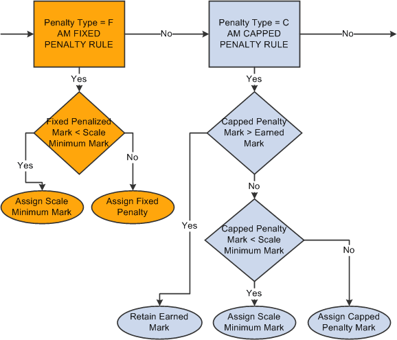

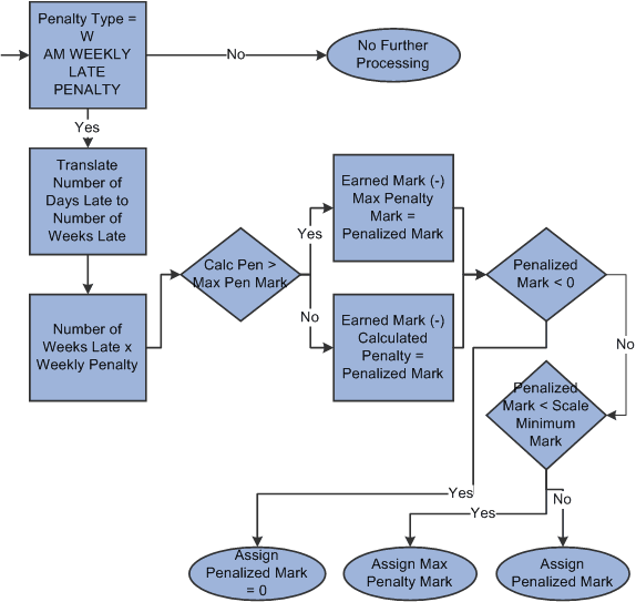

The late penalty options defined on the Activity Registry include penalizing based on number of days or weeks late with a minimum limit, or subtracting a one-time penalized mark. Users can indicate that a late mark should be capped or fixed at a specific mark. You can also choose to not calculate a penalty. All penalties allow for a mark to be set to 0.0 after a specified amount of time.
The following diagrams outline the processing that generates the late penalty calculations.
Diagram 1 of 4 illustrating late penalty processing:
Late Penalty Processing (1 of 4)
Diagram 2 of 4 illustrating late penalty processing:
Late Penalty Processing (2 of 4)
Diagram 3 of 4 illustrating late penalty processing:
Late Penalty Processing (3 of 4)
Diagram 4 of 4 illustrating late penalty processing:
Late Penalty Processing (4 of 4)
The calculated late penalty mark is inserted on a new result row with a result subtype of Late Pen. The row is updated with the following data:
