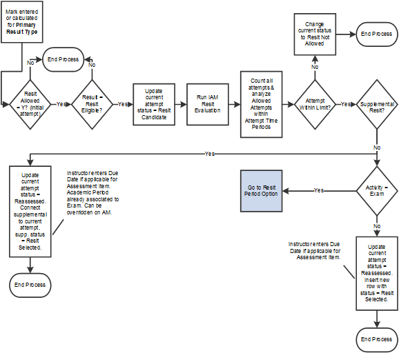

Result entered on the student IAM
This diagram outlines the resit eligibility evaluation process.

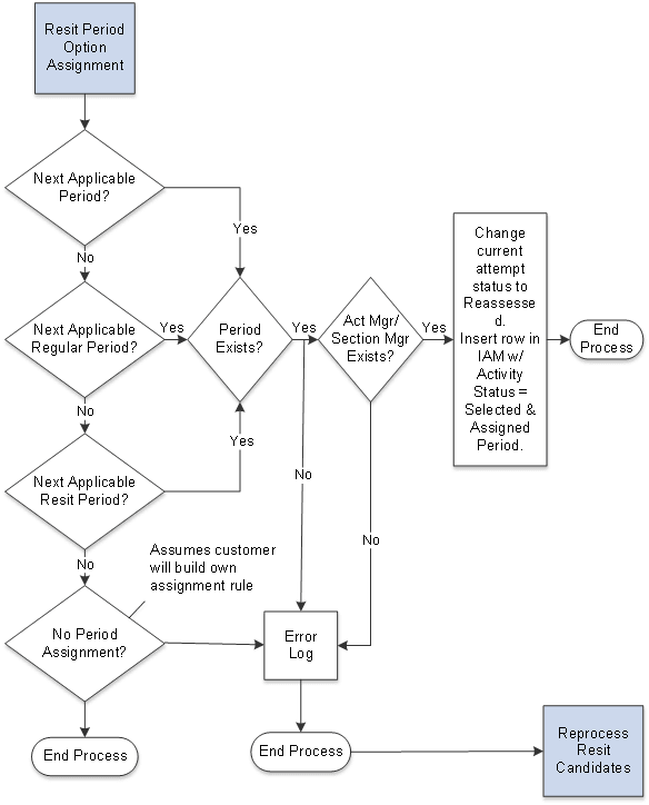

This diagram outlines the exam period assignment process.
