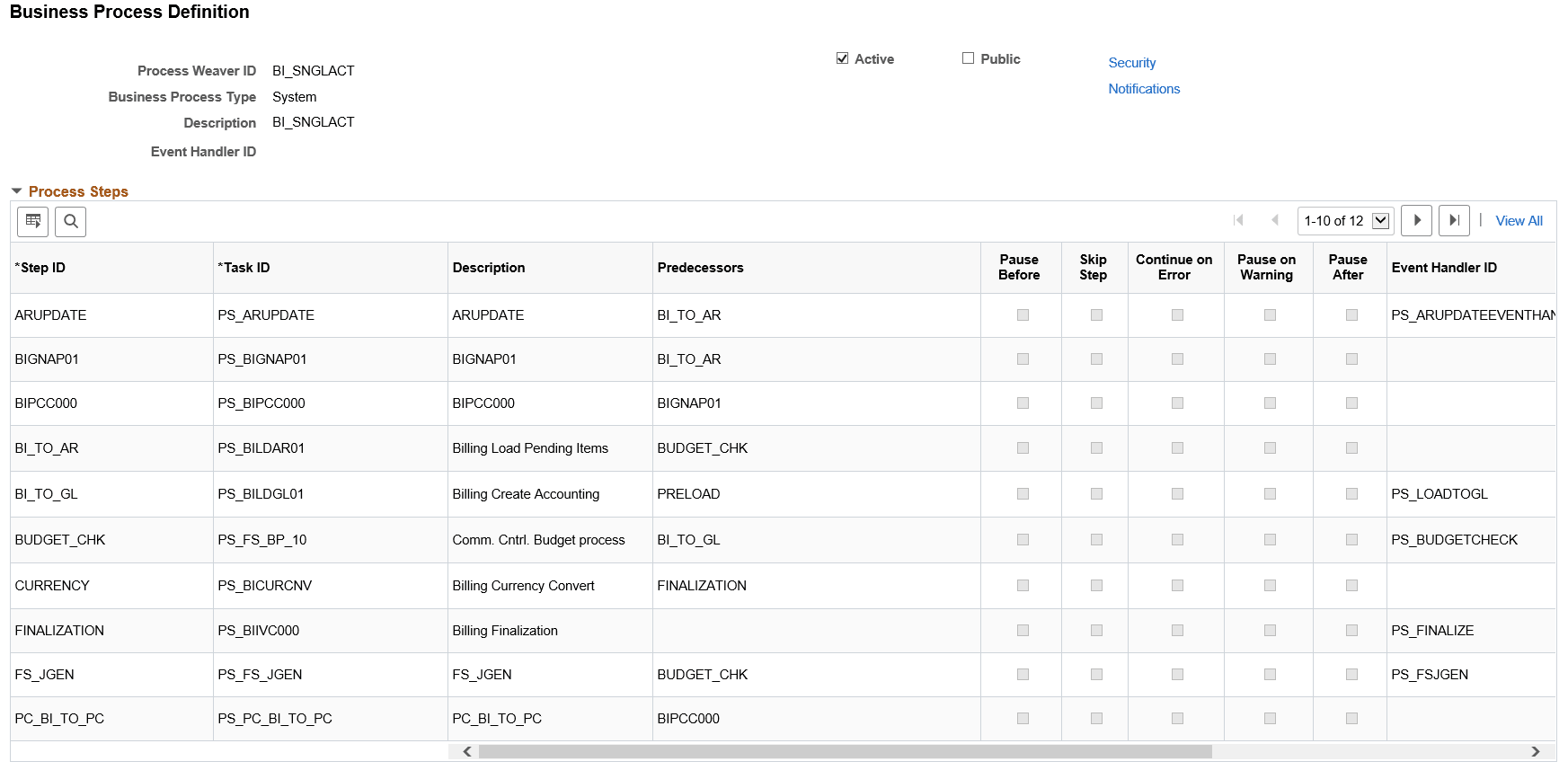

This example illustrates the fields and controls on the Business Process Definition page (1 of 2). You can find definitions for the fields and controls later on this page.
Business Process Definition page 1 of 2

Field or Control Description
Process Weaver ID
Identifies a unique business process within the same Business Process Type.
Select the type of the business process:
  • User Defined - Select this business process type for those business processes that you defined.
  • SYS (System) - Defined and delivered by PeopleSoft. The system business processes are display-only. These definitions cannot be changed.
Description
Provide a short description of the business process.
Event Handler ID and Event Handler Parameter
Select to attach an event handler and any parameter, at the process level, to the business process.
Active
Select to indicate whether the business definition is active. If not selected, you are unable to create run controls to run the business process.
Public
Select to allow all users to create a business process run control for this business process definition. When you select this option, the system disables the Security link.
Security
Click this link to identify users who are authorized to create a business process run control for the process definition.
To enable this link, deselect the Public check box.
Notifications
Click this link to access the Business Process Definition Notifications page, where you can set up notification criteria and delivery channel, including worklist, email, and push to the PeopleSoft Fluid User Interface Home page.
Copy from
Click this button to copy steps from a different business process definition.
Created Date/Time, By
Identifies the time and the user who created this business process definition.
Updated Date/Time, By
Identifies the time and the user who last updated this business process definition.
Process Steps
Use the Process Steps group box to define the steps in the business process.
Step ID
Identifies the process step. A unique ID, within the business process.
Task ID
Select the task to be executed in this step. The task must be set up in the Task Registry.
Description
Enter a short description of the step. If you do not enter a value, the field populates by default from the description of the task.
Predecessors
Displays the predecessor steps that must be executed before this step can be executed. To select the predecessors, click the Select Predecessors button, which launches the Select Step Predecessors page.
Select Predecessors
Select this button to launch the Select Step Predecessors page to select step predecessors.
Pause Before
Select to indicate that the process should pause before executing the step.
Skip Step
Select to indicate that the step should be skipped. Skip Step, Continue on Error and Pause After are mutually exclusive. If Skip Step is selected, then Continue on Error and Pause After are not available. If Continue on Error or Pause After is selected, then Skip Step is not available.
Continue on Error
Select this check box to indicate that the process should continue to the next steps even if an error occurred during the execution of this step.
Pause After
Select this check box to indicate that after this step completes, the process should not automatically continue to the next steps. Instead, the process should pause and wait for the user to resume the process.
Event Handler ID, Event Handler Parameter
Select to attach an event handler and any parameter to the step. If an event handler is associated with the task (set up in Task Registry), then it will be overridden.

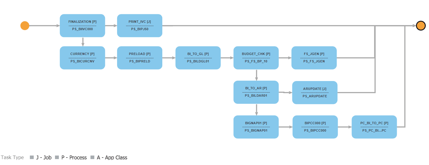

Graph
The Process graph shows the execution flow of the steps in the business process. Each node in the graph represents a step in the business process. The Step ID and Task ID are shown in the node. When you hover over the Step ID, the description of the step appears. If an icon is associated with the task, it appears in the top-left corner of the node.
The system automatically positions the nodes from left to right, top to bottom. However, with complex relationships between the steps, the layout may not be optimal. In this case, you can drag the nodes to rearrange them. The connection lines are automatically redrawn.
The width of the canvas that displays the graph is fixed. However, the height will automatically expand and shrink vertically (up to a certain height) as the user moves the node. The user can use the zoom buttons to zoom in or out.
These buttons enable users to manipulate the graph:
Zoom In and Zoom Out icons (Zoom In and Zoom Out)
Click the plus (zoom in) icon or the minus (zoom out) icon to adjust the size of the graph. These buttons are available for graphs that are larger than the viewing area.
When you reach the minimum zoom rate (0.5), the zoom out icon is not available. Adversely, when you reach the maximum zoom rate (2), the zoom in icon is not available.
Preview
In most cases, when the data is updated in the Process Steps group box, the graph will be redrawn automatically to show the updates. However, in the event this does not happen automatically (for example, when deleting a step), you can click the Preview button to update the graph.
Auto Layout
After you have moved the nodes to rearrange them, click the Auto Layout button if you want to restore the layout to the system version.
Revert to Saved
If you have saved the previously changed node layout, this button will be available to restore to the saved layout after changes.
