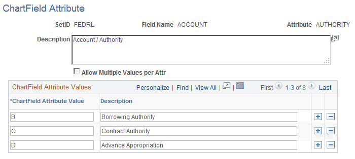

ChartField Attributes Page
Use the ChartField Attribute page (CF_ATTRIBUTES) to create ChartField attributes for use in intraunit consolidation eliminations, government reporting, and payment processing.
Navigation:
Set Up Financials/Supply Chain, and then Common Definitions, and then Design ChartFields, and then Configure, and then Define CF Attributes
This example illustrates the fields and controls on the ChartField Attribute page. You can find definitions for the fields and controls later on this page.
Generic ChartField attributes are optional features that support such things as intraunit consolidation eliminations and United States federal government requirements for reporting and payment processing.
After you attach an attribute value to a ChartField value, it cannot be deleted using the ChartField Attribute page. However, using the ChartField value attribute secondary page, you can delete any attribute and attribute value.
Attributes share the effective dating of the ChartField values to which they are attached. The Project ChartField does not have effective dating. Project ChartField attributes are automatically assigned a default effective date of 01/01/1900.
Create or delete attributes as required for the applicable ChartFields. However, once you attach an attribute to a ChartField value, it cannot be deleted.
Field or Control Description
Field Name
Enter any or all of the following applicable ChartFields for which attributes functionality is available:
  • ACCOUNT
  • ALTACCT
  • BUDGERT_REF
  • CLASS_FLD
  • FUND_CODE
  • PROGRAM_CODE
  • OPERATING_UNIT
  • DEPTID
  • PRODUCT
  • PROJECT_ID
  • CHARTFIELD1
  • CHARTFIELD2
  • CHARTFIELD3
The system uses the FS_CF_TEMPLATE to determine which ChartFields are active. Applicable active ChartFields appear in the drop-down list box for this field.
Attribute
A user-defined field in which you name the attribute.
Note: When using this field for Asset Management and federal fund transfers, ensure that the attribute name matches the value entered for the Federal Fund Attribute field on the Installation Options - Asset Management page.
Allow Multiple Values per Attr (Allow Multiple Values per Attribute)
Select this check box to allow multiple values of the same attribute to be attached to a ChartField value. If you do not select this check box, only one attribute value can be attached to a ChartField value.
Note: Multiple combinations are usually associated with accounts but this option is available to all applicable ChartFields.
ChartField Attribute Value
This is user defined. For example, you can distinguish between single and multiple-year reporting for a fund by creating these two values for an attribute—either of which you can then attach to a fund value to make this distinction.
Note: When using this field for Asset Management - federal fund transfers (FEDERAL FUND attribute), you will use a ‘Y’ (YES) value and a ‘N’ (NO) value to distinguish between Federal and Non-Federal funds, which you can then attach to a fund value to make this distinction.

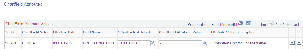

ChartField Attribute Values Page
Use the ChartField Attribute Values page (CF_ATTRIB_VALUES) to select user-defined values to support intraunit consolidations and Federal requirements for reporting and payment processing.
Navigation:
Click the Attributes link from the applicable ChartField Values page.
This example illustrates the fields and controls on the Chartfield Attributes Page. You can find definitions for the fields and controls later on this page.
Chartfield Attributes page
Use this page to select one or more of the ChartField attribute and attribute value combinations you have created for a particular applicable ChartField to be applied to the selected ChartField value.
When using this page for Asset Management - federal fund transfers, attach the Federal fund chartfield attribute you created on the ChartField Attribute page, and indicate ‘Y’ for a Federal fund or ‘N’ for a non-Federal fund using the ChartField Attribute Value field.

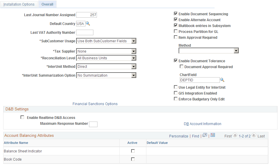

Setting Installation Options for Account Balancing Groups
Use the Installation Options - Overall page (INSTALLATION_FS1) to activate or inactivate the Book Code and Balance Sheet Indicator attributes.
Navigation:
Set Up Financials/Supply Chain, and then Install, and then Installation Options, and then Installation Options.
Click the Overall link on the Installation Options page.
This example illustrates the fields and controls on the Installation Options - Overall page. You can find definitions for the fields and controls later on this page.
Account Balancing Attributes
The following fields apply to the account balancing attributes.
Active
Select to include attribute names for your system.
Default Value
Populated by the system from the default account balancing group value.

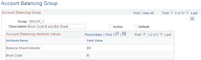

Account Balancing Group Page
Use the Account Balancing Group page (ACT_BAL_GRP) to define the combination of active account attribute values using book code values and the balance sheet indicator attributes.
Navigation:
Set Up Financials/Supply Chain, and then Common Definitions, and then Design ChartFields, and then Configure, and then Define Account Balancing Group
This example illustrates the fields and controls on the Account Balancing Group page. You can find definitions for the fields and controls later on this page.
Group
Use the Account Balancing Group page to select various combination or subsets of the attribute values and give them a unique group name and description.
Active
Select or deselect to make the Account Balance Group active or inactive.
The system is delivered with a default account balancing group that contains no account balancing attributes. If you activate any account balancing attribute on the Installation Options - Overall page, you must make the default account balancing group inactive. Then, you add a new account balancing group that contains the active account balancing attributes.
Default
Select to display the attribute values as defaults on the Installation Options - Overall page.
Attribute Name
Balance Sheet Indicator values are delivered by PeopleSoft; however, you can define Book Code values by using the Book Code page.
For the group, select the field value for the attributes on this page.

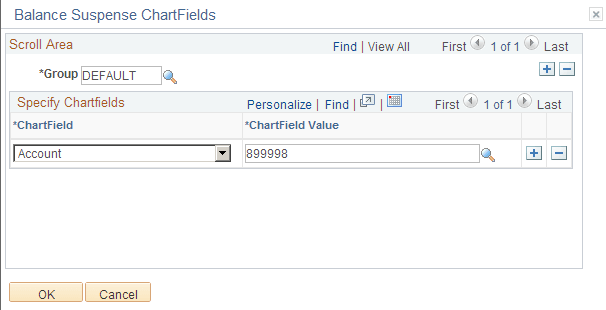

Balance Suspense ChartFields Page
Use the Balance Suspense ChartFields page (SRC_JE_BS_CFS_SEC) to used to select balancing suspense ChartFields for journal processing.
Navigation:
Set Up Financials/Supply Chain, and then Common Definitions, and then Journals, and then Source, and then Journal Options. Click the Balance Suspense ChartFields link
This example illustrates the fields and controls on the Balance Suspense ChartFields page. You can find definitions for the fields and controls later on this page.
Group
Select one or more account balancing groups and balance suspense ChartFields and ChartField values to be used in the journal balance suspense process.
If you do not have an account balancing attribute active, you will have one account balancing group only. This is the default group that is delivered with the system. You only need to define one balance suspense ChartField for the default group.
However, if you have one or more account balancing attributes active, you inactivate the default group and add your own account balancing groups on the Account Balancing Groups page, which contain various combinations of active account balancing attribute values. Then, you must define one balance suspense ChartField for each group. The account value of the balance suspense ChartFields must have the same account balancing attribute values as the account balancing group.
For example, assume you activate the balance sheet indicator. You then inactivate the default group and add two new account balancing groups. One for balance sheet group and the other for off balance sheet group. You must then define two balance suspense ChartFields, one for each group. The account value for balance sheet group must have a balance sheet indicator value equal to balance sheet. Similarly, the account value for the off balance sheet group must have a balance sheet indicator value equal to off balance sheet.
Account balancing groups identify balancing subsets within the same ledger that involve simultaneous use of the book code and balance sheet indicator. You must define for each group, or subset, its own balancing or suspense accounts to be used by various processes to maintain the balance within the group.
For example, each of the following requires a suspense or balancing ChartField for each applicable account balancing group:
  • Balance suspense ChartFields.
  • Edit suspense ChartFields.
  • Amount suspense ChartFields.
  • Rounding adjustment ChartFields.
  • Position accounting.
