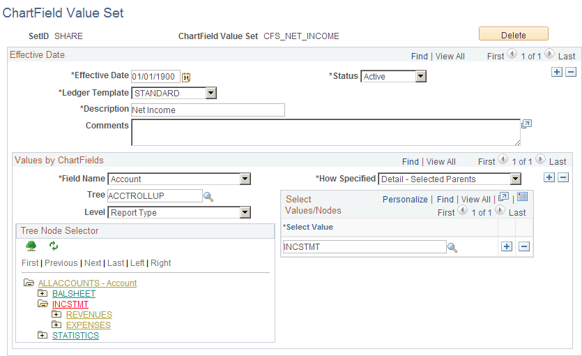

This example illustrates the fields and controls on the ChartField Value Set page. You can find definitions for the fields and controls later on this page.

In the Values by ChartFields group box, identify the values to be included in this value set.
Field or Control Description
Field Name
Available ChartFields are based on the ledger template that you entered. Select the ChartField that you want to include in this value set.
How Specified
Values are:
  • Selected Detail Values if you want to select individual ChartField values to include in the set.
  • Detail-Selected Parents if you want to select values based on tree nodes. This option activates a Tree edit box where you can specify a tree from which to select nodes. This option also activates an optional Level edit box (if you select a tree that uses levels) enabling you to limit prompting to selected levels.
  • Range of Values to enter a value from and a value To.
Select Values/Nodes
The system prompts you to enter accounts or tree nodes depending on the How Specified option that you selected. Click the Add button to add each account or node value.
Tree View icon
Click the Tree View button to access the tree referenced when using Selected Parents in How Specified.
Add ChartFields icon
To the right of the How Specified field, click the Add button to add additional ChartFields to the value set; then complete the fields to select values to include for the ChartField as described.
