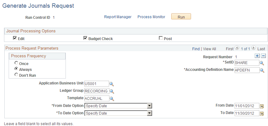

Generate Journals Request Page
Use the Generate Journals Request page (JRNL_GEN_REQUEST) to initiate Journal Generator processing.
Navigation:
General Ledger, and then Journals, and then Subsystem Journals, and then Generate Jrnl From Subsystem
This example illustrates the fields and controls on the Generate Journals Request page. You can find definitions for the fields and controls later on this page.
Journal Processing Options Group Box
Field or Control Description
Edit
Select this check box to run the Journal Edit process. No prerequisites are required.
Budget Check
Select this check box to run the Budget Check process. You must run the Journal Edit process before running this budget check.
Post
Select this check box to run the Post process. You must run edit and budget check before posting.
If you select none of these check boxes, no additional processes are run.
Process Request Parameters
Request Number
To identify the process request, the system assigns this unique number to each run. You can create multiple requests. Use the scroll arrows to view requests already set up for the current user ID and run control ID.
SetID
This is required to extract the accounting entry definition for the request.
Accounting Definition Name
Identify which accounting entry definition the system should use when it creates the journal header and lines.
Application Business Unit
Journal Generator:
  • Extracts accounting entries for the request according to the option that you select.
  • Creates journal entries for one or all application business units.
The application business unit can be other than the general ledger business unit.
The prompt for this field depends on the system source of the accounting definition name. For example, if the system source of the accounting definition is JrnlGen-AP, Journal Generator uses the Payables business unit table. If the system source is JGen-Other, no prompt table is available.
Ledger Group
Journal Generator creates journal entries for the specified General Ledger ledger group.
Template
Journal Generator creates journal entries for the specified journal generator template. The SetID of the prompt values is derived from the SetID entered earlier on the page.
From Date Option
Select a value to further define which accounting entries Journal Generator extracts with this request. Journal Generator compares these dates to the accounting dates associated with each accounting entry. Select from the following values:
Specify Date: Uses the date specified to identify the period.
Current Date: Uses the date on which Journal Generator is run.
Begin Date - From Period: Uses the beginning date of the from period in the ledger.
Begin Date - To Period: Uses the beginning date of the to period in the ledger.
No From Date: Uses all open dates of the ledger before the chosen to date. This means that the system processes all dates up to the date in the To Date field.
Process Date: Date specified on the business unit journal process date option. It can be a specified date defined on the business unit, or it can be the current date.
From Date
Enter a to date if Specify Date is selected in the From Date Option field.
To Date Option
End Date - From Period: Uses the ending date of the from period in the ledger.
End Date - To Period: Uses the ending date of the to period in the ledger.
To Date
Enter a to date if Specify Date is selected in the To Date Option field.
The application business unit and general ledger business unit that exist in the Accounting Entry table can differ. One business unit must be designated to derive the SetIDs for the control records during the batch processing. The control records are ledger group and ledger definition tables, calendar tables, journal source table, and journal generator template table. The general ledger business unit is the business unit to derive the SetIDs for these control records. In one particular request, whether all or one business unit is selected, Journal Generator might have multiple general ledger business units to process and cannot determine the associated SetID at the point at which the request is defined. Therefore, the prompt SetID that you see in the Ledger Group field and Journal Generator template may not necessarily be the same as the SetIDs used by the batch programs.
