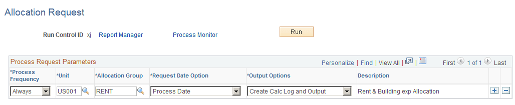

This example illustrates the fields and controls on the Allocation Request page. You can find definitions for the fields and controls later on this page.

Field or Control Description
Unit
Specify the business unit for the PeopleSoft Allocations process. For non-interunit steps, this business unit also determines the business unit value for the pool and basis rows that are selected. For interunit steps, use any one of the business units that are defined in the pool when requesting interunit allocations.
Allocation Group
Identify the allocation group to be processed in this request.
Request Date Option
Select the As of Date value in the Request Date Option field, and two additional As of Date fields become available. The as of date moves by default to the current system date; however, you can change the date for individual lines by using the As of Date field on each line or for all lines using the As of Date field for the request.
You can define individual steps in an allocation group using relative time spans, such as PER (Current Period Activity). A relative time span retrieves ledger amounts relative to the Request Date Option that you specify. The request date options are:
  • Process Date: Uses journals dated before the run date.
  • SYSDATE: Uses journals dated before the system date for your computer.
  • As of Date: Uses journals dated before the date that you specify in the As of Date field that appears for the line when you select this option.
Update As of Date icon
Click the Update As of Date button to change the as of date for all lines in the run requests to the current date or the date that you specify.
Output Options
Select one of the following options:
  • Create Calc Log - No Output (create calculation log - no output): Serves as a dry run by creating a calculation log but no journals and ledger entries.
  • Create Calc Log and Output (create calculation log and output): Creates a calculation log and generates journals and ledger entries.
  • No Calc Log - Create Output (no calculation log - create output): Creates journals and ledger entries, but no calculation log. This is the system default value.
Calculation logs are cleared using SQL scripts.
Start Step
When errors occur and processing aborts, you can restart processing at the step that failed by selecting Start Step. This option appears only if an error occurred during processing.
