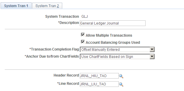

Use the System Transaction Page 1 page (IU_SYS_TRAN) for customizing interunit and intraunit transactions. Do not make changes to this page unless you are customizing this process.
Any change you make to this page is a customization of the system. Access to this page is for information only or in the rare event that you intend to implement a customization to your system. System Transactions are predefined and delivered with the system for transactions that can generate inter and intraunit entries
Navigation:
Set Up Financials/Supply Chain, and then Common Definitions, and then Inter/Intra Unit, and then System Transaction Definition, and then System Transaction Page 1
This example illustrates the fields and controls on the System Transaction Page 1. You can find definitions for the fields and controls later on this page.
Do not make changes to any of the system transactions pages unless you intend to implement a customization.
Field or Control Description
Allow Multiple Transactions
As delivered, this check box is selected for and is applicable only to General Ledger. It enables you to define additional Transaction Codes and associate or map them to the delivered System Transaction for the General Ledger product.
Account Balancing Groups Used
As delivered, this check box is selected for and is applicable only to General Ledger. It indicates to the processor that the accounting entries on the input record could include accounts with attributes other than the default values.
Transaction Completion Flag
This option determines how the processor calculates the base currency amounts on the interunit balancing entries for the anchor business unit when the corresponding nonanchor business unit has a different base currency.
If the option is set to Offset Manually Entered, then the processor calculates the base currency amount by converting the foreign currency amount using the exchange rate retrieved from the market rates table.
If the option is set to Offset System Generated, the processor assumes that the original entries were functionally balanced. It then calculates the base currency amount for the balancing entries for the anchor unit using an allocation of the total base currency amounts on all of the original entries for the anchor unit.
Anchor Due To/Due From ChartFields
There are three possible values:
  1. Use ChartFields Based on Signmeans that the balancing entry with the positive sign is booked to the receivable entry type and the balancing entry with the negative sign is booked to the payable entry type.
  2. Use Payable ChartFieldsmeans that the balancing entry for the anchor entity is booked to the payable entry type and the balancing entry for the nonanchor entity is booked to the receivable entry type, regardless of the sign of the entry.
  3. Use Receivable ChartFieldmeans that the balancing entry for the anchor entity is booked to the receivable entry type and the balancing entry for the non anchor entity is booked to the payable entry type, regardless of the sign of the entry.
Header Record and Line Record
The names are for prompting only. The actual record and line names are passed to the inter and intraunit processor at run time.

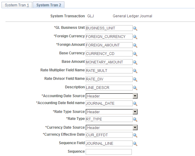

Use the System Transaction Page 2 page (IU_SYS_TRAN2) to make customizations to interunit and intraunit transaction processing. Do not make changes to this page.
Navigation:
Set Up Financials/Supply Chain, and then Common Definitions, and then Inter/Intra Unit, and then System Transaction Definition, and then System Transaction Page 2
This example illustrates the fields and controls on the System Transaction Page 2 (1 of 4). You can find definitions for the fields and controls later on this page.
Sequence Field
Name of the field on the line record that must be incremented for the new balancing entries created by the processor, if applicable.
Sequence
Leave this field blank if the Sequence Field is blank, or if you want the processor to continue numbering based on the last sequence number used on the original input entries for each document group. Specify a value if you want the inter and intraunit balancing entries to always begin sequencing with a fixed value.
Sequence numbers assigned by the processor are typically consecutive. However, for multibook ledger group lines, it is normal to have gaps in the sequence numbers.

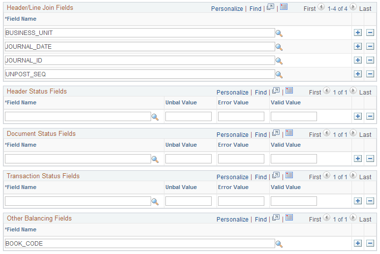

This example illustrates the fields and controls on the System Transaction Page 2 (3 of 4). You can find definitions for the fields and controls later on this page.
Header/Line Join Fields
If the System Transaction utilizes the optional header record, list the fields that are used to link the header record with its corresponding line record.
Header Status Fields
The field or fields on the header record that carry a status value for the document. You can specify different status values for Valid, Error (for example, setup related errors) or Unbalanced (non-setup related out of balance errors). The Valid value is optional, and the processor performs more efficiently if this value is set in the calling application.
Document Status Fields
The field or fields on the line record that carry a status value for the document. You can specify different status values for Valid, Error (for example, setup related errors) or Unbalanced (non-setup related out of balance errors). All of the accounting entry lines for the document, both the original entries and any balancing entries generated by the processor, are updated with the same status value. The Valid value is optional, and the processor performs more efficiently if this value is set in the calling application.
Transaction Status Fields
The field or fields on the line record that carry a status value for the transaction group within a document. You can specify different status values for Valid, Error (such as setup related errors) or Unbalanced (non-setup related out of balance errors).
All of the accounting entry lines for the transaction group, both the original entries and any balancing entries generated by the processor, is updated with the same status value.
Other Balancing Fields
Additional balancing fields can be specified; however the processor performs more efficiently if these values are set in the calling application.

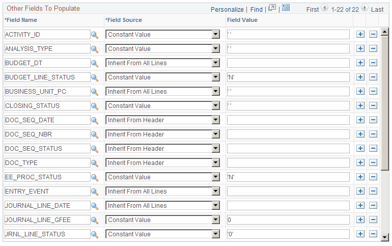

This example illustrates the fields and controls on the System Transaction Page 2 (4 of 4). You can find definitions for the fields and controls later on this page.
Other Fields to Populate
List other fields on the line record that are not defined elsewhere on this page, and specify how they are to be formatted on the new inter and intraunit balancing entries created by the processor.
Field Name
The name of the field to be populated.
Fields that are not be listed here include any field that is specified elsewhere on the System Transaction, including:
  • GL (general ledger) Business Unit
  • Foreign Currency and Amount
  • Base Currency and Amount
  • Description
  • Accounting Date
  • Rate Type
  • Rate Multiplier and Divisor
  • Sequence Field
  • InterUnit Balancing Line ID
  • Document Locking Field
  • Document Grouping Fields
  • Transaction Grouping Fields
  • Status Fields (both Document and Transaction)
  • ChartFields (those on standard subrecord, plus DeptID and Project ID)
    Note: Project ID is included in the PCADJ system transaction which is a valid exception.
  • Process Instance
  • Ledger Group
  • Ledger
  • IU Anchor Flag
  • IU System Transaction
  • IU Transaction Code
Currency Effective Date can be specified in the Other Fields to Populate definition as long as it is not the same field as the Accounting Date.
Field Source
Specify how the field is to be populated. Valid values include:
  • Constant Value - use the value entered in the Field Value field on this page.
  • Date Stamp - use the current system date.
  • DateTime Stamp - use the current system date and time.
  • Inherit from All Lines - when writing the anchor balancing entry use the value from the original anchor entry and when writing the nonanchor balancing entry, use the value from the original nonanchor entry.
  • Inherit from Header - when writing either the anchor or nonanchor balancing entry use the value from the corresponding header record.
  • Inherit from Non-anchor - when writing either the anchor or nonanchor balancing entry use the value from the original nonanchor entry.
Field Value
When the Field Source is Constant Value, specify the value to be populated in the Field.
