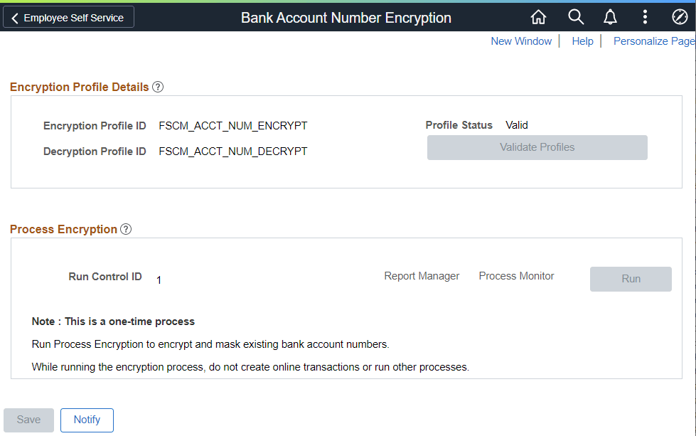

Bank Account Number Encryption Page
Use the Bank Account Number Encryption page (CRYPTPRFL_CONF) to encrypt and mask bank account numbers in existing FSCM tables. This is a one-time process.
Navigation:
Setup Financials/Supply Chain, and then Common Definitions, and then Encryption Configuration, and then Bank Account Number Encryption
This example illustrates the fields and controls on the Bank Account Number Encryption page after the FSCM_CRYPTAE process has run.
When running this process, make sure that other processes are not running as this process updates many FSCM tables and data could be compromised.
When running this process for the first (and only) time:
  1. Select the delivered encryption and decryption profile ID's.
  2. Select the Validate Profiles button.
    This step confirms and validates the algorithm keysets for both profiles. If the Profile Status changes to Valid, the Run button appears. If the Profile Status does not change to Valid, check the algorithm keysets for both Profile ID's.
  3. Select the Run button to run the FSCM_CRYPTAE process, which encrypts and masks bank account numbers and IBAN ID's in existing FSCM tables.

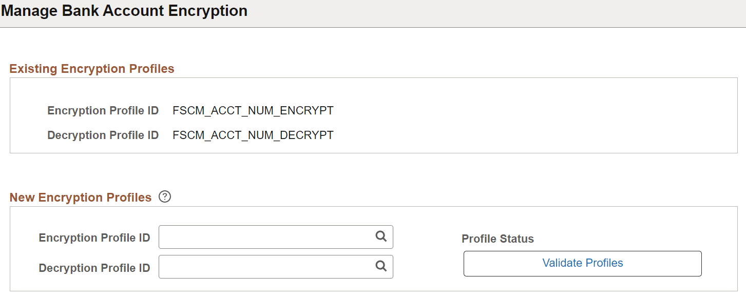

Manage Bank Account Encryption Page
Use the Manage Bank Account Encryption page to re-encrypt the bank account numbers stored in the database with a new profile ID.
Navigation:
Setup Financials/Supply Chain, and then Common Definitions, and then Encryption Configuration, and then Manage Bank Account Encryption
This example illustrates the fields and controls on the Manage Bank Account Encryption page
The Manage Bank Account Encryption page is editable only when the existing Bank Account Encryption process is run.
The existing encryption and decryption profile ID's are populated automatically. Enter the new encryption and decryption profile ID's. Validate the profiles and run the process similar to the Bank Account Number Encryption page.
When running this process, make sure that other processes are not running as this process updates many tables and data could be compromised.
