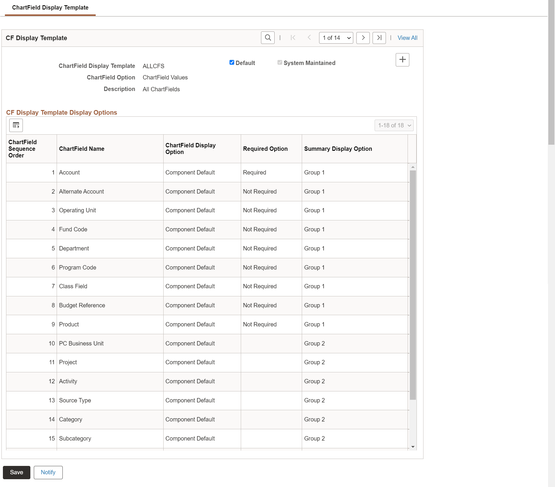

ChartField Display Template Page
Use the ChartField Display Template page (CF_DSP_TEMPLATE) to set up ChartField display options.
Navigation:
Setup Financials/Supply Chain, and then Common Definitions, and then Design ChartFields, and then ChartField Display Templates, and then Define CF Display Templates
This example illustrates the fields and controls on the ChartField Display Template page.
Field or Control Description
Enter the name of the ChartField display template.
Default
Select this check box to indicate that this ChartField display template is the default template. Only one default is allowed and one must be set as the default.
This page cannot be saved until a default is selected.
System Maintained
Displays as selected for templates that are delivered by PeopleSoft. These templates cannot be edited.
ChartField Option
Select an option that indicates which field to display on PeopleSoft Fluid transaction pages. Options include:
  • Both Value and Description: Select to indicate that the system displays the ChartField values and the corresponding ChartField descriptions on PeopleSoft Fluid transaction pages.
  • ChartField Values: Select to indicate that the system displays only ChartField values on PeopleSoft Fluid transaction pages.
  • ChartField Descriptions: Select to indicate that the system displays only ChartField descriptions on PeopleSoft Fluid transaction pages.
Copy from Template
Select a ChartField Display template from which to copy.
Order
Displays the order from ChartField configuration.
ChartField Display Option
Select an option to control the display the ChartFields on PeopleSoft Fluid pages. Options include:
  • Component Default: Select to indicate that the system should use the transaction logic to determine how to display the ChartFields, which could present the field as editable, non-editable, or hidden.
  • Display ChartField: Select to indicate that the system should show the ChartField as a non–editable field.
  • Hide ChartField: Select to indicated that the system should hide the ChartField.
Required Option
Select an option that indicates whether the ChartField is required. Options are:
  • Not Required: Select to indicate that the transaction logic determines whether the ChartField is required.
  • Required: Select to indicate that the ChartField is required and that the user must enter a value, if the field is editable on the transaction page.
This option is only available when Component Default is selected in the ChartField Display Option field.
This option is not available for Project Costing business unit, Project, Activity, Source Type, Category, or SubCategory because these fields are controlled at the Project Costing business unit options level.
Summary Display Option
Select an option for the ChartField to display on the Account Summary grid. This option is used because some PeopleSoft Fluid pages display accounting information in summarized form.
Options include:
  • Exclude: Select to indicate that the ChartField should not be displayed on the Account Summary grid.
  • Group 1: Select to indicate that ChartFields are displayed in the first group on the Accounting Summary grid, such as General Ledger ChartFields.
  • Group 2: Select to indicate that ChartFields are displayed in the second group on the Accounting Summary grid, such as Project Costing ChartFields.
Add a new row
(Add a new row)
Click this icon to create new template with more user defined chartfields. User can create multiple templates and hide or unhide the chartfields according to the requirement.

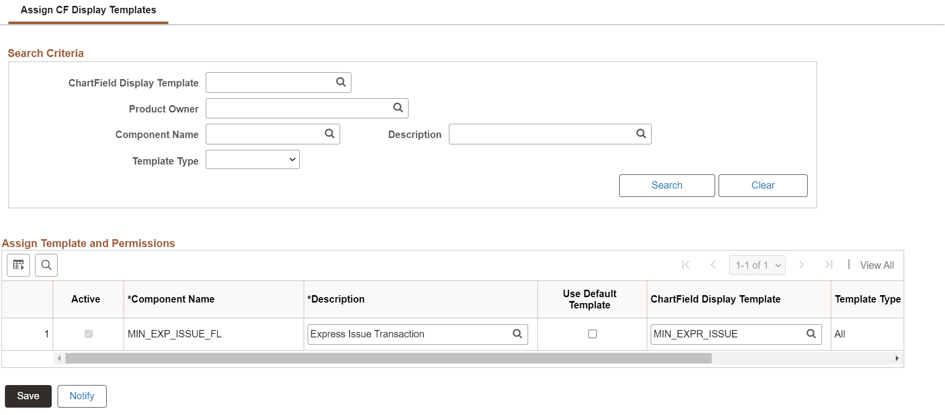

Assign CF Display Templates Page
Use the Assign CF Display Templates page (CF_DSP_COMPONENTS) to determine the ChartField display template that the system should use for the designated component for all users, a permission list, or user ID.
Navigation:
Setup Financials/Supply Chain, and then Common Definitions, and then Design ChartFields, and then ChartField Display Templates, and then Assign CF Display Templates
This example illustrates the fields and controls on the Assign CF Display Templates page.
Search Criteria/Default Values
Use this section to search for assigned templates. All fields are optional. If you select a template type of Permission or User ID, the system displays a field where you can enter a specific permission list or user ID.
CF Display Template Type Assignment
Active
Select this check box to indicate that the ChartField display template is active for the component and can be used by the PeopleSoft Fluid User Interface.
Component Name
Select a PeopleSoft Fluid component name that you would like to assign a ChartField display template.
The component names that available for selection are PeopleSoft Fluid components that support the ChartField Display Template framework. Component name options will be expanded as they are delivered.
Use Default Template
Select this check box to assign the default template.
Select a ChartField display template, which is defined on the ChartField Display Template Page.
If the Use Default Template check box is deselected, then this field must be populated by the user.
Template Type
Options are:
  • All: Select to indicate that this ChartField display template is to be applied to all users.
  • Permission: Select to indicate that this ChartField display template is to be applied to a specific permission list.
  • User ID: Select to indicate that this ChartField display template is to be applied to a specific User ID.
A specific User ID overrides a permission list and a permission list overrides All.
Permission List
Select a permission list for the ChartField display template. This field is only required when Permission is selected in the Template Type field.
User ID
Select a permission list for the ChartField display template. This field is only required when User ID is selected in the Template Type field.
System Maintained
Displays as selected if the assignment is maintained by the system. This cannot be changed.
User can assign multiple templates. In the Template Type, instead of Permission, Users can be added. The system verifies the user and whatever templates are assigned to that user, the chartfields will be displayed on the Express Issue page. If no rows are added with the user id then system checks the permission list and finds the template, and whatever chartfields are activated, those fields are displayed in the Chartfield override. If, permission list and user ids are not added, then the system will display the default chartfields.

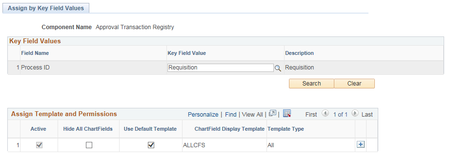

Assign by Key Field Values page
Use the Assign by Key Field Values page ( CF_DSP_PROD_GEN) to assign ChartField display template based on the Process ID.
Navigation:
Setup Financials/Supply Chain, and then Common Definitions, and then Design ChartFields, and then ChartField Display Templates, and then Assign by Key Field Values
This example illustrates the fields and controls on the Assign by Key Field Values page. You can find definitions for the fields and controls later on this page.
