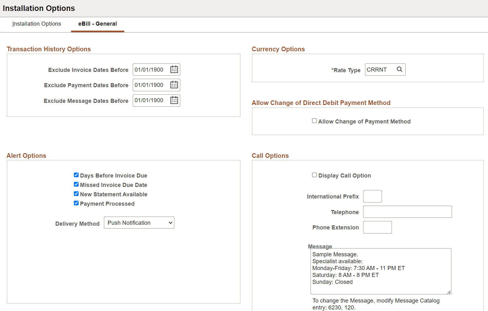

eBill – General Page
Use the eBill - General page to configure installation-level options that apply to all Fluid eBill users.
The installation options here appear in the classic interface and apply to only Fluid eBill Payment.

This example illustrates the fields and controls on the Installation Options, eBill – General page. You can find definitions for the fields and controls later on this page.
Installation Options, eBill - General page
Transaction History Options
Use fields in the Transaction History Options region to filter the transaction dates available to users. Selections here limit transaction history to increase performance and reduce search results. Users can further filter the transactions shown using filters on specific pages, including Invoices, Payment History, and the Message Center.
Field or Control Description
Exclude Invoice Dates Before
Enter a date to show eBill users only invoices with an invoice date greater than or equal to the specified date.
Excluded invoices are not included in customer balances.
Exclude Payment Dates Before
Enter a date to show eBill users only payments with a payment date greater than or equal to the specified date.
Exclude Message Dates Before
Enter a date to show users only messages with a message date greater than or equal to the specified date.
Currency Options
Rate Type
Enter the rate type used to convert invoice balances into the customer’s default currency or the user’s preferred currency.
Allow Change of Direct Debit Payment Method
Allow Change of Payment Method
Select this check box to allow the selection of direct debit invoices on the PeopleSoft eBill Payment: Invoice Balances Page (LFF) and PeopleSoft eBill Payment: Balance Detail Page, and change the payment method while making the payment.
Alert Options
Use these options to enable different types of alerts for eBill users. Users can choose from the enabled alerts on the My Preferences page. If alert options are not set up for eBill, the Alerts section will not appear on the My Preferences page.
Days Before Invoice Due
Select to enable alerts that invoices are due in a specified number of days.
Missed Invoice Due Date
Select to enable alerts for late payments.
New Statement Available
Select to enable alerts that new statements are available.
Payment Processed
Select to enable alerts that payments have been successfully processed.
Default Delivery Method
Select from these options:
  • Email - Users receive one email containing an alert for each event or transaction.
  • Push Notification - This is the default setting. Users receive one alert for each event or transaction.
The alerts process must be run on a regular basis.
Call Options
Display Call Option
Select to display the Call option on the Contact Us page. This option is deselected by default.
Enter the phone number including an international prefix, phone number, and extension, if applicable.
Message
If Display Call Option is enabled, the eBill Payment user sees a message above the phone number on the Call page, which is accessed through the Contact Us tile. The sample message shown is delivered in the message catalog entry indicated and may be modified as desired.

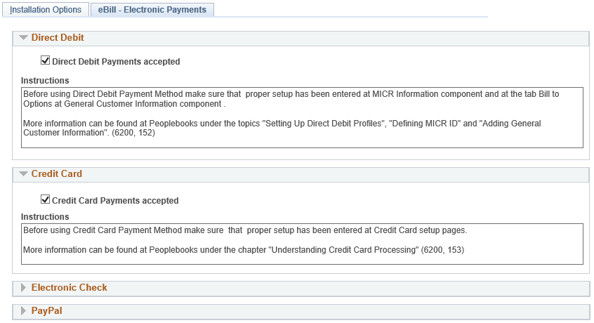

eBill – Electronic Payments Page
Use the eBill - Electronic Payments page to enable direct debit, credit card, electronic check, and PayPal payment methods in eBill Payment.
The installation options on the eBill – Electronic Payments page appear in the classic interface and apply to both Classic and Fluid eBill Payment.

This example illustrates the fields and controls on the Installation Options, eBill - Electronic Payments page (1 of 2), where direct debit and credit card payment methods are enabled. You can find definitions for the fields and controls later on this page.

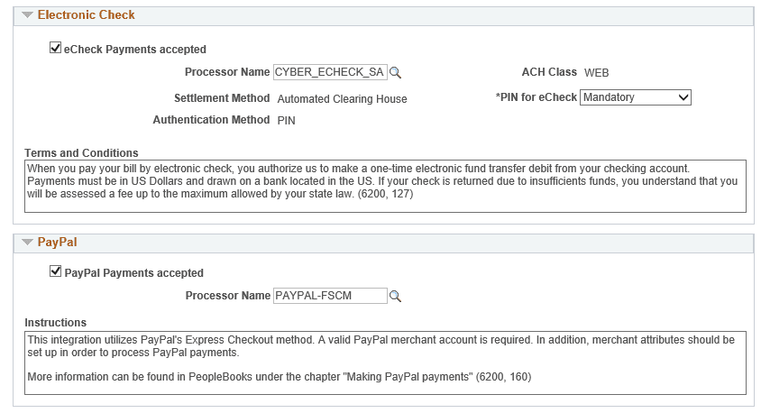

This example illustrates the fields and controls on the Installation Options, eBill - Electronic Payments page (2 of 2), where electronic check and PayPal payment methods are enabled. You can find definitions for the fields and controls later on this page.
Direct Debit
Direct Debit Payments accepted
Select this check box to enable direct debits as a payment method in the Payment Cart in eBill Payment.
Instructions
Displays the setup instructions for the direct debit payment method, subsequent to enabling it as a self-service payment option. You can modify the message catalog entry (6200, 152) to customize the direct debit setup instructions.
Credit Card
Credit Card Payments accepted
Select this check box to enable credit cards as a payment method in the Payment Cart in eBill Payment.
Instructions
Displays the setup instructions for the credit card payment method, subsequent to enabling it as a self-service payment option. You can modify the message catalog entry (6200, 153) to customize the credit card setup instructions.
Electronic Check
eCheck Payments accepted
Select this check box to enable electronic check as a payment method in the Payment Cart in eBill Payment.
Processor Name
Specify the defined name of the electronic check processor. This field is required when you select the electronic check payment method.
Settlement Method
Displays Automated Clearing House to indicate that U.S. transactions are deposited using the Automated Clearing House (ACH) Network.
Authentication Method
Displays PIN (personal identification number). Processing for electronic checks may require a 6-digit value if enabled in the contact profile, to identify the user who initiates an electronic check transaction.
See the fields and control definitions on the PeopleSoft Order to Cash Common Information: Contact Information - Maintain Contacts Page.
ACH Class
Displays WEB (web-initiated entry) to indicate that electronic authorization occurs through National ACH. See http://www.nationalach.com.
PIN for eCheck
Select Mandatory or Optional. The system determines PIN requirements for payments by electronic check using this field and the PIN entered on the Maintain Contacts page as follows:
  • Mandatory - A PIN must be designated on the Maintain Contacts page. Self-service users must enter the matching PIN correctly in the Payment Cart to proceed with the electronic check payment.
  • Optional - When a PIN exists on the Maintain Contacts page, the user must enter this PIN in the Payment Cart to proceed with the electronic check payment. When no PIN value exists on the Maintain Contact page, the system hides the PIN field in the Payment Cart and bypasses the validation.
Terms and Conditions
Enter the payment terms and conditions for electronic check payments. Modify the message catalog entry (6200, 127) to display custom terms and conditions for payments by electronic check on the self-service Make Payment page in eBill Payment.
PayPal
PayPal Payments accepted
Select this check box to enable PayPal as a payment method in the Payment Cart in eBill Payment.
Processor Name
Specify the defined name of the PayPal processor. This field is required when the PayPal payment method is selected.
Instructions
Displays the setup instructions for the PayPal payment method, subsequent to enabling it as a self-service payment option. Modify the message catalog entry (6200, 160) to customize the PayPal setup instructions.
