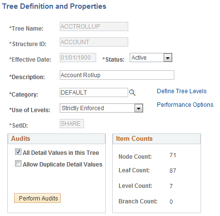

The Tree Definition and Properties page is used to define trees.
This example illustrates the fields and controls on the Tree Definition and Properties page.
Tree Definition and Properites page
The Audits section determines how you want to handle detail values.
When the All Detail Values in this Tree check box is selected, tree log entries are impacted when you add, change, or remove effective dates using the online component. The Tree Flattener process identifies the need to refresh the data, which is performed during the subsequent run of the process.
When the All Detail Values in this Tree check box is not selected, then the Tree Flattener process only refreshes log entries when the modified ChartField value exists in the tree range, or is a value in the tree node or leaf.
For more information about the Tree Definition and Properties page, see PeopleTools: Tree Manager, “Saving and Configuring Trees”.

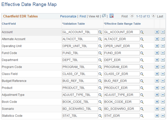

Effective Date Range Map Page
Use the Effective Date Range Map page (EDR_CF_DEFN) to map each ChartField table to an EDR table.
Navigation:
Set Up Financials/Supply Chain, and then Common Definitions, and then Design ChartFields, and then Effective Date Range Data, and then EDR Mapping Definition
This example illustrates the fields and controls on the Effective Date Range Map page.
The names of the tables that contain ChartField effective-date range data is delivered as system data.
The Project ChartField is not listed because project data is not effective dated.

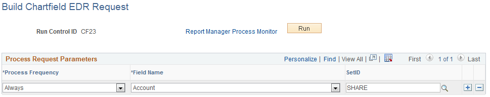

Build Chartfield EDR Request Page
Use the Chartfield EDR Request page (EDR_CF_REQ) to run the build effective date range process, which creates missing effective dated entries in the EDR table.
Navigation:
Set Up Financials/Supply Chain, and then Common Definitions, and then Design ChartFields, and then Effective Date Range Data, and then Build CF Date Range Rqst
This example illustrates the fields and controls on the Build Chartfield EDR Request page.
Build ChartField EDR Request page
When the Tree Flattener feature is initially installed, you must run this process. After the initial run, you can run the process when ChartField effective dates are added, changed, or removed.
This process synchronizes the effective dated entries in the EDR table when ChartField effective dates are modified, added, or deleted.
SetID can be blank to run this process for all SetIDs.

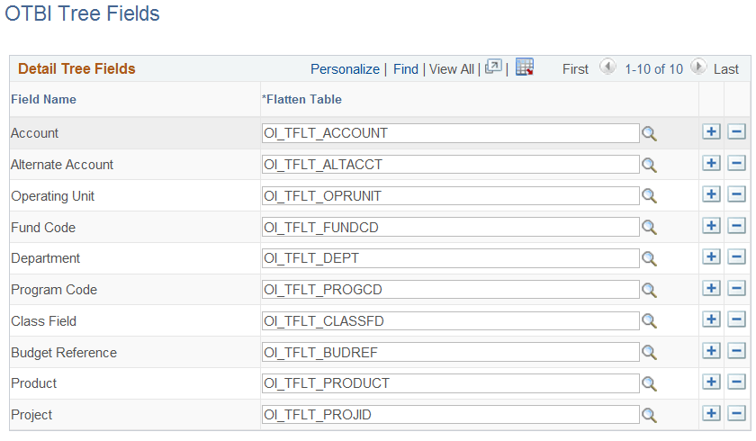

OTBI Tree Fields Page
Use the OTBI Tree Fields page (OI_TFLT_FIELDS) to manage the flattened table for each detail tree field. The delivered metadata supports flattened tree data for General Ledger ChartFields including Project ID.
Navigation:
Set Up Financials/Supply Chain, and then Operational Reporting, and then Tree Flattener, and then Tree Fields
This example illustrates the fields and controls on the OTBI Tree Fields page.
You can add your own detail tree fields and flatten tables. The PS/FS Tree Flattener process supports any detail tree fields with a field value length that is less thank or equal to 30 characters.
You cannot change the flatten tree table or delete a row if the flattened tree table had data.
Field or Control Description
Field Name
Detail tree fields upon which the Tree Flattener tables are based. PeopleSoft delivers the ChartFields and respective tables to be used in the PS/FS Tree Flattener process (OI_TFLT). You can add your own fields and respective tables to use in this process.
Flatten Table
PeopleSoft delivers a record for each delivered ChartField to be used in storing the flattened tree data. You can add your own records to be used in the tree flattening process for user-defined ChartFields. It is not recommended that you change the flatten table for the delivered ChartFields.

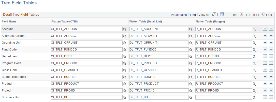

Tree Field Tables Page
Use the Tree Field Tables page (OI_TFLT_FIELDS) to map ChartFields to flattened tree tables.
Navigation:
Set Up Financials/Supply Chain, and then Operational Reporting, and then Tree Flattener, and then Assign CF Tree Flattened Tbl
This example illustrates the fields and controls on the Tree Field Tables page.
The names of the tables that contain the flattened tree data are delivered as system data.

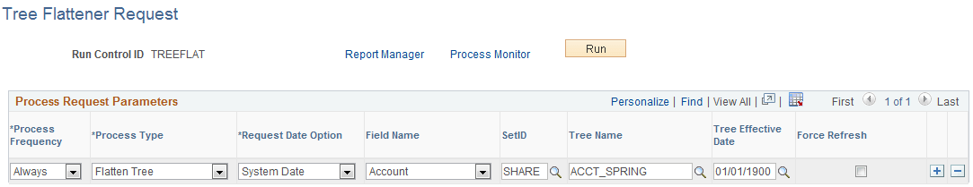

Tree Flattener Request Page
Use the Tree Flattener Request page (OI_TFLT_REQ) to run the PS/FS Tree Flattener process (OI_TFLT), which allows you to schedule a request periodically to pick up changes that occur in the tree definitions and ChartField values.
Navigation:
Set Up Financials/Supply Chain, and then Operational Reporting, and then Tree Flattener, and then Tree Flattener Request
This example illustrates the fields and controls on the Tree Flattener Request page.
Process Type
Select one of these values:
  • Flatten Tree: Select to flatten the request data.
  • Delete Values: Select to clear values from the flatten tree tables.
    This option is not necessary before running the Flatten Tree process (Process Type = Flatten Tree) because the process automatically removes old tree data from the flatten tree tables before inserting new flatten tree data.
    When this option is selected, the system displays only the OTBI Source Instance field.
Request Date Option
Select a date option that is used when selecting effective dated tree data.
  • As of Date: Select to enter a user-defined date for the selected tree.
  • System Date: Select to use the system date to select the closest effective data for the selected tree.
This option is not used if you specify a Tree Effective Date.
Field Name
Select a detail tree field to be used when flattening the corresponding tree data.
SetID
Select the tree SetID if applicable. The SetID is required for flattening trees that are keyed by SetID.
Business Unit
Enter a business unit. This field is available if Project Costing is installed to select project trees that are keyed by business unit. You can specify trees that are maintained by SetID or Business Unit. The tree flattener process supports trees that are keyed by SetID or Set Control Value.
Tree Name
Select a tree name, which is required when you select Flatten Tree in the Process Type field.
Tree Effective Date
(Optional) Enter the tree effective date.
Enter a unique number (process instance plus request sequence number), which is used by the flatten tree process to identify the tree data when Delete Values is selected in the Process Type field.
Force Refresh
Select to refresh the tree data even if the flattened tree data has a status of Current on the Flatten Tree Log Page. This is typically used if the structure of the tree has been changed.
