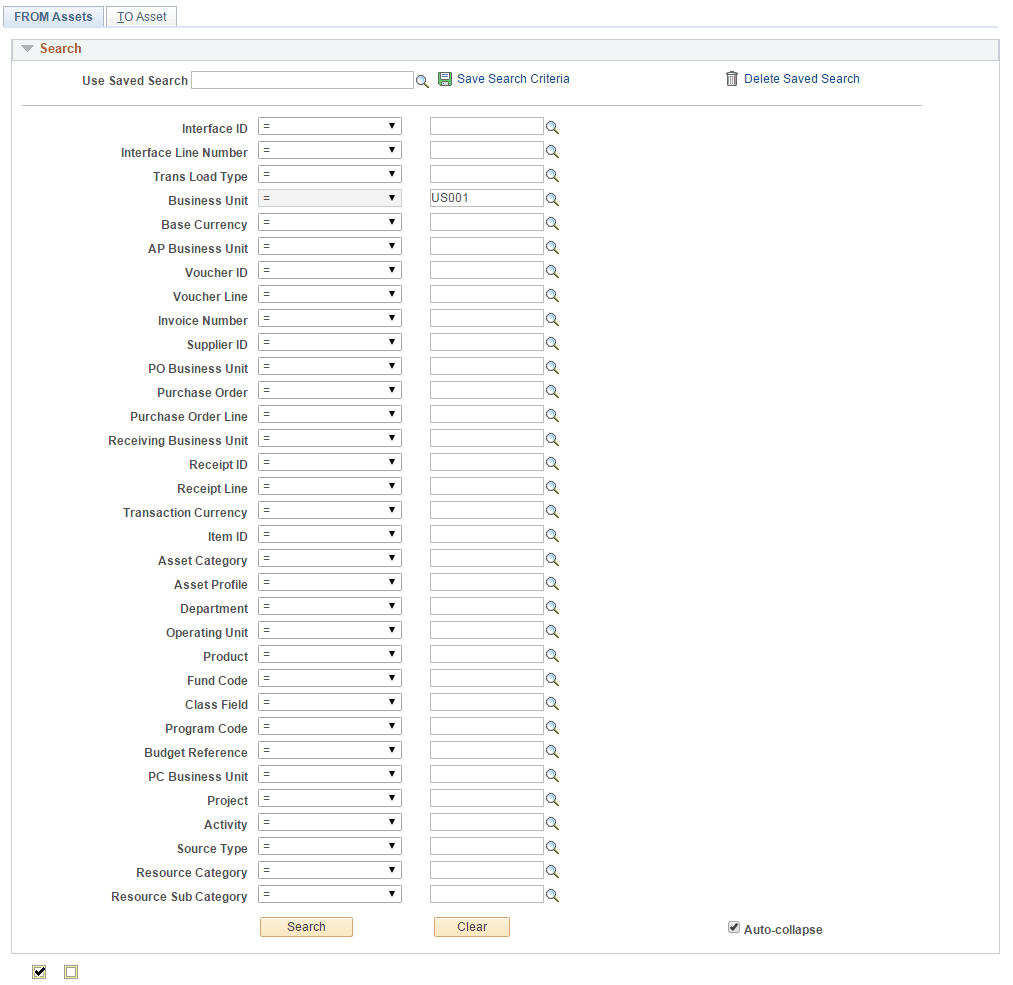

Consolidate Assets - FROM Assets Page
Use the Consolidate Assets - FROM Assets page (ASSET_CONSOL_01) to consolidate assets with an action of Add.
Navigation:
Asset Management, and then Send/Receive Information, and then Interface Transactions, and then Consolidate Assets, and then FROM Assets
This example illustrates the fields and controls on the Consolidate Assets - FROM Assets page. You can find definitions for the fields and controls later on this page.
Asset Consolidation - FROM Asset Page (1 of 2)
Asset Consolidation - FROM Asset Page (2 of 2)

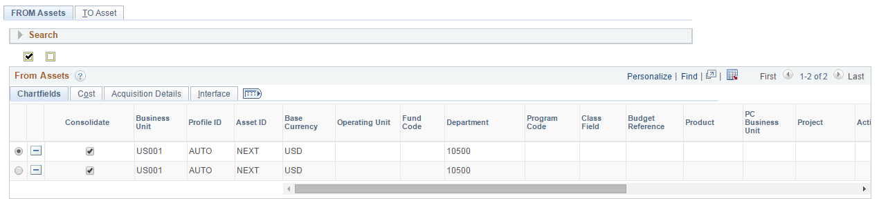

This page enables you to add and search for consolidation-from assets with a particular value by using these search fields:

You use different search fields when consolidating lines from different systems. For example, when consolidating lines from PeopleSoft Payables, you can use Voucher ID. When consolidating lines from Purchasing, you can use Purchase Order Number. If you enter Invoice Number, the system prompts you to select from a list of invoice numbers; if you enter Purchase Order Numbers, you receive a list of Purchase Order numbers.
Enter the search field that you want to use, and then enter the value to search for. Data retrieval is based on combined keys; therefore, you are prompted to supply a business unit. Click the Search button to process your input and view the search results. The Search area collapses automatically for your convenience.
You can define row-level security for the selection fields to limit searches by role or permission list.

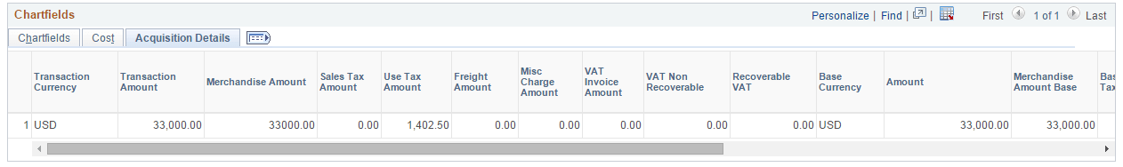

From Assets Tabs
Field or Control Description
ChartFields
Review ChartField details—such as Department and Operating Unit—related to the load line.
This tab displays multiple ChartField distributions associated with an asset.

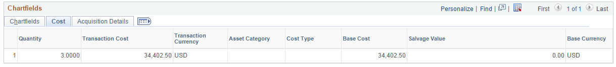

Cost
Review cost details—such as Cost, Cost Type, and Currency—related to the load line.

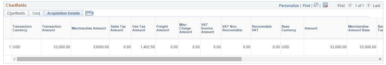

Acquisition Details
Review acquisition details—such as Freight and Total VAT—related to the load line.
Interface
Review interface details, including the interface line, about the load line.
Use the ‘Select this row’ option to designate a default row. The default row is the one from which values are copied when you access the TO Asset page.
Use the Consolidate option to select the assets you want to include in the consolidation. The assets you select are transferred to the Consolidation - TO Asset page for consolidation—all rows in the grid with the Consolidate option selected are used to create the new asset and the physical information is created using the data from the default row, such as asset ID, profile, and so forth.

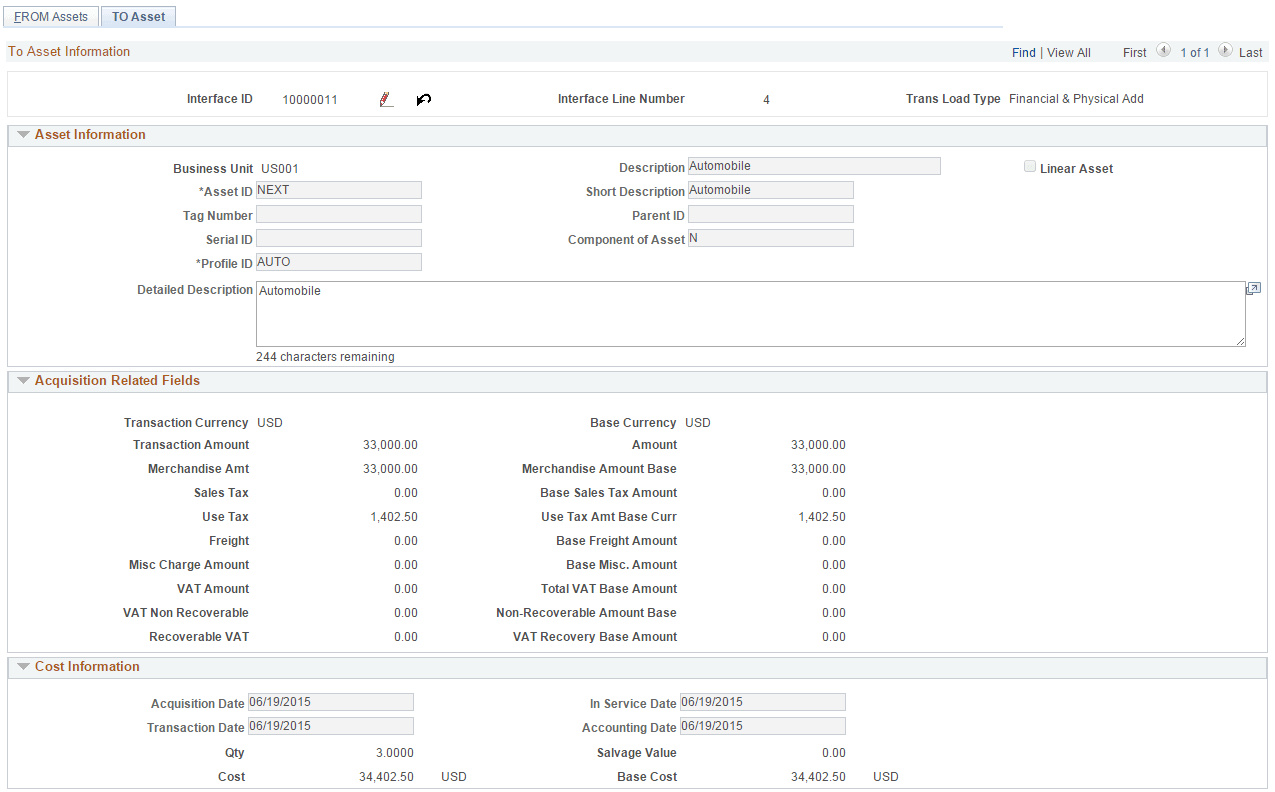

Consolidate Assets – TO Asset Page
Use the Consolidate Assets - TO Asset page (ASSET_CONSOL_02) to consolidate and save your new asset as a load line.
Navigation:
Asset Management, and then Send/Receive Information, and then Interface Transactions, and then Consolidate Assets, and then TO Asset
This example illustrates the fields and controls on the Consolidate Assets - TO Asset page. You can find definitions for the fields and controls later on this page.
Asset Consolidation - TO Asset Page (1 of 5)
Asset Consolidation - TO Asset Page (2 of 5)
Asset Consolidation - TO Asset Page (3 of 5)
Asset Consolidation - TO Asset Page (4 of 5)
Asset Consolidation - TO Asset Page (5 of 5)

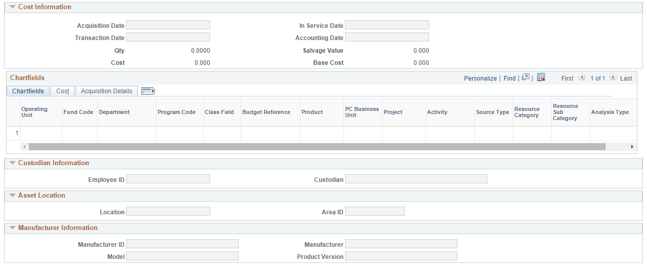

Enter information about your asset if appropriate. Most of the fields on this page are optional fields.
The values displayed in the Cost, Sales Tax, Freight, and Use Tax fields equal the sum of the value for all of the consolidated from assets.

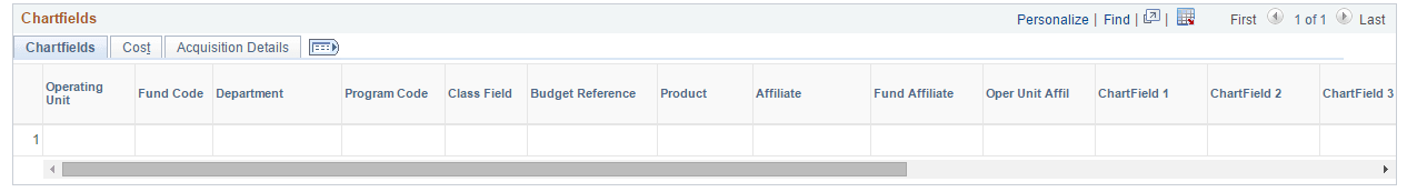

ChartFields
Review ChartField details—such as Department and Operating Unit—related to the consolidated asset.

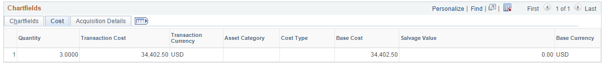

Cost
Review cost details—such as Cost, Cost Type, and Currency—related to the consolidated asset.

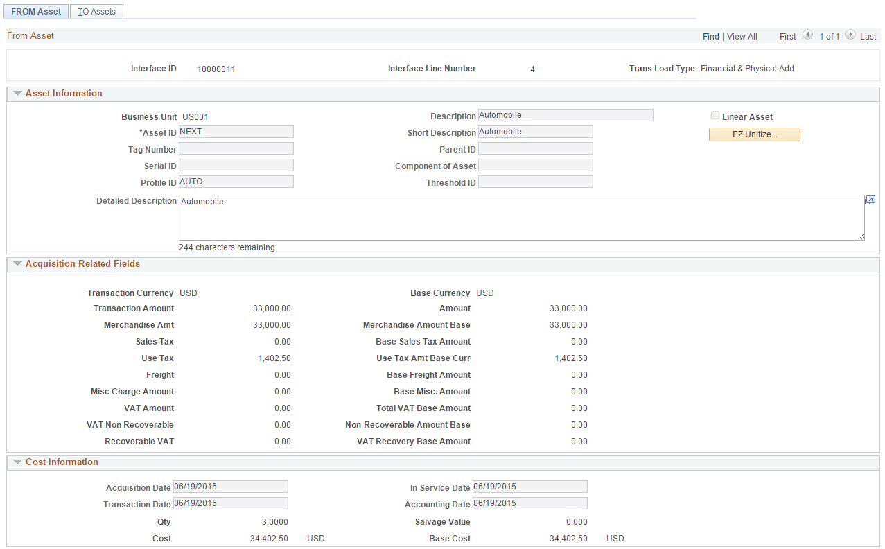

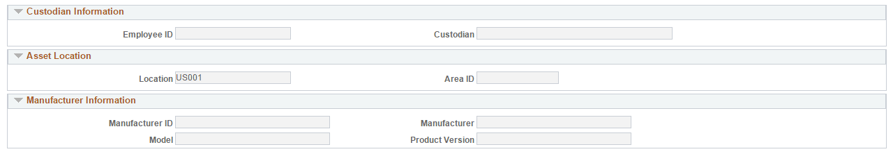

Unitize Assets – FROM Asset Page
Use the Unitize Assets - FROM Asset page (ASSET_UNIT_01) to view detailed information on the load line that you selected.
Navigation:
Asset Management, and then Send/Receive Information, and then Interface Transactions, and then Unitize Assets
This example illustrates the fields and controls on the Unitize Assets - FROM Asset page. You can find definitions for the fields and controls later on this page.
Asset Unitization - FROM Asset Page (1 of 5)
Asset Unitization - FROM Asset Page (2 of 5)
Asset Unitization - FROM Asset Page (3 of 5)
Asset Unitization - FROM Asset Page (4 of 5)
Asset Unitization - FROM Asset Page (5 of 5)
Verify that this is the line that you want to unitize, then click EZ Unitize to access the Proportional Unitization Defaults page, where you can proportionally unitize.
Unitizing interface rows that contain a default PROFILE_ID equal to N (multibook assets) prompts unitization of all books. The cost of the other books for each new asset is based on the percent cost of the unitized book.

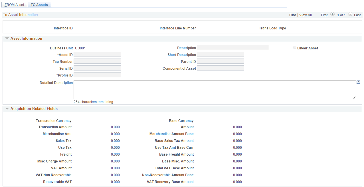

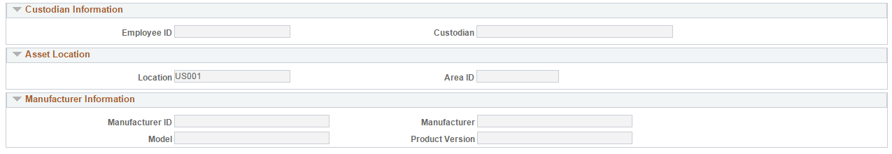

Unitize Assets – TO Assets Page
Use the Unitize Assets - TO Assets page (ASSET_UNIT_02) to define individual assets into which you want this load line unitized.
Navigation:
Asset Management, and then Send/Receive Information, and then Unitize Assets, and then TO Assets
This example illustrates the fields and controls on the Unitize Assets - TO Assets page. You can find definitions for the fields and controls later on this page.
Asset Unitization - TO Asset Page (1 of 2)
Asset Unitization - TO Asset Page (2 of 2)
