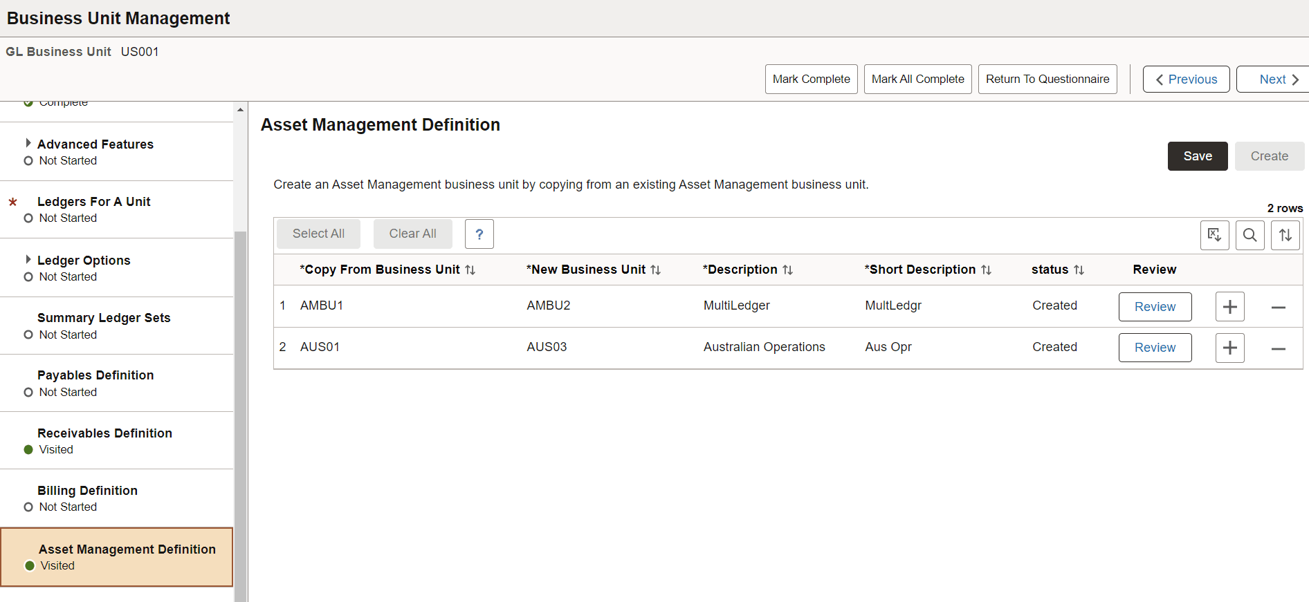

Asset Management Definition Page
Use the Asset Management Definition page (AM_BU_COPY_FL) to modify, add, and copy Asset Management business units.
Navigation:
PeopleSoft Home, and then Finance & Accounting, and then Business Unit Management tile, and then Create New Ledger, and then Basic Information, and then Asset Management Definition
This example illustrates the Asset Management Definition page.
Business Unit Management - Asset Management Definition page
See the PeopleSoft General Ledger: View Business Unit Management Page for field definitions.
This page allows you to create a new Asset Management sub-ledger business unit by copying from an existing sub-ledger business unit. The new sub-ledger business unit is not created until you select the Create button. When the Create button is selected, the Review button is available to proceed to the sub-ledger Questionnaire page. The system then proceeds to the sub-ledger configuration pages.

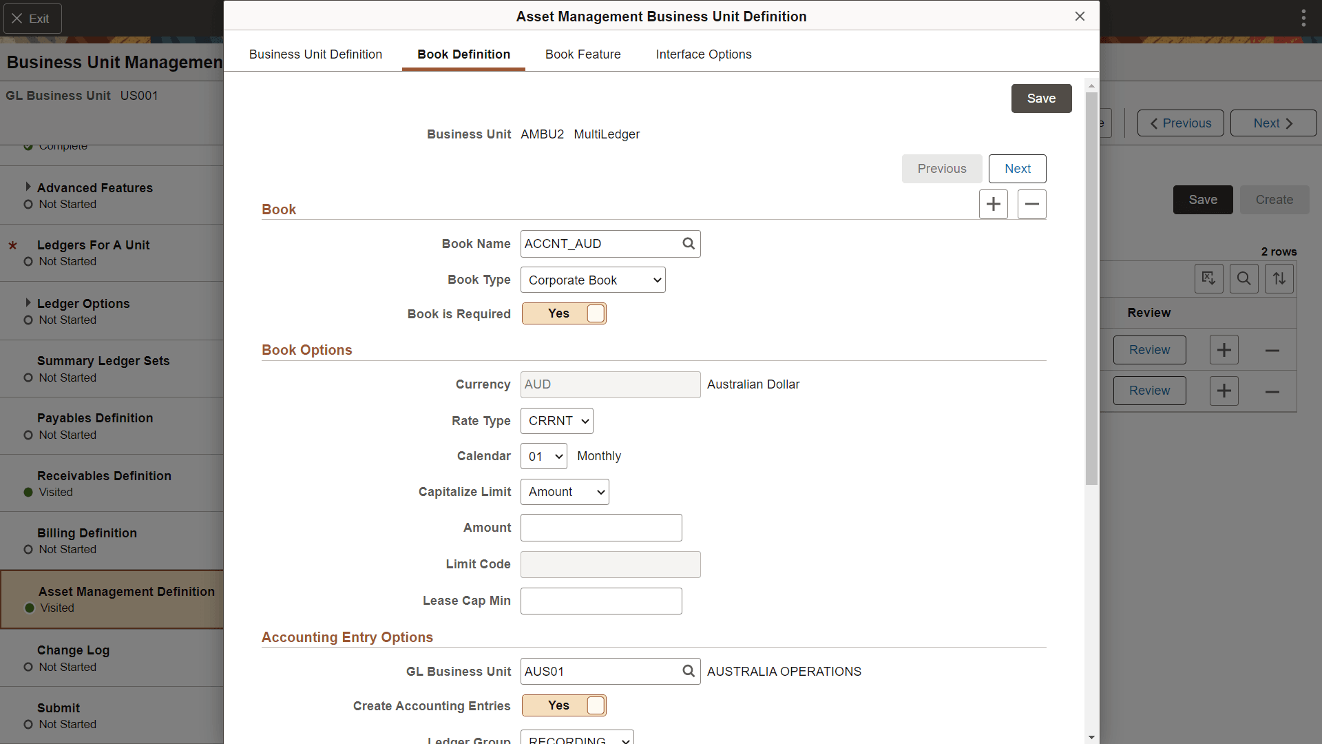

Book Definition Page
Use the Book Definition page (BU_BOOK_DEFN_01_FL) to define required books, book options, and accounting entry options for each book that the business unit uses.
Navigation:
PeopleSoft Home, and then Finance & Accounting, and then Business Unit Management tile, and then Create New Ledger, and then Basic Information, and then Asset Management Definition, and then Book Definition
This example illustrates the Book Definition page.
Business Unit Management - Book Definition page
See the Business Unit/Book Definition Page for field definitions.

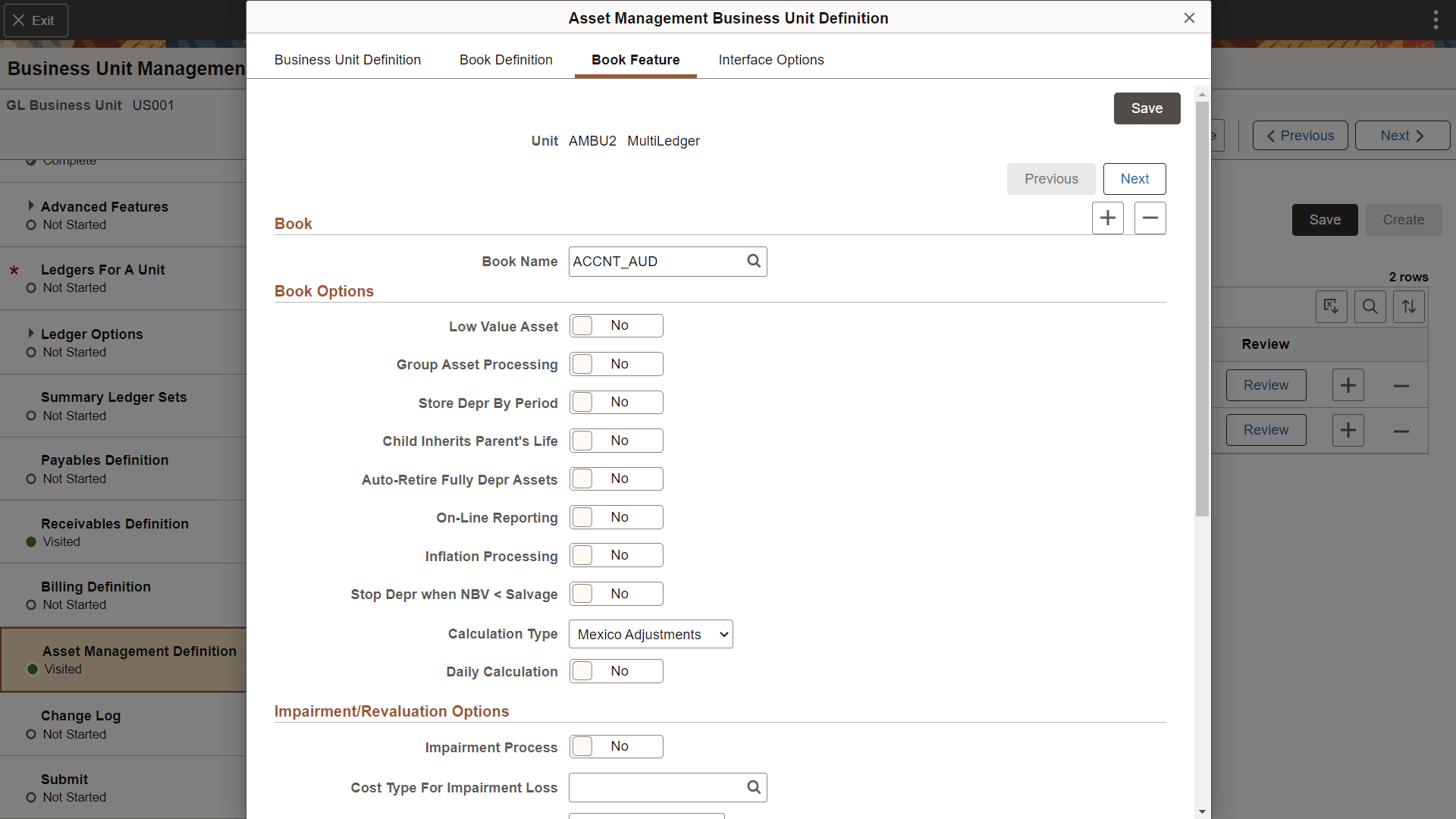

Book Feature Page
Use the Book Feature page (BU_BOOK_FEATURE_FL) to enable book and book options, and (optionally) impairment and revaluation options for a business unit.
Navigation:
This example illustrates the Book Feature page.
Business Unit Management - Book Feature page
See the Business Unit/Book Feature Page for field definitions.

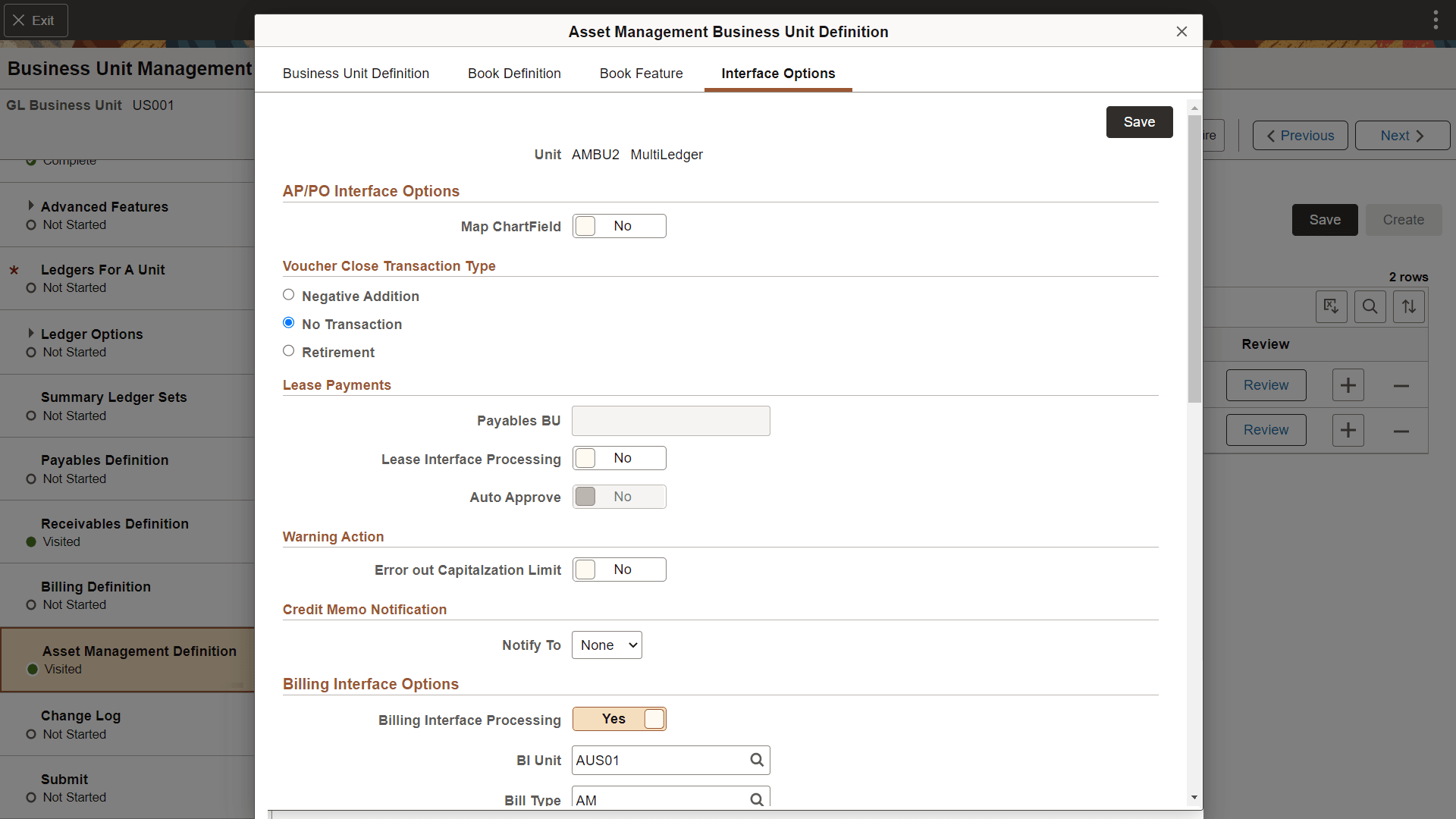

Interface Options Page
Use the Interface Options page (BUS_UNIT_INT_OP_FL) to establish product and application interface default processing options for Payables, Purchasing, Billing, Lease Administration, and Maintenance Management.
Navigation:
PeopleSoft Home, and then Finance & Accounting, and then Business Unit Management tile, and then Create New Ledger, and then Basic Information, and then Asset Management Definition, and then Interface Options
This example illustrates the Interface Options page.
Business Unit Management - Interface Options page
