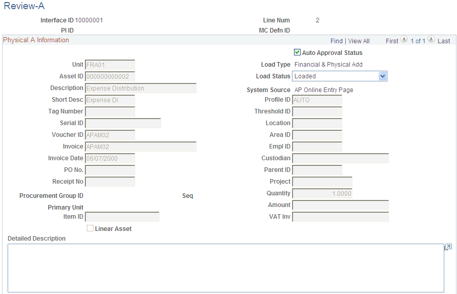

Physical Transactions A Page and Physical Transactions B Page
Use the Physical Transactions A page (INTFC_PHY_A) and the Physical Transactions B page (INTFC_PHY_B) to view data in the physical loader table.
Navigation:
Asset Management, and then Send/Receive Information, and then Approve Physical Information, and then Review A or Review B
This example illustrates the fields and controls on the Review-A Page. You can find definitions for the fields and controls later on this page.
Review-A page
Preview the data and complete the appropriate fields.
