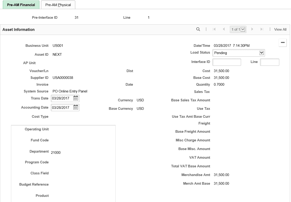

Pre-AM Financial Page
Use the Pre-AM Financial page (INTFC_PRE_AM_02) to review the asset financial data in the pre-interface table.
Navigation:
Asset Management, and then Send/Receive Information, and then Preview AP/PO Information, and then Pre-AM Financial.
This example illustrates the fields and controls on the Pre-AM Financial Page. You can find definitions for the fields and controls later on this page.
Pre-AM Financial page (1 of 2)
Pre-AM Financial page (2 of 2)
Field or Control Description
Load Status
Displays the current status of the pre-interface row for the asset ID.
Values for this field are:
  • Pending: Transaction Pending.
  • PO Group Incomplete: Procurement Group is incomplete. All items within a procurement group sequence have not yet been received. See Consolidating Requisition and Purchase Order Lines for Asset Components.
  • Consolidated: Transaction consolidated.
  • Errored: Transaction errors. See error message for details.
  • Excluded: Transaction is being excluded from Asset Management due to the asset cost not meeting the corresponding capitalization threshold. A detailed message appears in the Error Message field. Additionally, the system inserts an entry in the audit table.
  • In Process: Transaction in process.
  • Loaded: Transaction loaded.
  • On Hold: Transaction on hold. Set this status manually to prevent the processing of some rows if you are expecting another event to occur before running.
  • Replaced: Transaction replaced by other interface records.
  • Unitized: Transaction unitized (not loaded).
Note: The Load Status field is an editable field, except when the status is PO Group Incomplete. When all items in a Procurement Group Sequence are received, the Load Status field on the Pre-AM Financial page is updated from PO Group Incomplete to Pending.

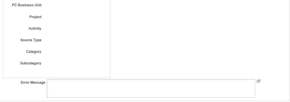

Error Message
Displays a detailed error message when a pre-interface transaction error occurs.
Procurement Group
Use the Procurement Group group box to process procurement group related data.
This group box displays only when you select rows with procurement group information.
Procurement Group ID
Displays the procurement group ID.
Seq (Sequence)
Displays the procurement group sequence number.
Primary Unit
Indicates whether the procurement group sequence has a primary unit.
View Related Rows
Click to view the Review page and view additional rows related to the current row.
This link is available only when a group sequence contains related rows.
Update Status
Specify whether to update the load status of the current row only or the current row plus its related rows.
Select the Procurement Group Seq option to update the load status of the current row and its related rows. Select the Current Row Only option to update the load status of the current row only.
If the procurement group sequence does not have a primary unit associated with it, the Update Status field defaults to the Procurement Group Seq option and you cannot modify the field.
Procurement Information
Indicate whether the AM Pre-Interface Tables will retain procurement group information.
Select the Keep Group Info option to retain procurement group information for the current row and related rows. Select the Remove Group Info option to exclude procurement group information for the current row and related rows.
If the procurement group sequence has a primary unit associated with it and you have selected the Procurement Group Seq option for the Update Status field, the Keep Group Info and Remove Group Info options are available for selection in the Procurement Information field.
If the procurement group sequence has a primary unit associated with it and you have selected the Current Row Only option for the Update Status field, the Procurement Information field defaults to the Remove Group Info option. You cannot modify the field.
If the procurement group sequence does not have a primary unit associated with it, the Procurement Information field defaults to the Remove Group Info option and you cannot modify the field.

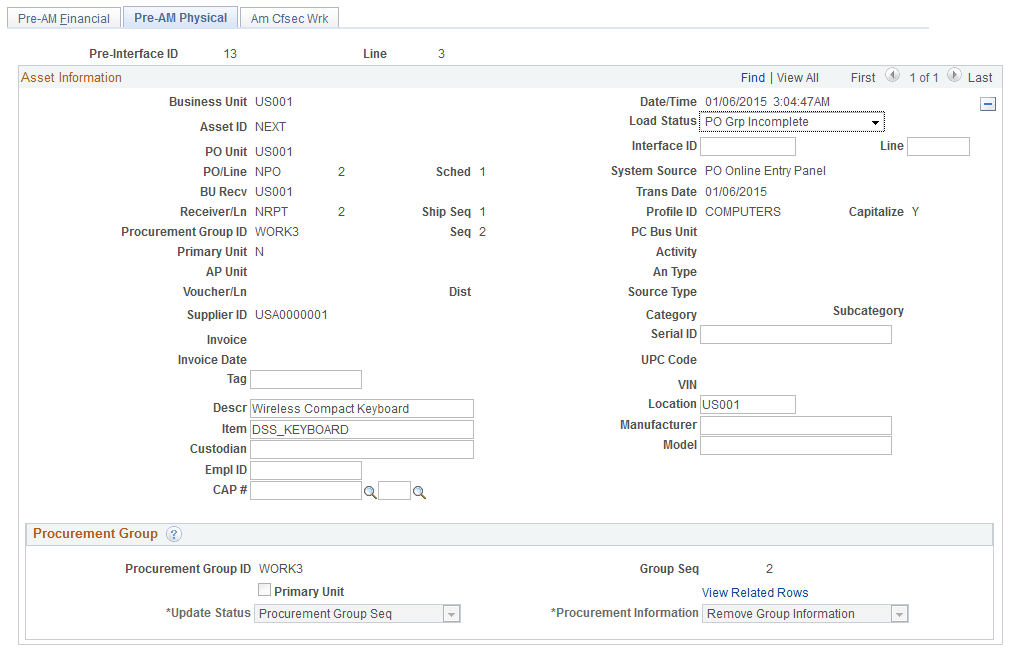

Pre-AM Physical Page
Use the Pre-AM Physical page (INTFC_PRE_AM_01) to review the physical asset data loaded in the pre-interface (Pre-AM 1) table.
Navigation:
Asset Management, and then Send/Receive Information, and then Preview AP/PO Information, and then Pre-AM Physical.
This example illustrates the fields and controls on the Pre-AM Physical Page. You can find definitions for the fields and controls later on this page.
Displays the Procurement Group ID for the asset, if applicable. A procurement group ID is an identifier that is used to associate multiple related purchased items for an asset. The Procurement Group ID can be assigned to a group of procurement transaction lines on a single purchase order or across multiple purchase orders. See Consolidating Requisition and Purchase Order Lines for Asset Components
Seq (sequence)
Displays the Procurement Group Sequence number. Each transaction within a procurement group ID is assigned a procurement group sequence number.
Primary Unit
Displays the item that is the designated primary unit for the asset. The primary unit for the procurement group ID is assigned on the Procurement Group page. When an item is flagged as a primary item, a separate transaction is inserted into INTFC_PRE_AM in increments of the unit allocation quantity or amount and has its own sequence number.
Asset Management enables you to add assets from existing POs and receipts, r from existing accounts payable vouchers.
If the fields on this page are changed, the voucher data may not match the PeopleSoft Asset Management data. In this case, the load status of the inconsistent rows should be set to Errored. You should then correct the voucher and resend it to PeopleSoft Asset Management. Physical information can be changed here because it does not affect capitalization or depreciation. In case AMPS1000 sets the status to Errored, you need to check the message log on the process monitor for the error message. Care should be taken to keep these changes in sync with purchasing and receiving data.
Procurement Group
Seq (Sequence)
Primary Unit
View Related Rows
Update Status

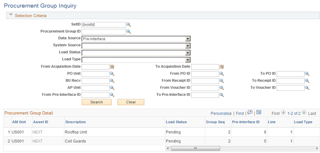

Procurement Group Inquiry Page
Use the Procurement Group Inquiry page (AM_PO_GROUP_INQ) to review procurement group details and statuses.
Navigation:
Asset Management, and then Send/Receive Information, and then Procurement Group Inquiry, and then Procurement Group Inquiry.
This example illustrates the fields and controls on the Procurement Group Inquiry Page. You can find definitions for the fields and controls later on this page.
Selection Criteria
Enter any criteria for the procurement group for which you want to review details.
Select to limit your search results to a specific procurement group ID. A procurement group ID is an identifier used to associate multiple related purchased items. The Procurement Group ID can be assigned to a group of procurement transaction lines on a single purchase order or across multiple purchase orders. See Consolidating Requisition and Purchase Order Lines for Asset Components.
Data Source
Select one of the following data sources if you want to further limit your search results:
  • Pre-interface – select to view procurement group details of data that resides in the Pre-Interface table after running the Receiver Interface Push Application Engine process (PO_RECVPUSH) in Purchasing or the Load Assets Application Engine process (INTFAPAM) in Payables.
  • Interface – select to view procurement group details of data that resides in the Transaction Loader tables after running the Payables/Purchasing Interface process (AMPS1000).
  • Asset Acquisition Detail – select to view procurement group details of data that resides in the Asset Management tables after running the Transaction Loader process (AMIF1000).
Procurement Group Detail
Group Seq (group sequence)
Unit
Displays the Asset Management Business Unit.
PO
Click this link to drill into the PO_LINE_INQ page. See PeopleSoft Payables: Purchase Order Inquiry Page
Voucher
Drill to AP_VOUCHER_INQUIRY. See PeopleSoft Payables: Voucher Inquiry Page
