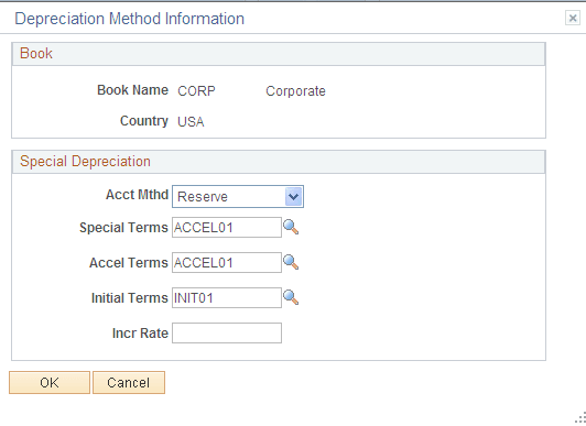

Depreciation Method Information Page
PROFILE_DEPR_DETL
Set special depreciation terms for an asset profile and select an accounting method for these special terms. These are commonly used to meet depreciation requirements for specific countries.

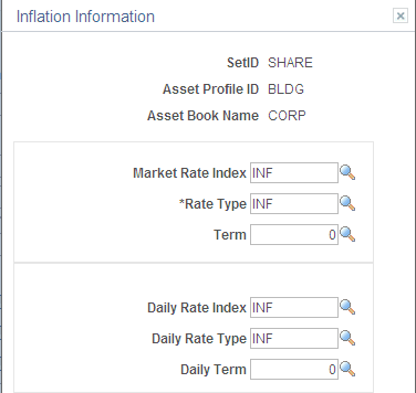

(ARG, BRA, and MEX) Asset Profiles - Inflation Information page
PROFILE_SEC
Establish an inflation adjustment factor by selecting the market index and rate to apply.

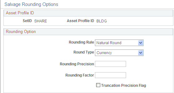

(JPN) Salvage Rounding Options page
SALVAGE_OPTION_SEC
Enter options for rounding depreciation amounts for this book. This is for use in Japan.

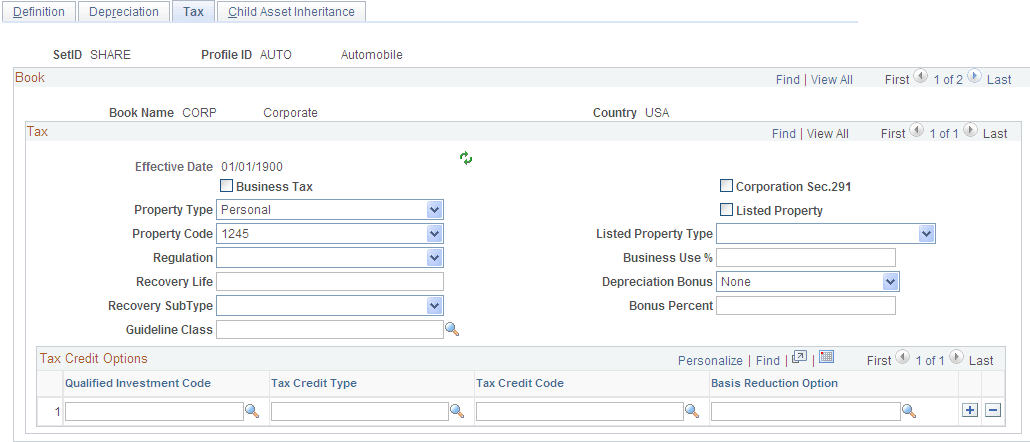

Asset Profiles - Tax Page
PROFILE_BK_03
Specify property type and tax depreciation criteria and identify which tax credits will be used by the profile.

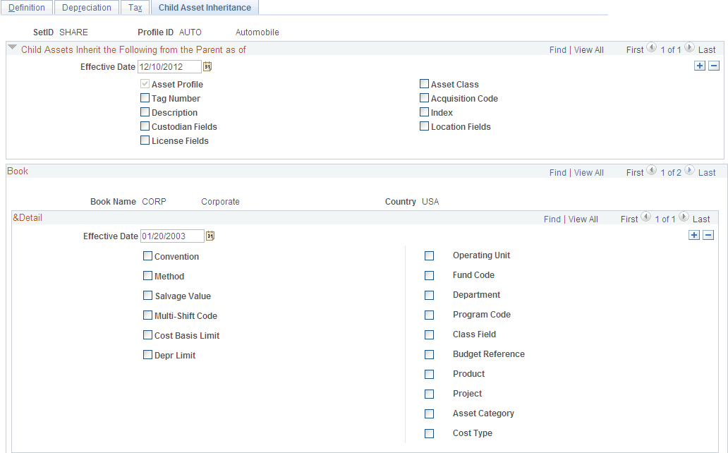

Child Asset Inheritance Page
PROFILE_PAR_BK_ECD
Specify child asset attributes that will be used by the profile and inherited from the parent asset for Express Add, Basic Add, and batch-created assets. The inheritance based on the selected items happens upon defaulting the profile in Express Add and capitalizing the asset in Basic Add, and when you are using Default Profile processing in the Transaction Loader if the Business Unit option is selected.

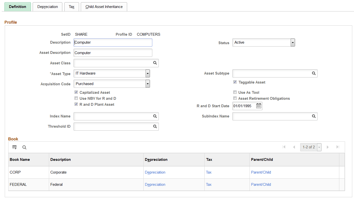

Asset Profiles – Definition Page
Use the Asset Profiles - Definition page (PROFILE_DEFN) to define asset profiles.
Navigation:
Set Up Financials/Supply Chain, and then Product Related, and then Asset Management, and then Profiles, and then Asset Profiles
This example illustrates the fields and controls on the Asset Profiles - Definition page. You can find definitions for the fields and controls later on this page.
You create asset profiles from the Profile (PROFILE) component. You can create profiles with varying levels of detail. The level that you use depends on how much information you want to be provided by default into the system when you add an asset. Some asset profiles are used to define financial attributes, while others are not. To successfully create a financial profile, you must enter at least the following information:
  • Profile ID.
  • Asset category.
  • Asset book name.
  • Depreciation attributes.
  • Asset type.
Each profile has a unique profile ID. You can use this ID to group profiles by type. For example, you might want to have several automobile profiles, such as Autos, Autos-Luxury, and Autos-Leased.

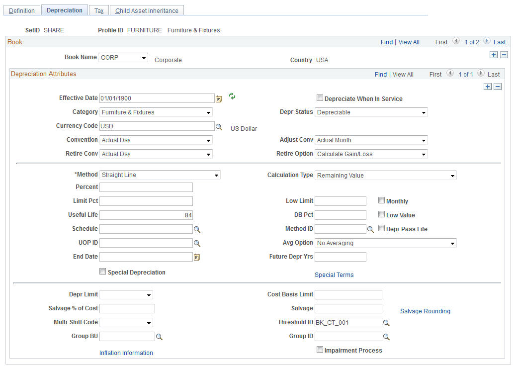

Asset Profiles - Depreciation Page
Use the Asset Profiles - Depreciation page (PROFILE_BK_01) to identify the criteria to use in depreciation calculations.
Navigation:
Set Up Financials/Supply Chain, and then Product Related, and then Asset Management, and then Profiles, and then Asset Profiles, and then Depreciation
This example illustrates the fields and controls on the Asset Profiles - Depreciation page. You can find definitions for the fields and controls later on this page.
Depreciation page
Each asset can report to multiple books and have multiple depreciation attributes per book.
Field or Control Description
Book Name
Enter a book name that defines the rules for the assets entered with this profile. Books are defined during system setup and associated with business units. Only valid books can be assigned.
Effective Date
Enter the date that indicates when the convention and depreciation method take effect. If you want a history of changes made to a profile, be sure to add new rows to the table and use effective dating to update profiles, rather than making changes to the initial row.
Depreciate When in Service
Select to allocate annual depreciation as of the date that you placed the asset in service. If you do not select this option, PeopleSoft Asset Management allocates annual distribution as of the date determined by the depreciation convention. This option is valid only in the year that the asset was acquired.
Category
Defines the category of an asset, such as Furniture & Fixtures or Machinery & Equipment. The available category codes are those you entered on the Category Code table. In general, these will correspond to the General Ledger asset accounts. Asset Category is used in accounting entry generation.
Depr Status
Enter the depreciation status.
Currency Code
Select a currency code.
Adjust Conv (adjustment convention)
Select an adjustment convention.
Convention
Select a depreciation convention.
Retire Conv
Select a retirement convention.
Retire Option
Select the retirement calculation option to be processed for assets within a given profile. These retirement options are available at the profile, book and asset levels.
See PeopleSoft Asset Management: Retire Assets Page.
Method
Select a depreciation method. Some depreciation methods require you to enter additional information.
Note: If you specify the depreciation method as Flat Rate or a Declining Balance method or Manual depreciation for tax books, you should enter the recovery life.
If you select Non Depreciable on this page, you must still enter values for Useful Life and Convention. However, you need not update the remainder of the Asset Profiles pages. Because the profile is defined for non depreciable assets, the information in these pages will not be used in any processing.
Ensure that you establish an effective date for the profile that is valid for the currency code specified for the profile.

The Manual Depreciation method enables you to adjust depreciation amounts that are generated by some other method. To use manual depreciation, you must therefore first create depreciation entries using another method. When this has been done, you can make your adjustments.
Straight Line
Useful Life
Straight Line Percent
(IND) Percent
Sum of the Years
NA
Units of Production
UOP ID (units of production ID)
User Defined Method
Method ID, DB Pct, Percent, Low Limit, Depr Pass Life
The following table defines the additional fields:
Limit Pct (limit percent)
Enter a limit for depreciation as a percentage of cost.
Enter the units of production ID, production information, and transaction information that you want to use for this asset.
DB Pct (declining balance percent)
Enter the percentage of declining balance depreciation to be taken each year until the amount calculated by the straight line method is greater.
Percent
Enter the percentage of original basis to be taken in depreciation each year. This is required for straight line percent.
Low Limit
Enter an amount. When the asset basis reaches this limit, the remaining basis will be taken in depreciation and the asset will be fully reserved.
Depr Pass Life (depreciate past life)
Select if you want to continue to depreciate this asset past its useful life end date. This option is used for governmental regulations for certain countries or for utilities industries that may want to continue to depreciate an asset to the end of a depreciation calendar.
Method ID
Select the user-defined method that you want to use.
Schedule
Enter a schedule to use for depreciation.
Avg Option (average option)
Generally used by utility companies to depreciate composite assets. The averaging options are expressly designed to work with the flat rate depreciation method. Select an averaging option if you want to use it:
Monthly: Monthly averaging takes an average monthly asset balance and multiplies it by the annual depreciation rate. The result is then applied against a period allocation (1/12, 2/12, 3/12, and so on) to derive a year-to-date (YTD) depreciation amount. The difference between the newly calculated YTD depreciation and the previous YTD depreciation is the amount booked to the current period.
Yearly: Yearly averaging is similar to monthly averaging except that a yearly average balance is used. Because this amount is not known until the end of the year, it is usually estimated and adjusted periodically as the actual figures become known.
Using the flat rate depreciation method will cause any depreciation to be posted to the end of the calendar. If this is not your intention, you must enter a low limit of .01 when you first select the depreciation method for this asset. If you have not already done this, update the Depreciation Method field by selecting Flat Rate and entering .01 in the Low Limit additional field that appears.
Calculation Type
Select the calculation type.
  • Use Remaining Value to deduct any accumulated depreciation from the cost basis and expense the remaining value over the remaining life of the asset. Most assets will be depreciated using this option.
  • Use Life-to-Date to calculate the difference between the depreciation allowed and the depreciation taken. Typically, you would use life-to-date calculations when a change occurs in accounting principle, such as depreciation method. Changes of this type require an adjustment for the differences in accumulated depreciation to date.
For example, if you took 20,000 USD depreciation over a two-year period but the amount allowed was $24,000, the difference of $4,000 would be expensed as an adjustment to accumulated depreciation in the current period.
Low Value
Select to identify assets with costs below a certain level for special depreciation processing. This is a requirement for some countries.
Useful Life
Enter the number of periods. This is used to perform the depreciation calculations for the financial books.
End Date (end depreciation date)
Enter an end date that you want depreciation to cease at a particular time. At the end depreciation date, the remaining asset basis will be taken in depreciation and the asset will be fully reserved.
Future Depr Yrs (future depreciation years)
PeopleSoft Asset Management calculates and stores depreciation until the end of the asset life. However, for optimal processing performance and greater table efficiency, you can specify a fixed number of years for which depreciation is calculated and stored.
Note: Oracle strongly recommends using the Future Depreciation Years option if you are using group assets.
Special Depreciations
Select if you are working in a global environment and want to use special depreciation terms to meet specific country requirements. Click Special Terms to open the Depreciation Method Information page, where you can select special terms for depreciation.
Depr Limit (depreciation limit code)
Select a depreciation limit code that relates to a specific dollar amount limitation on depreciation for each year of life. Although this can be used for financial depreciation, it is commonly used for U.S. tax purposes, because such depreciation limits exist for items such as luxury automobiles.
Cost Basis Limit
Enter the limit on the depreciable basis of this asset. If the actual cost of an asset is greater than its depreciable basis, the difference will result in a gain when the asset is retired.
Salvage % of Cost and Salvage
Enter the residual value of the asset subtracted from the cost to determine the depreciable basis used in depreciation calculations. You can enter it either as a flat rate or as a salvage percentage (a percentage of the total cost of the asset). If you use a salvage percentage, the system recalculates the salvage value when you add additional costs for the asset.
(DEU) Multi-Shift Code
Enter rates by which depreciation should be increased based on the number of production shifts that an asset is used. This is used in Germany.
Threshold ID
If you want to define capitalization thresholds based on book, select the Threshold ID to use as the default value for assets within a given book.
When you populate this field, the capitalization status of each book is determined according to the capitalization threshold defined for that book.
This field appears only when the Capitalization Threshold feature is enabled from the Installation Options - Asset Management page.
This field is available for editing only when the Threshold ID on the Default page is unpopulated.
When the Capitalization Threshold feature is enabled, PeopleSoft Asset Management:
  • Automatically catalogues the capitalization status for batch and online asset additions.
  • Provides processes to deal with adjustments to the original cost.
  • Balances out any potential clearing account with other feeder systems.
  • Reassesses the capitalization status of the asset when subsequent transactions occur.
  • Provides reports and audit trails to facilitate control of these transactions.
    When adding an asset, the system uses the capitalization definition for the applicable Threshold ID to determine the appropriate capitalization action to take. Upon saving, the system compares the asset cost with the cost established for each bracket, as well as the basis option to decide the appropriate action to take. Alternatively, you can select to have the capitalization analysis performed by unit cost rather than total cost.
See .PeopleSoft Asset Management: Pages Used to Set Up and Manage Capitalization Thresholds
Group BU
Enter the business unit for the group assets.
Group ID
Select the group ID.
Impairment Process
Select to make the asset available for impairment processing.
Each group member asset profile can be used by only one business unit.
Use the Depreciation Method Information page (PROFILE_DEPR_DETL) to set special depreciation terms for an asset profile and select an accounting method for these special terms.
Navigation:
Select the Special Depr check box and click Special Terms on the Depreciation page of the Asset Profile component.
This example illustrates the fields and controls on the Depreciation Method Information page. You can find definitions for the fields and controls later on this page.
Allowance
Select to specify that special depreciation amounts are not booked with the standard depreciation amounts. Journal entries are generated that will include only the standard depreciation. PeopleSoft Asset Management does not support automatically generating journal entries for the special depreciation allowance accounting method. You may need to run two reports: Reserve for Special Depreciation and Reversal for Special Depreciation, and then generate the journal entries manually into the PeopleSoft General Ledger system.
Expense
Select to specify that total amounts of special depreciation and standard depreciation are booked and journal entries are generated that will include the total of standard and special depreciation amounts.
Reserve
Additional fields are provided to comply with the depreciation methods used in countries other than the U.S.
When you use additional terms, they affect depreciation calculations in the following ways:
Term Depreciation
Special
Depreciation × Rate
Accelerated
Depreciation × Rate
Initial
Cost × Rate
Increase
Depreciation × Rate
Year of Change(displayed from the ASSET_DPR_DETAILS page) is available only when the depreciation method is Japan-Change DB to SL.
Use the Asset Profiles - Inflation Information page (PROFILE_SEC) to establish an inflation adjustment factor by selecting the market index and rate to apply.
Navigation:
Set Up Financials/Supply Chain, and then Product Related, and then Asset Management, and then Profiles, and then Asset Profiles, and then Depreciation, and then Inflation Information
This example illustrates the fields and controls on the Inflation Information page. You can find definitions for the fields and controls later on this page.
Market Rate Index
Select the market rate index to be used for inflation processing.
See PeopleSoft Global Options and Reports: Defining Market Rates.
Rate Type
Select the market rate type to be used for inflation processing.
Term
Select the term.
Daily Rate Index
Select the daily rate index.
Daily Rate Type
Select the daily rate type.
Daily Term
Select the daily term.
See PeopleSoft Global Options and Reports: Establishing Market Rates.
Use the Salvage Rounding Options page (SALVAGE_OPTION_SEC) to enter options for rounding depreciation amounts for this book.
Navigation:
Click Salvage Rounding Options on the Asset Profile - Depreciation page.
This example illustrates the fields and controls on the Salvage_Rounding_Options. You can find definitions for the fields and controls later on this page.
Rounding Rule
The rounding rules that are delivered with PeopleSoft Asset Management are:
Down
NatRnd
Up
Round Type
The rounding types that are delivered with PeopleSoft Asset Management are:
Currency
Generic
Rounding Precision
Enter the number of places to the right or left of the decimal point to which the amount or number will be rounded. If you select Currency as the round type, the system automatically determines the round precision from the currency code.
Rounding Factor
Enter the number to which the amount will be rounded. For example, if you select Nat Rnd as the rounding rule, and enter a rounding factor of 25, amounts will be rounded to the nearest multiple of 25 so that an amount of 130 will be rounded to 125, and an amount of 140 will be rounded to 150. If you select Currency as the round type, the system will automatically determine the rounding factor from the currency code.
Truncation Precision Flag
Works with the round precision value. When you select it, amounts that contain many decimal places will be truncated to one decimal place to the right of the rounding precision position before rounding is performed. If you do not select it, the entire amount will be rounded. This example illustrates truncation precision:
  • Amount to be rounded: 10.03439.
  • Round precision: 3.
With Truncation Precision Flag selected, the system truncates the fifth decimal place and rounds 10.0343. Without the check box selected, the system rounds the entire amount. Actual rounding results depend on the selected rounding rule and round type.
Use the Asset Profiles - Tax page (PROFILE_BK_03) to specify property type and tax depreciation criteria and identify which tax credits will be used by the profile.
Navigation:
Set Up Financials/Supply Chain, and then Product Related, and then Asset Management, and then Profiles, and then Asset Profiles, and then Tax
This example illustrates the fields and controls on the Asset Profiles - Tax page. You can find definitions for the fields and controls later on this page.
Asset tax attributes primarily address Unites States tax issues except where noted.
Property Type and Property Code
Determine the amount of gain treated as ordinary income on the disposition of this asset.
Regulation
Identifies the depreciation system elected for this asset:
  • Accelerated Cost Recovery System (ACRS).
  • Asset Depreciation Range (ADR).
  • Conventional/Facts & Circumstance.
  • Asset Class Guideline.
  • Modified Accelerated Cost Recovery (MACRS).
Recovery Life and Recovery Subtype
For reporting purposes, you can further classify the asset by specifying the recovery life expressed in years and the recovery subtype, for example, 15-Year Low-Income Housing. You can also specify the asset guideline class. All current classifications are set up in the Tax Class table in the delivered tableset.
(IND) Guideline Class
Processing tax and depreciation in India requires the designation of a tax class rate that is associated with an asset block. To associate the tax class rate with a profile, enter the tax class and associated asset block rate here.
Corporation Sec. 291 (corporation section 291)
Select if this company is a corporation. This check box must be selected if the company is a corporation for the AMTX3210 tax report (Tax Retirement Capital Gains) to accurately reflect the correct Sec. 1231/Ordinary gains.
(FRA) Business Tax
Select if assets using this profile are subject to a business tax. This is required in some countries.
Listed Property
Select to record whether the asset is listed property. Listed property is a certain kind of asset that is conducive to mixed business or personal use, such as:
  • Passenger automobiles under a certain weight.
  • Any other property used for transportation, such as trucks, buses, boats, airplanes, motorcycles, and any other vehicles for transporting persons or goods.
  • Any property of a type generally used for entertainment, recreation, or amusement, such as photographic, phonographic, communication, and video recording equipment.
  • Any computer and related peripheral equipment, unless it is used only at a regular business establishment and owned or leased by the person operating the establishment.
  • Any cellular telephone (or similar telecommunications equipment) place in service or leased in a tax year beginning after 1989.
Listed Property Type
Select the property type that corresponds to the Listed Property check box.
Business Use % (business use percentage)
Enter the percentage amount of the business use of this listed property asset. Based on the business use percentage that you enter, the basis calculated for depreciation is:
(Basis) = (Cost*Bus_Use_%)
(USA) Depreciation Bonus
Select to indicate the specific depreciation bonus definition if the asset qualifies for depreciation bonus treatment. You can also create your own depreciation bonus definitions for selection in this field using the Depreciation Bonus Info page.
See Defining Depreciation Bonus Information.
PeopleSoft delivers the following values:
  • American Recovery: Select if the qualifying asset is placed in service on or after January 1, 2009 and on or before December 31, 2009 (before 2010 for certain transportation property and certain property with a long production period).
  • Gulf Opportunity Zone: Select for certain types of assets that are located within the hurricane zone as defined in the Senate Amendment to H. R. 4440 and the acquisition date and in-service date are on or after August 28, 2005 and on or before December 31, 2007 (December 31, 2008 for nonresidential real property or residential rental property).
  • New York Liberty Zone: Select if the acquisition date and in-service date are on or after September 11, 2001 and on or before December 31, 2007.
  • None: Select if the acquisition date and in-service date of the asset are on or before September 10, 2001, or, if the other options do not apply.
  • Section Federal (50%): Select if the acquisition date and in-service date are after May 5, 2003 and on or before December 31, 2005 to apply the 50 percent bonus.
  • Section 101- Local: Select if local or state allowance of the bonus depreciation should be applied. Define the parameters of the bonus depreciation as according to applicable local or state law using the Depreciation Bonus Info page.
  • Small Business Jobs: Select if the qualifying asset is placed in service on or after January 1, 2010 and on or before December 31, 2010 (before 2011 for certain transportation property and certain property with a long production period).
  • Stimulus Act: Select if the qualifying asset is placed in service on or after January 1, 2008 and on or before December 31, 2008 (before 2010 for certain transportation property and property with a long production period).
(USA) Bonus Percent
Supply the amount (percentage) to be applied if the asset qualifies for a depreciation bonus based on the acquisition date and in-service date.
Using Tax Credit Options
The rate and amount of the tax credit are based on federal tax law and determined by the qualified investment code, tax credit type and code, and basis reduction option in PeopleSoft Asset Management.
Select a qualified investment code if applicable:
A (accelerated):
D (depreciation):
F (facts):
Conventional Facts and Circumstances
G (guidelines):
Guideline
M (modified):
Modified Accelerated Cost Recovery (MACR)
Select a tax credit type if applicable. In the U.S., certain business incentive credits can be taken:
R (rehabilitation):
Rehabilitation Credit
E (energy):
Energy Credit
I (investment):
Regular Investment Credit
U (user):
User-defined
The tax credit code further defines the tax credit. For example, a 20 percent rehabilitation tax credit is available for historic buildings. Some credits require a corresponding reduction in the cost basis of the asset.
The basis reduction option indicates whether a reduction in the cost basis is required. Three codes are provided:
B (basis):
Basis Reduction
P (percentage):
Percentage Rate Reduction
N (no):
No Reduction
Use the Asset Profile - Child Asset Inheritance page (PROFILE_PAR_BK_ECD) to specify child asset attributes that will be used by the profile and inherited from the parent asset for Express Add, Basic Add, and batch-created assets.
Navigation:
Set Up Financials/Supply Chain, and then Product Related, and then Asset Management, and then Profiles, and then Asset Profiles, and then Child Asset Inheritance
This example illustrates the fields and controls on the Asset Profiles - Child Asset Inheritance page. You can find definitions for the fields and controls later on this page.
Select the attributes and other information that the child asset inherits from the parent asset.
