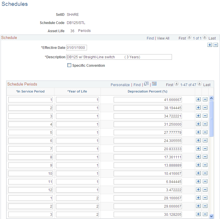

PeopleSoft Asset Management depreciation schedules are based on the percentage depreciation tables found in IRS Publication 534. You can modify existing depreciation schedules or add new schedules, by using the Depreciation Schedule page. On the Depreciation Schedules page, the method is DB150 with a switch to straight line. The in-service period for each year of the asset's life is the key to determining the percentage of depreciation allowed for any one year. For example, suppose that your organization runs on a monthly calendar and places an asset in service in January 1997. View Year of Life 1, In-Service Period 1 to find the percentage allowed in the first year; view Year of Life 2, In-Service Period 1 to find the percentage allowed for the second year, and so on.

Use the Schedules page (DEPR_SCHEDULE_DEFN) to add or modify depreciation tables.
Navigation:
Set Up Financials/Supply Chain, and then Product Related, and then Asset Management, and then Depreciation, and then Asset Depreciation Schedules
This example illustrates the fields and controls on the Schedules page. You can find definitions for the fields and controls later on this page.
Schedules page
Field or Control Description
Specific Convention
Select to apply a particular convention. The page refreshes and displays the Convention list box from which to choose the depreciation convention.
Convention
This field appears when selecting the Specific Convention check box. Select the convention that you want to use.
The schedule periods that you set up should reflect the periods set up in your calendar.
