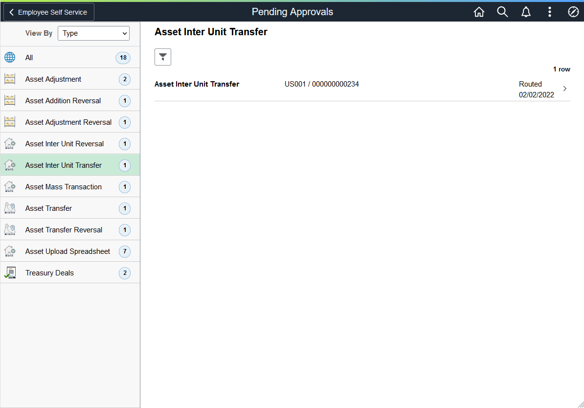

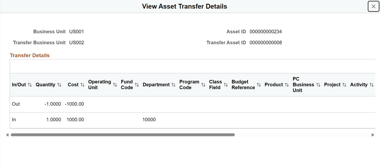

Pending Approvals - Asset Inter Unit Transfer Page
EOAWMA_MAIN_FL
View a list of all asset inter unit transfers that are pending your approval.

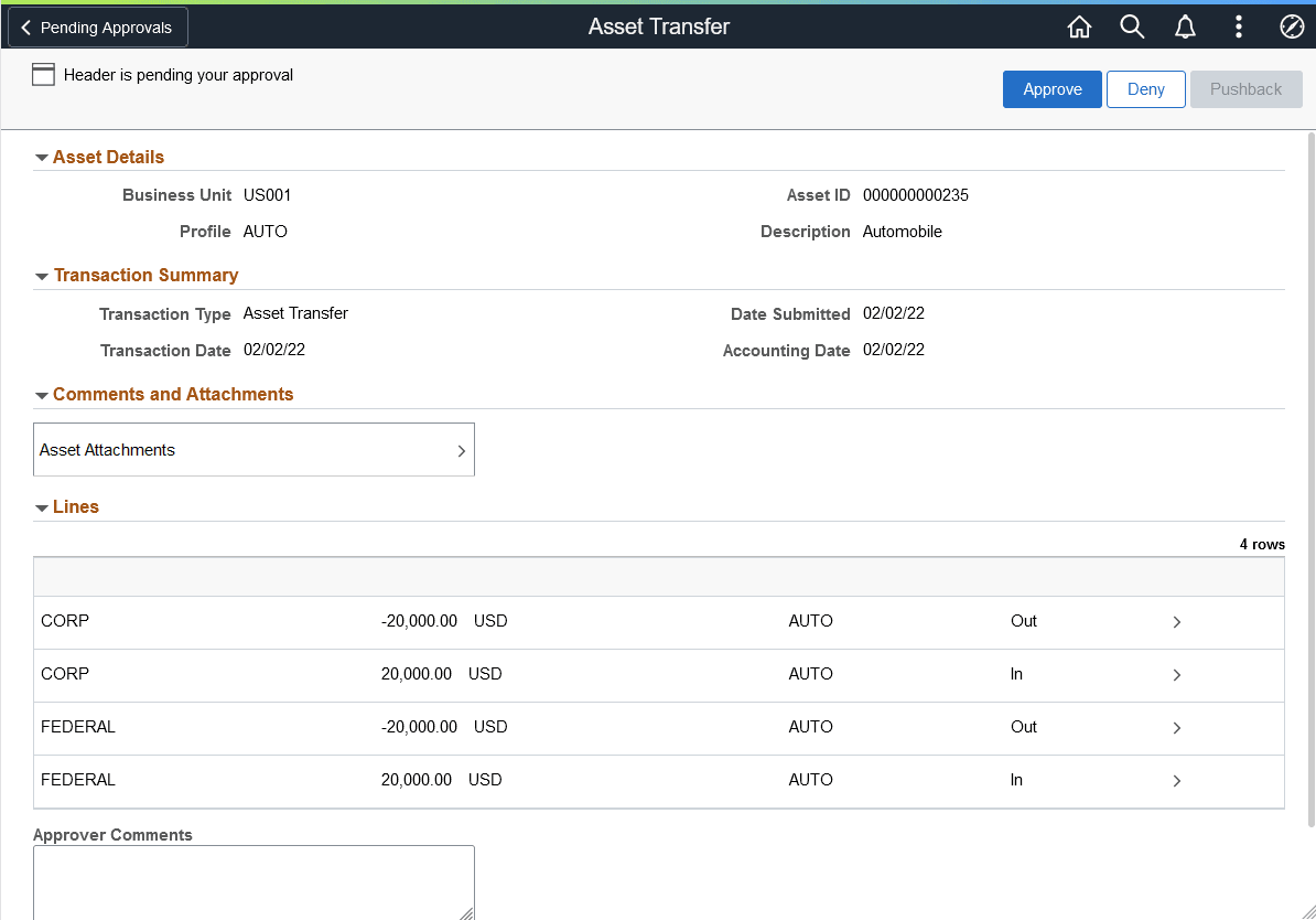

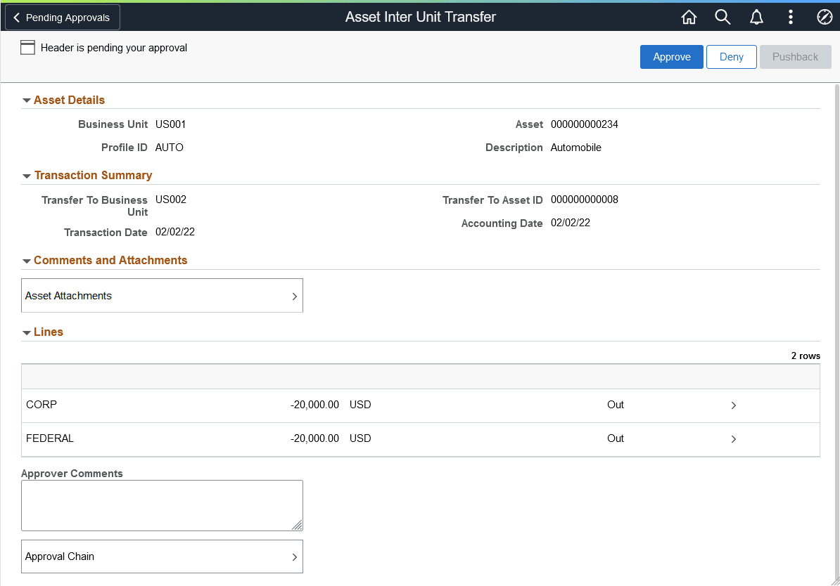

Asset Inter Unit Transfer - Approval Header Detail Page
EOAWMA_TXNHDTL_FL
View asset inter unit transfer summary and line detail information, and approve, push back, or deny the transfer.

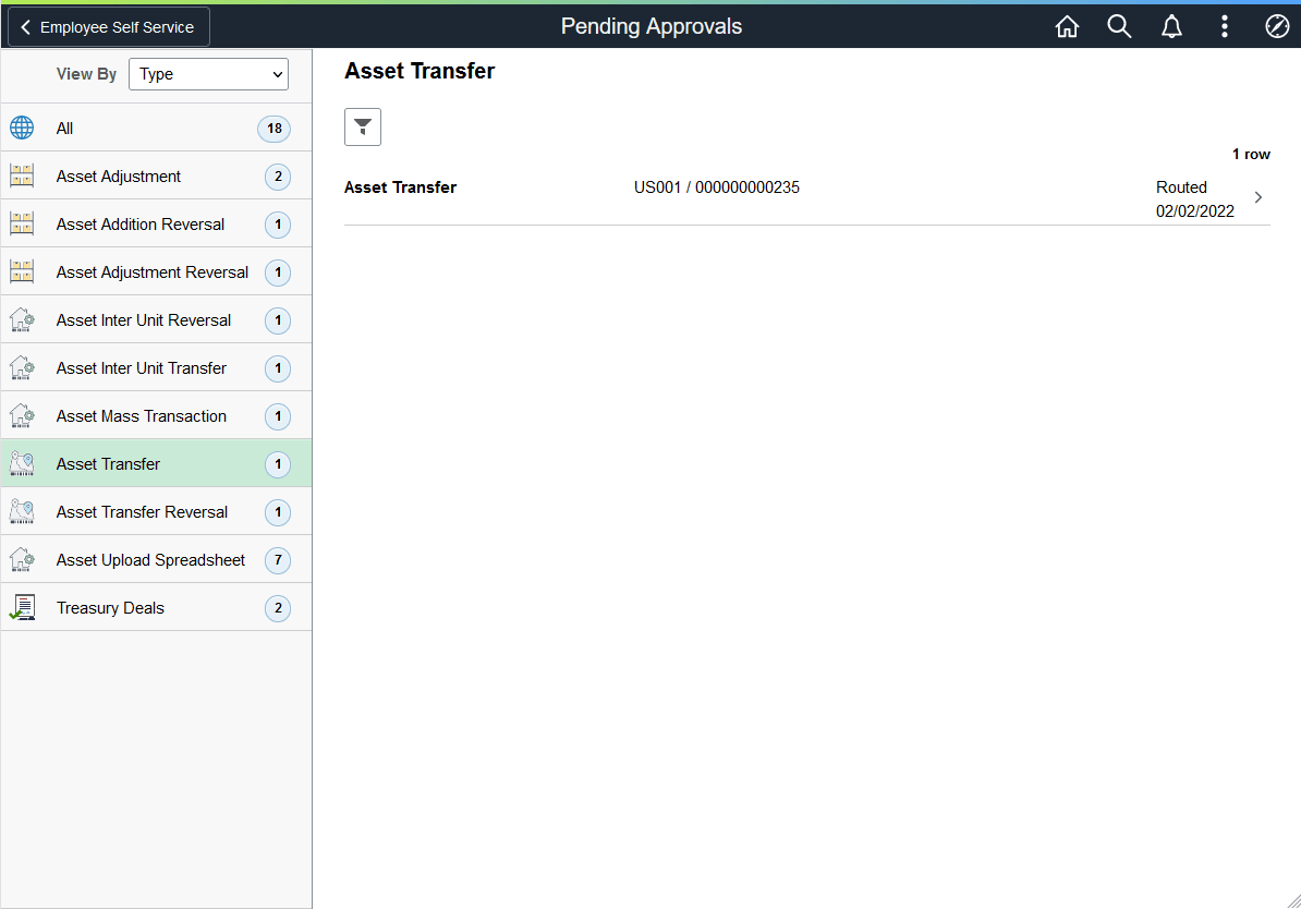

Pending Approvals - Asset Transfer Page
EOAWMA_MAIN_FL
View a list of all asset transfers that are pending your approval.
Asset Transfer - Approval Header Detail Page
EOAWMA_TXNHDTL_FL
View asset transfer summary and line detail information, and approve, push back, or deny the transfer.

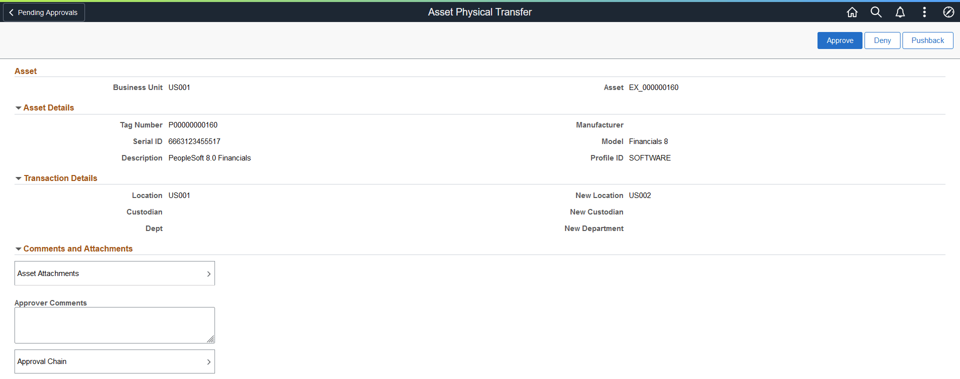

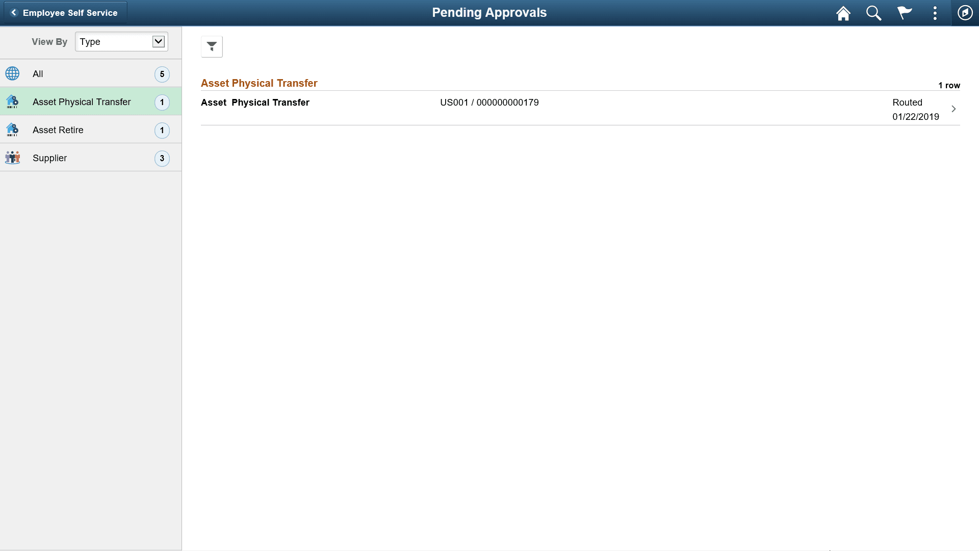

Pending Approvals - Asset Physical Transfer page
EOAWMA_MAIN_FL
View a list of all asset physical transfers that are pending your approval.
Asset Physical Transfer - Header Detail page
EOAWMA_TXNHDTL_FL
View asset physical transfer summary and asset and transaction details, and approve, push back, or deny the transfer.

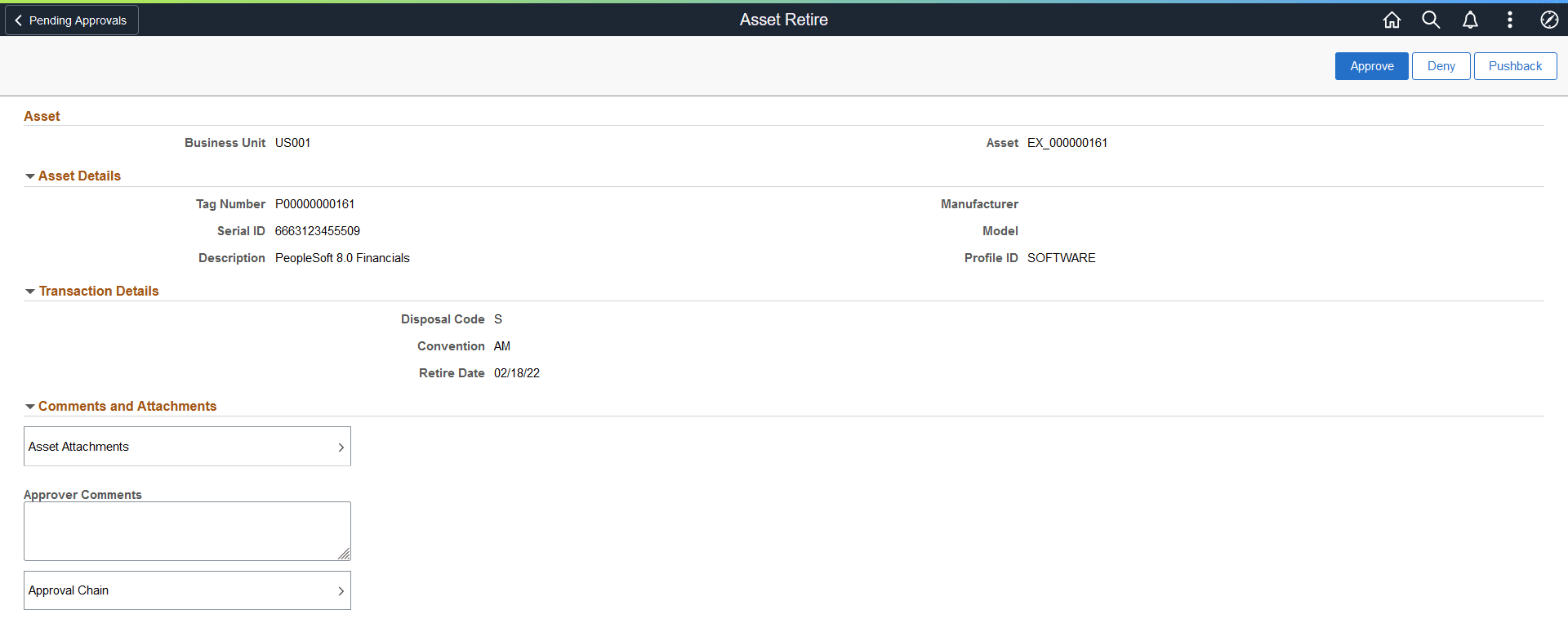

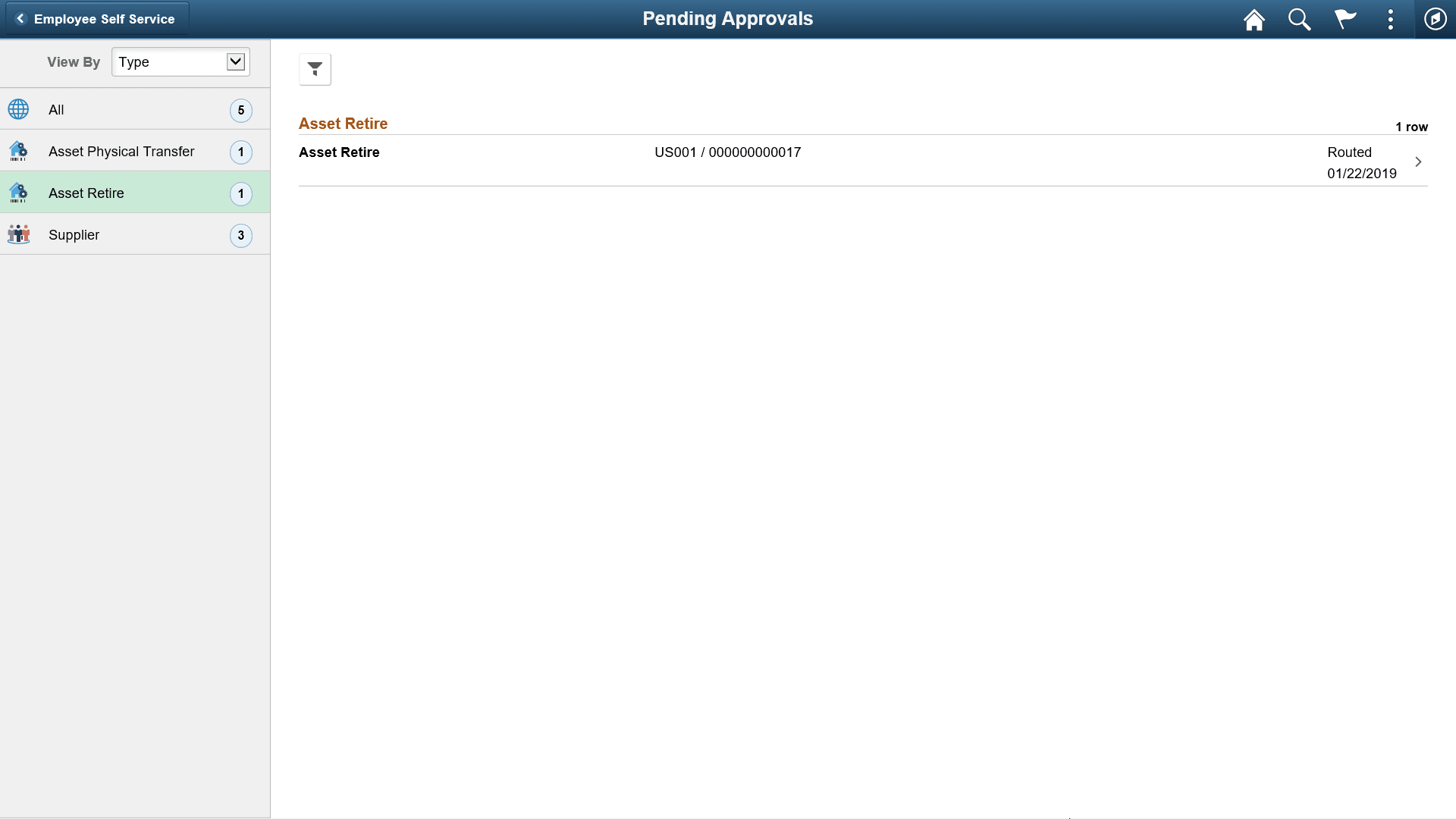

Pending Approvals - Asset Retire Page
EOAWMA_MAIN_FL
View a list of asset retirement requests routed to you and approve or deny an asset retire request.
Asset Retire - Header Detail page
EOAWMA_TXNHDTL_FL
View the asset and transaction details, and approve, push back, or deny the asset retirement request.

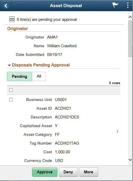

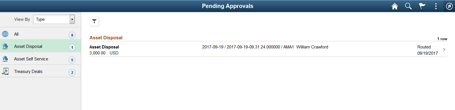

Pending Approvals - Asset Disposal Page
EOAWMA_MAIN_FL
Approve or deny an asset disposal request.
Asset Disposal - Approval Header Detail Page
EOAWMA_TXNHDTL_FL
View the details of the originator, who requested the asset disposal and approve, deny, push back, or hold an asset disposal request.

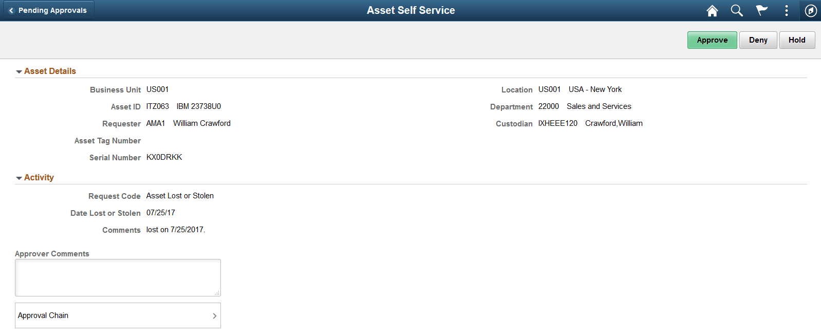

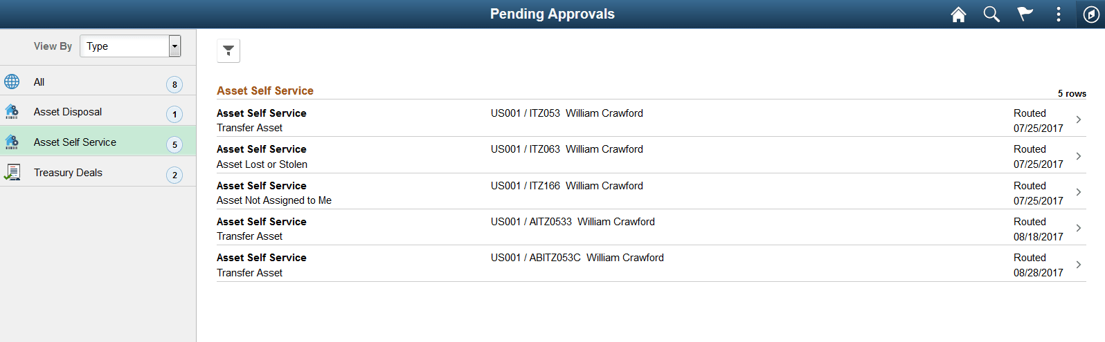

Pending Approvals - Asset Self Service Page
EOAWMA_MAIN_FL
View a list of all asset self service that are pending approval.
Asset Self Service - Approval Header Details Page
EOAWMA_TXNHDTL_FL
View the list of asset self service requests routed for approval, asset details, activity details, and approve, deny, or hold self service approval requests.

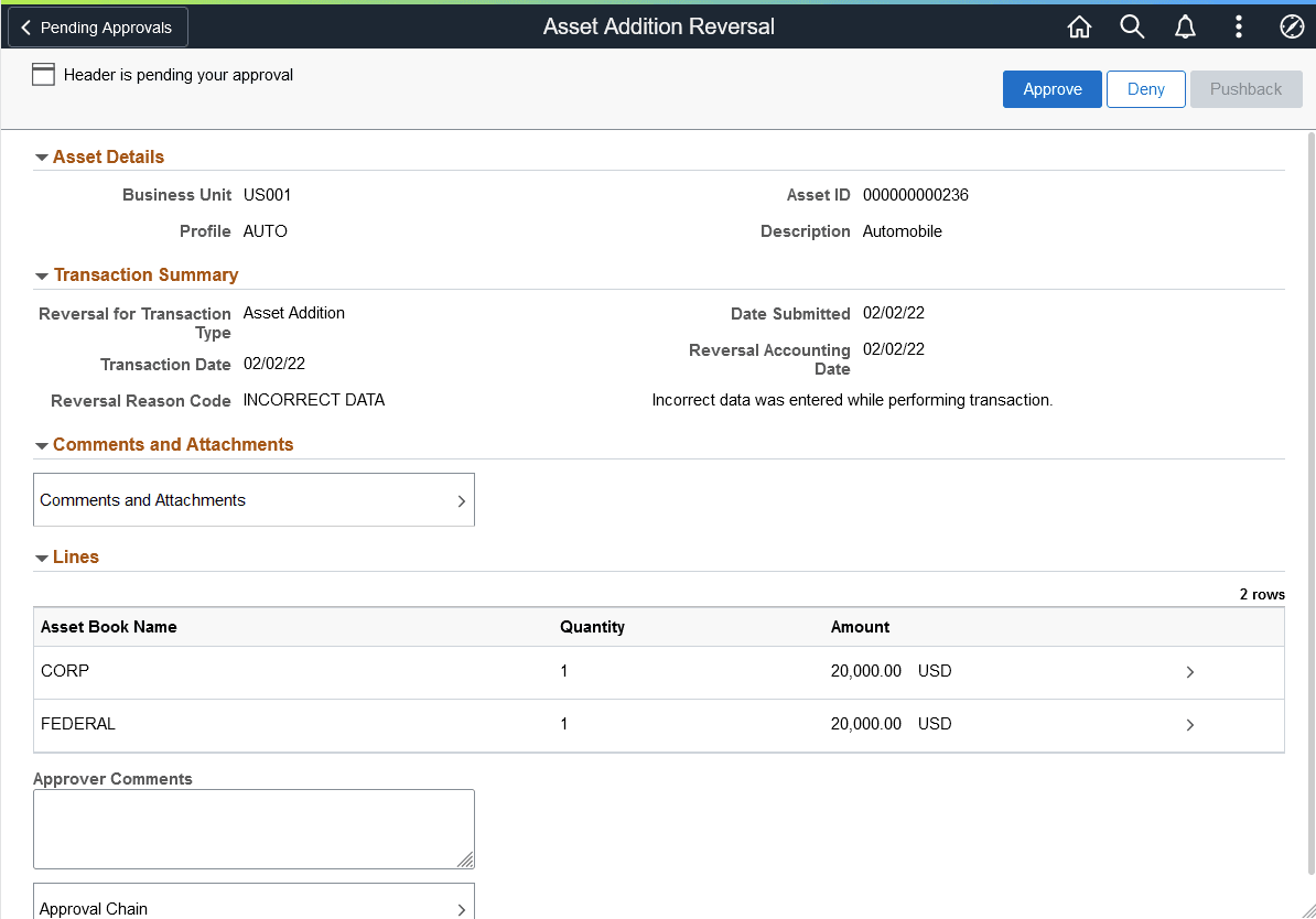

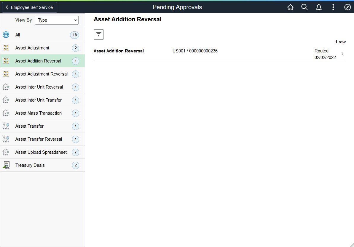

Pending Approvals - Asset Addition Reversal Page
EOAWMA_MAIN_FL
View a list of all asset addition reversals that are pending your approval.
Asset Addition Reversal - Approval Header Detail Page
EOAWMA_TXNHDTL_FL
View asset addition reversal summary and line detail information, and approve, push back, or deny the addition reversal.

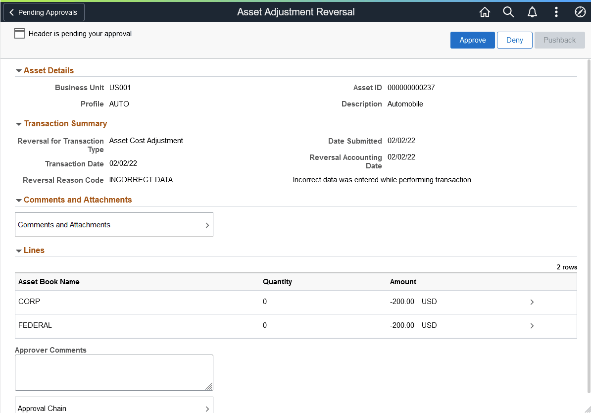

Pending Approvals - Asset Adjustment Reversal Page
EOAWMA_MAIN_FL
View a list of all asset adjustment reversals that are pending your approval.
Asset Adjustment Reversal - Approval Header Detail Page
EOAWMA_TXNHDTL_FL
View asset adjustment reversal summary and line detail information, and approve, push back, or deny the adjustment reversal.

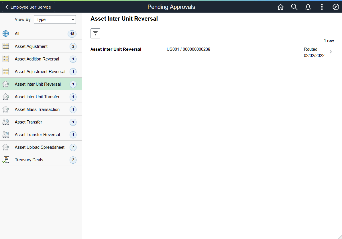

Pending Approvals - Asset InterUnit Reversal Page
EOAWMA_MAIN_FL
View a list of all asset interunit reversals that are pending your approval.

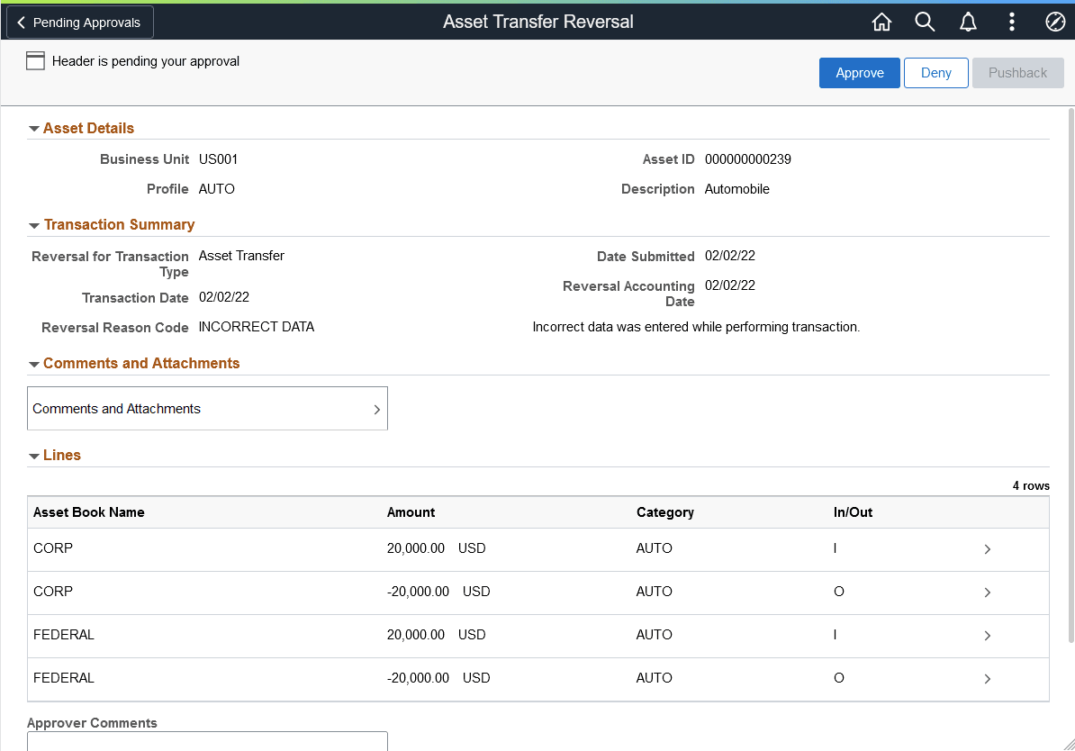

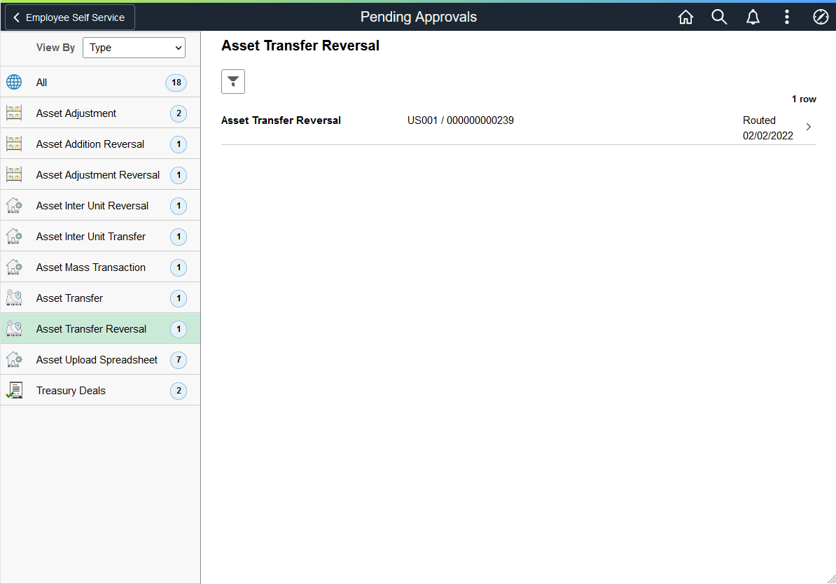

Pending Approvals - Asset Transfer Reversal Page
EOAWMA_MAIN_FL
View a list of all asset transfer reversals that are pending your approval.
Asset Transfer Reversal - Approval Header Detail Page
EOAWMA_TXNHDTL_FL
View asset transfer reversal summary and line detail information, and approve, push back, or deny the transfer reversal.

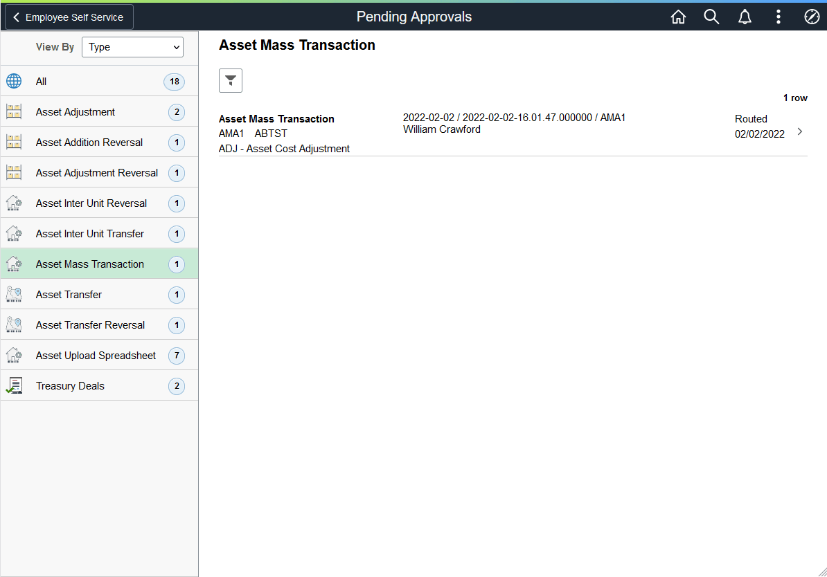

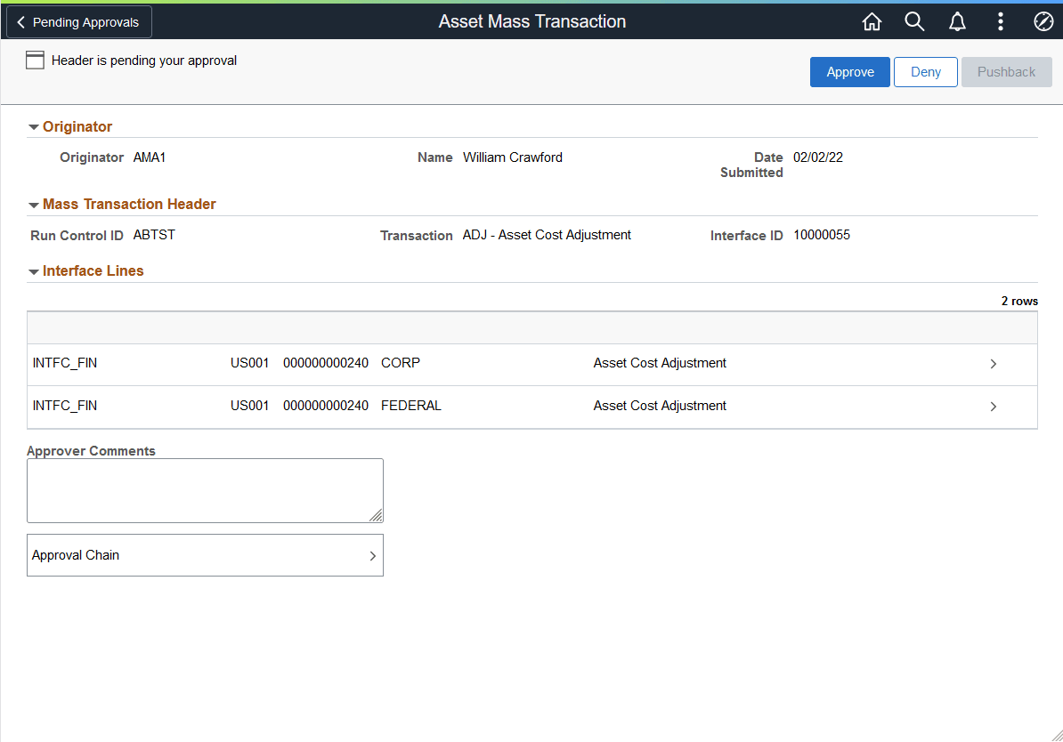

Pending Approvals - Asset Mass Transaction Page
EOAWMA_MAIN_FL
View a list of all asset mass transactions that are pending your approval.
Asset Mass Transaction - Approval Header Detail Page
EOAWMA_TXNHDTL_FL
View asset mass transaction summary and interface line detail information, and approve, push back, or deny the mass transaction.

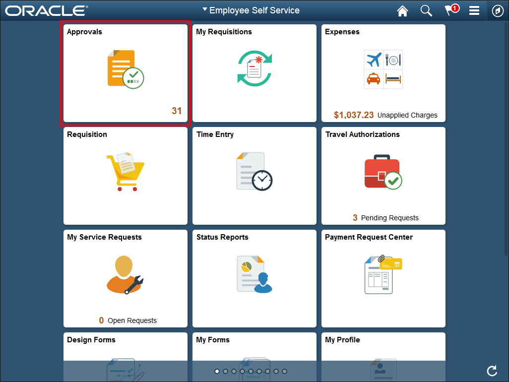

Approvers can access the pending approvals using the Approvals tile:
Approvals tile in the Fluid User Interface
Approvals tile

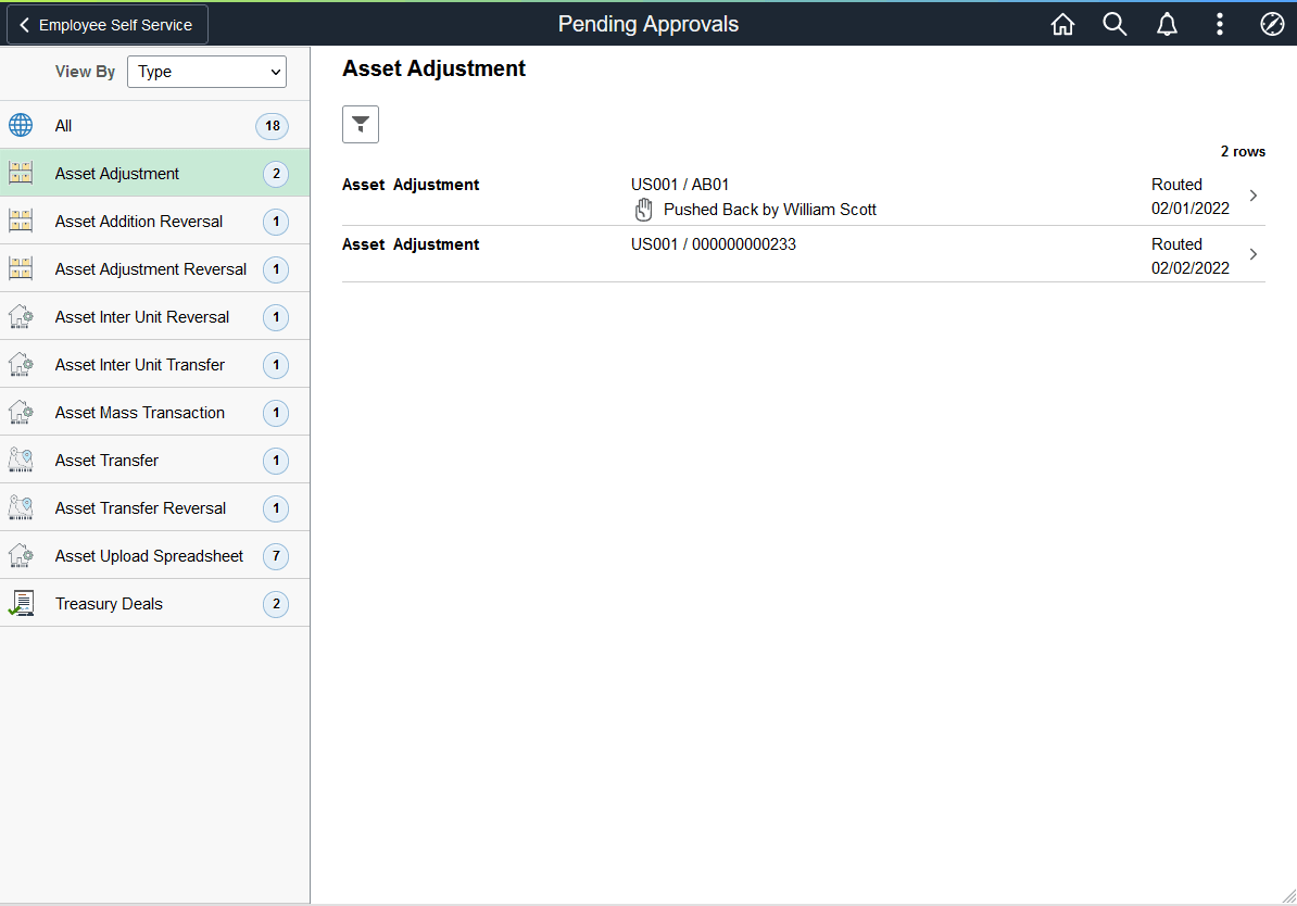

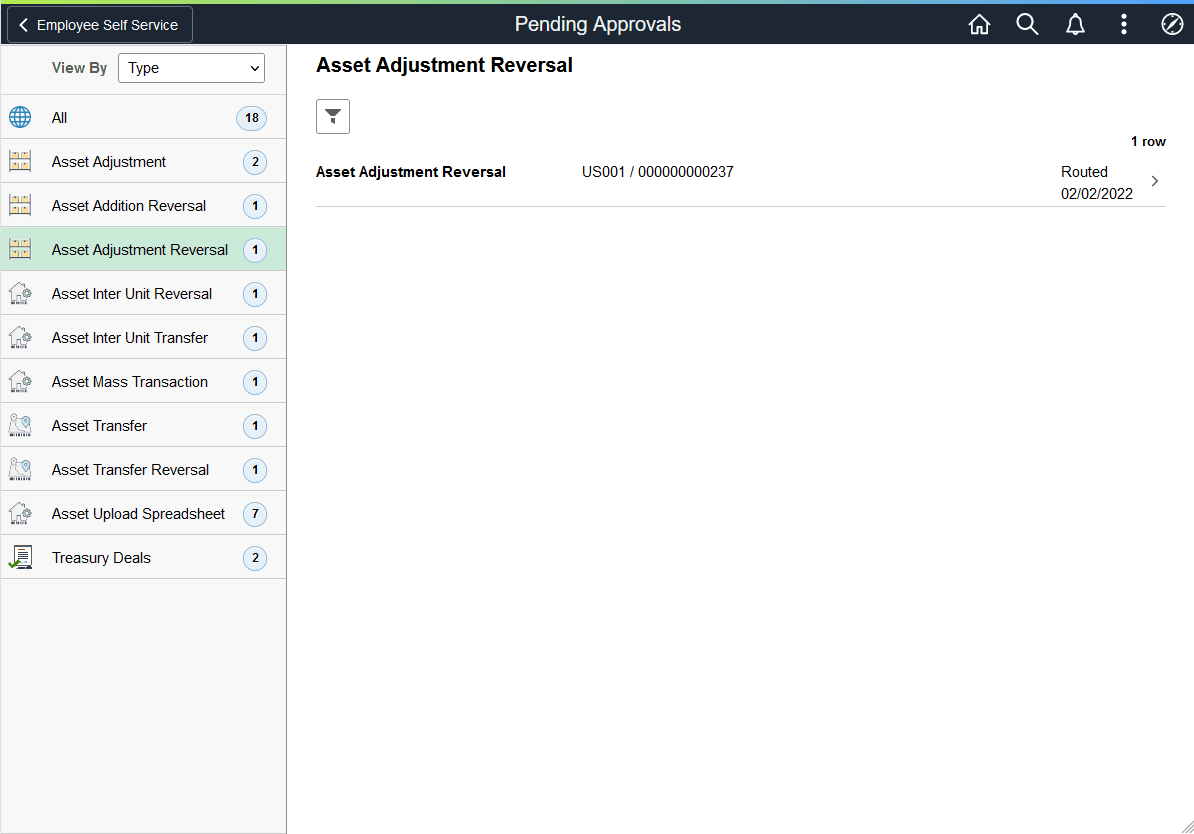

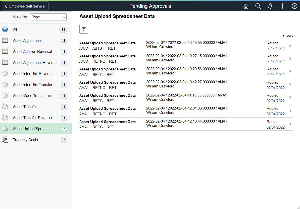

Pending Approvals - Asset Adjustment Page
Use the Pending Approvals - Asset Adjustment page (EOAWMA_MAIN_FL) to view a list of all asset adjustment transactions that are pending your approval.
Navigation:
Approvals (tile), and then Select Asset Adjustment in the approval list panel on the left side of the page.
This example illustrates the fields and controls on the Pending Approvals - Asset Adjustment page.
Select the Filter button to access the Filters page. Use the filter to refine the results displayed in the pending approvals list.
Select an Asset Adjustment row to access the Asset Adjustment - Approval Header Detail page and review adjustment details. You can also approve or deny the adjustment from this page.

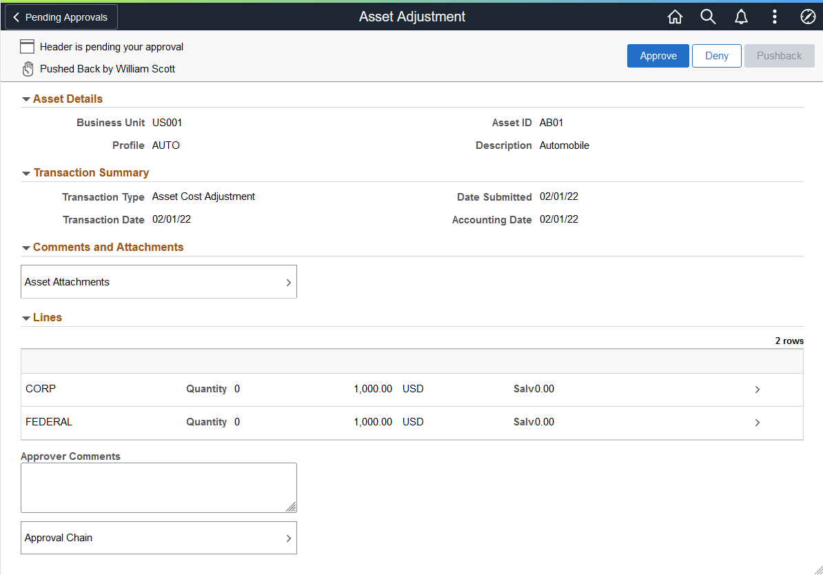

Asset Adjustment - Approval Header Detail Page
Use the Asset Adjustment - Approval Header Detail page (EOAWMA_TXNHDTL_FL) to view asset adjustment, line summary, and line detail information, and approve, push back, or deny the adjustment.
Navigation:
Select an Asset Adjustment row from the Pending Approvals - Asset Adjustment page.
This example illustrates the fields and controls on the Asset Adjustment - Approval Header Detail page.
Review asset adjustment, transaction summary, and line summary information, then select a row in the Lines grid to access the Approval Line Detail page and view line details.

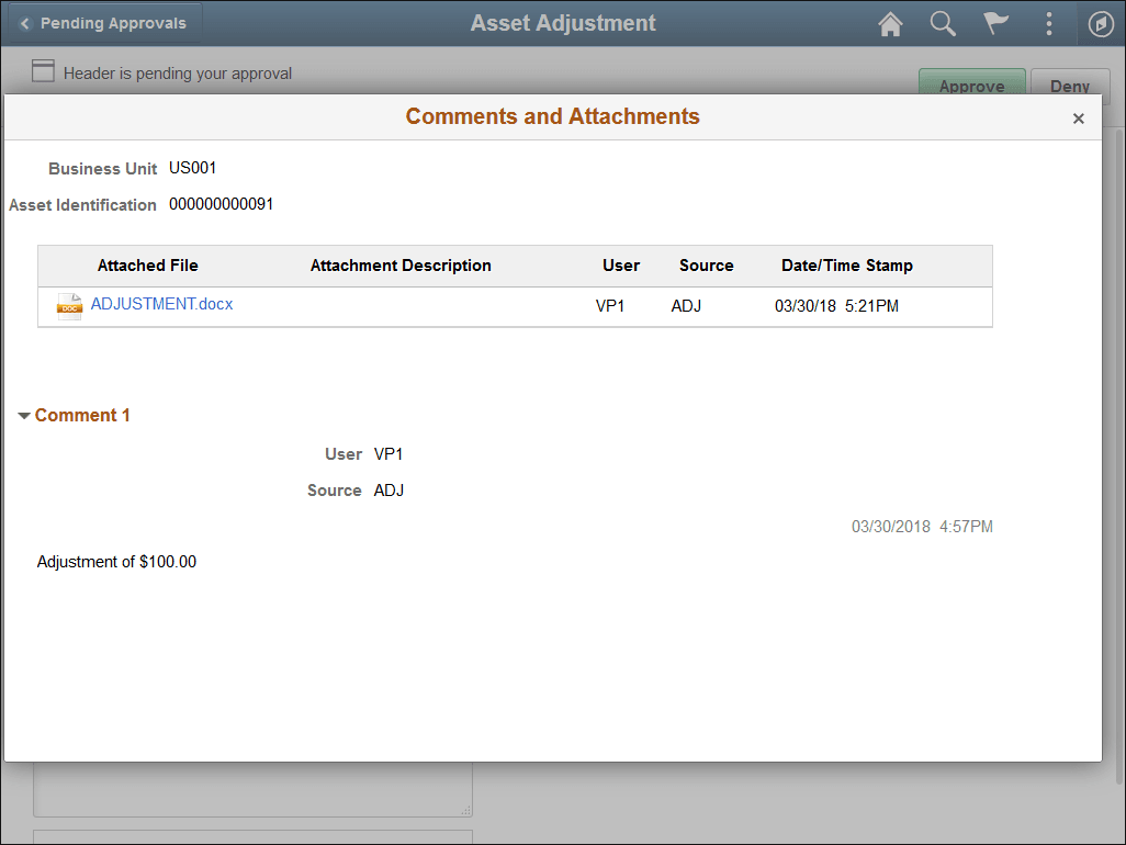

Select Asset Attachments to access the Comments and Attachments pagelet and view comments and attachments related to the asset for approval.
Select Approval Chain to access the Approval Chain pagelet and view the approval hierarchy.
Asset Adjustment - Comments and Attachments Page
Use the Asset Adjustment - Comments and Attachments page to view comments and attachments related to the asset for approval.
This example illustrates the fields and controls on the Asset Adjustment - Comments and Attachments page.
Asset Adjustment Approval Header Detail - Comments and Attachments secondary page
Use the Pending Approvals - Asset Inter Unit Transfer page (EOAWMA_MAIN_FL) to view a list of all asset inter unit transfers that are pending your approval.
Navigation:
Approvals (tile), and then Select Asset Inter Unit Transfer in the approval list panel on the left side of the page.
This example illustrates the fields and controls on the Pending Approvals - Asset Inter Unit Transfer page.
Select an Asset Inter Unit Transfer row to access the Asset Inter Unit Transfer - Approval Header Detail page and review transfer details. You can also approve or deny the transfer from this page.
Use the Asset Inter Unit Transfer - Approval Header Detail page (EOAWMA_TXNHDTL_FL) to view asset transfer, line summary, and line detail information, and approve, push back, or deny the transfer.
Navigation:
Select an Asset Inter Unit Transfer row from the Pending Approvals - Asset Inter Unit Transfer page.
This example illustrates the fields and controls on the Asset Inter Unit Transfer - Approval Header Detail page.
Review asset transfer, transaction summary, and line summary information, then select a row in the Lines grid to access the Approval Line Detail page and view line details.
Select a row in the Lines grid to access the Approval Line Details page.
This example illustrates the fields and controls on the Asset Inter Unit Transfer - Approval Line Detail page.

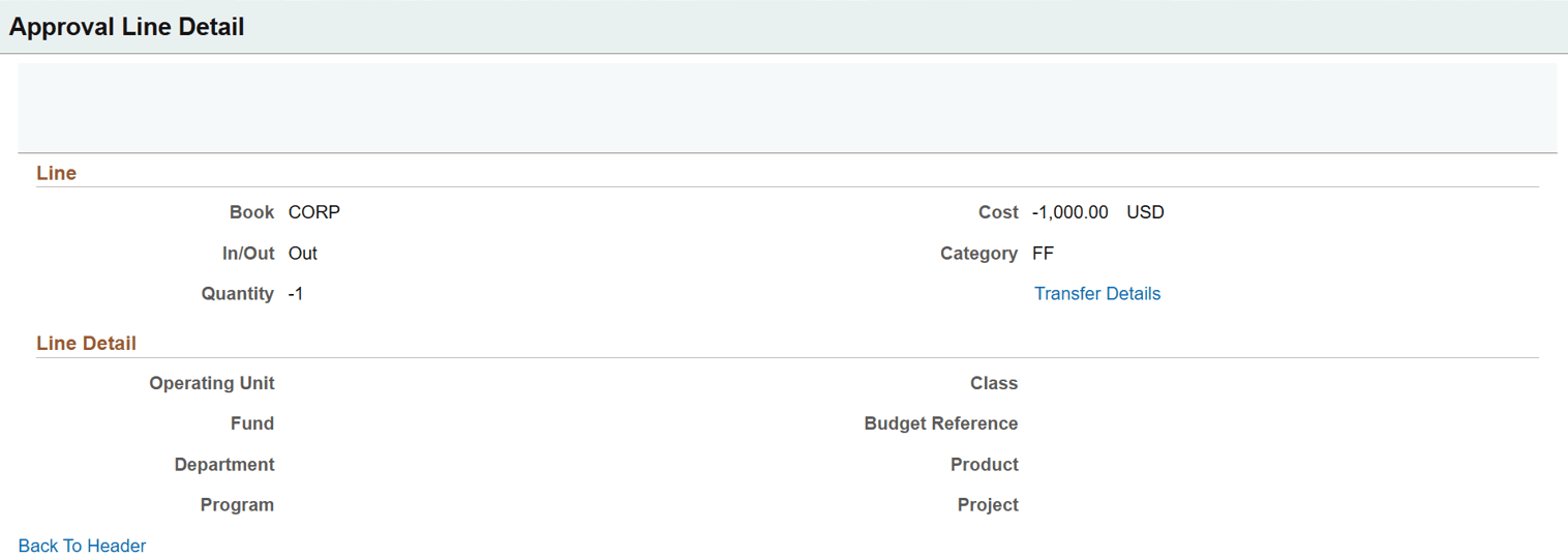

Select Transfer Details link to view the Inter Unit Transfer In/Out Chartfield details.
This example illustrates the fields on the View Asset Transfer Details page.
Use the Pending Approvals - Asset Transfer page (EOAWMA_MAIN_FL) to view a list of all asset transfers that are pending your approval.
Navigation:
Approvals (tile), and then Select Asset Transfer in the approval list panel on the left side of the page.
This example illustrates the fields and controls on the Pending Approvals - Asset Transfer page.
Select an Asset Transfer row to access the Asset Transfer - Approval Header Detail page and review transfer details. You can also approve or deny the transfer from this page.
Use the Asset Transfer - Approval Header Detail page (EOAWMA_TXNHDTL_FL) to view asset transfer, line summary, and line detail information, and approve, push back, or deny the transfer.
Navigation:
Select an Asset Transfer row from the Pending Approvals - Asset Transfer page.
This example illustrates the fields and controls on the Asset Transfer - Approval Header Detail page.
Use the Asset Physical Transfer page (EOAWMA_MAIN_FL) to view a list of physical asset transfers that are pending your approval.
Navigation:
Approvals (tile) > Select Asset Physical Transfer in the approval list panel on the left side of the page.
This example illustrates the fields and controls on the Pending Approvals - Asset Physical Transfer page. You can find definitions for the fields and controls later on this page.
Select an asset physical transfer row to access the Asset Physical Transfer - Approval Header Detail page and review transfer details. You can also approve or deny the transfer from this page.
Use the Asset Physical Transfer - Approval Header Detail page (EOAWMA_TXNHDTL_FL) to view asset and transaction details, and approve, push back, or deny the transfer.
Navigation:
Select an asset physical transfer row from the Pending Approvals - Asset Physical Transfer page.
This example illustrates the fields and controls on the Asset Physical Transfer - Header Detail page. You can find definitions for the fields and controls later on this page.
The Transaction Details section displays the current and new location details. On final approval, the new location details replace the current values.
Use the Asset Retire page (EOAWMA_MAIN_FL) to view a list of asset retirement requests routed to you. It deals with transactions submitted from Asset Transactions fluid component.
Navigation:
Approvals (tile) > Select Asset Retire in the approval list panel on the left side of the page.
This example illustrates the fields and controls on the Pending Approvals - Asset Retire page. You can find definitions for the fields and controls later on this page.
Select an asset retire row to review the details and approve or deny the request.
Use the Asset Retire - Header Detail page (EOAWMA_TXNHDTL_FL) to view the asset and transaction details, and approve, push back, or deny the asset retirement request.
Navigation:
Select an asset retire request row from the Pending Approvals - Asset Retire page.
This example illustrates the fields and controls on the Asset Retire - Header Detail page. You can find definitions for the fields and controls later on this page.
Before you approve or deny the request, check the details, enter any comments in the Approver Comments text field, and select Approval Chain to view the approval hierarchy.
Use the Asset Disposal page (EOAWMA_MAIN_FL) to approve or deny an asset disposal request. It deals with transactions submitted from Disposal Worksheet.
Navigation:
Approvals (tile), and then Select Asset Disposal in the left pane.
This example illustrates the fields and controls on the Pending Approvals – Asset Disposal page. You can find definitions for the fields and controls later on this page.
Asset Disposal page fluid
Select a row in the Asset Disposal grid to access the Asset Disposal – Approval Header Detail page and review the transaction details. The page provides you the options to approve, deny, push back, or hold an asset disposal request.

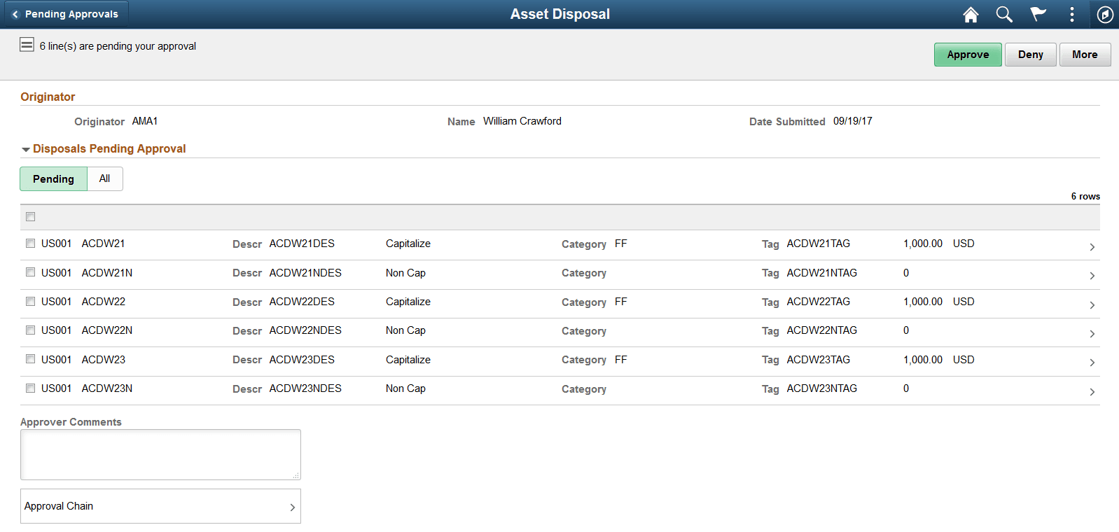

Use the Asset Disposal – Approval Header Detail page (EOAWMA_TXNHDTL_FL) to view the details of the originator, who requested the asset disposal and approve, deny, push back, or hold an asset disposal request.
Navigation:
Select an Asset Disposal row from the Pending Approvals - Asset Disposal page.
This example illustrates the fields and controls on the Asset Disposals- Approval Header Detail page. You can find definitions for the fields and controls later on this page.
Asset Disposal Approval Header Details Page Fluid
This example illustrates the fields and controls on the Asset Disposals- Approval Header Detail page as displayed on a smartphone. You can find definitions for the fields and controls later on this page.
Fluid Asset Disposal Approval Header Details Page Smartphone
Select a row in the Disposals Pending Approvals grid to view the Approval Line Detail page and view the asset and retirement information. Review the details and select the desired approval action. You can also select all the rows pending approval and proceed to the desired approval action. The approval actions include:
Field or Control Description
Hold
Places the approval request on hold. The approval status remains as On Hold until the approver acts on the request.
Enter any comments in the Approver Comments text field.
Select Approval Chain to view the approval hierarchy.
See Approving Disposals.
Use the Pending Approvals - Asset Self Service page (EOAWMA_MAIN_FL) to view a list of all asset self service that are pending approval.
Navigation:
Approvals (tile), and then Select Asset Self Service in the left pane.
This example illustrates the fields and controls on the Pending Approvals – Asset Self Service page. You can find definitions for the fields and controls later on this page.
Select a row in the Asset Self Service grid to access the Asset Self Service – Approval Header Details page and review the transaction details before you select the approval action.
Use the Asset Self Service – Approval Header Details page (EOAWMA_TXNHDTL_FL) to view the list of asset self service requests routed for approval, asset details, activity details, and approve, deny, or hold self service approval requests.
Navigation:
Select an Asset Self Service row from the Pending Approvals - Asset Self Service page.
This example illustrates the fields and controls on the Asset Self Service – Approval Header Details page. You can find definitions for the fields and controls later on this page.
Asset Self Service Approval Header Details Page
Review asset details and activity before you act on the request. The approval actions include:
Hold
Places the request on hold. The approval status remains as On Hold until the approver acts on the request.
Enter comments in the Approver Comments text box.
Use the Pending Approvals - Asset Addition Reversal page (EOAWMA_MAIN_FL) to view a list of all asset addition reversals that are pending your approval.
Navigation:
Approvals (tile), and then Select Asset Addition Reversal in the approval list panel on the left side of the page.
This example illustrates the fields and controls on the Pending Approvals - Asset Addition Reversal page.
Select an Asset Addition Reversal row to access the Asset Addition Reversal - Approval Header Detail page and review addition reversal details. You can also approve or deny the transfer from this page.
Use the Asset Addition Reversal - Approval Header Detail page (EOAWMA_TXNHDTL_FL) to view asset addition reversal, line summary, and line detail information, and approve, push back, or deny the addition reversal.
Navigation:
Select an Asset Addition Reversal row from the Pending Approvals - Asset Addition Reversal page.
This example illustrates the fields and controls on the Asset Addition Reversal - Approval Header Detail page.
Review asset addition reversal, transaction summary, and line summary information, then select a row in the Lines grid to access the Approval Line Detail page and view line details.
Use the Pending Approvals - Asset Adjustment Reversal page (EOAWMA_MAIN_FL) to view a list of all asset adjustment reversals that are pending your approval.
Navigation:
Approvals (tile), and then Select Asset Adjustment Reversal in the approval list panel on the left side of the page.
This example illustrates the fields and controls on the Pending Approvals - Asset Adjustment Reversal page.
Select an Asset Adjustment Reversal row to access the Asset Adjustment Reversal - Approval Header Detail page and review adjustment reversal details. You can also approve or deny the adjustment reversal from this page.
Use the Asset Adjustment Reversal - Approval Header Detail page (EOAWMA_TXNHDTL_FL) to view asset adjustment reversal, line summary, and line detail information, and approve, push back, or deny the adjustment reversal.
Navigation:
Select an Asset Adjustment Reversal row from the Pending Approvals - Asset Adjustment Reversal page.
This example illustrates the fields and controls on the Asset Adjustment Reversal - Approval Header Detail page.
Review asset adjustment reversal, transaction summary, and line summary information, then select a row in the Lines grid to access the Approval Line Detail page and view line details.
Use the Pending Approvals - Asset InterUnit Reversal page (EOAWMA_MAIN_FL) to view a list of all asset interunit reversals that are pending your approval.
Navigation:
Approvals (tile), and then Select Asset InterUnit Reversal in the approval list panel on the left side of the page.
This example illustrates the fields and controls on the Pending Approvals - Asset InterUnit Reversal page.
Pending Approvals - Asset Interunit Reversal page

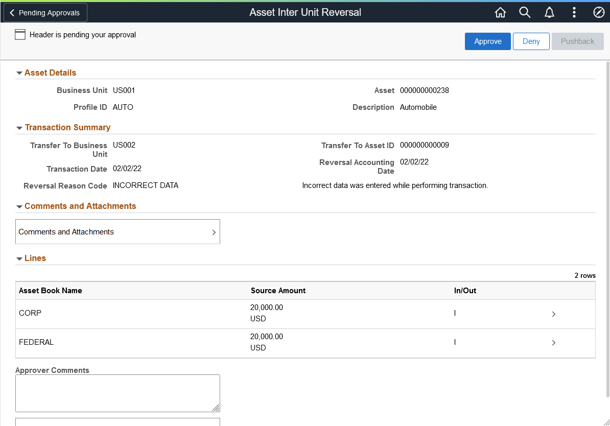

Asset InterUnit Reversal - Approval Header Detail Page
Use the Asset InterUnit Reversal - Approval Header Detail page (EOAWMA_TXNHDTL_FL) to view asset interunit reversal, line summary, and line detail information, and approve, push back, or deny the interunit reversal.
Navigation:
Select an Asset InterUnit Reversal row from the Pending Approvals - Asset InterUnit Reversal page.
This example illustrates the fields and controls on the Asset InterUnit Reversal - Approval Header Detail page.
Review asset interunit reversal, transaction summary, and line summary information, then select a row in the Lines grid to access the Approval Line Detail page and view line details.
Use the Pending Approvals - Asset Transfer Reversal page (EOAWMA_MAIN_FL) to view a list of all asset transfer reversals that are pending your approval.
Navigation:
Approvals (tile), and then Select Asset Transfer Reversal in the approval list panel on the left side of the page.
This example illustrates the fields and controls on the Pending Approvals - Asset Transfer Reversal page.
Pending Approvals - AssetTransfer Reversal page
Select an Asset Transfer Reversal row to access the Asset Transfer Reversal - Approval Header Detail page and review transfer reversal details. You can also approve or deny the transfer reversal from this page.
Use the Asset Transfer Reversal - Approval Header Detail page (EOAWMA_TXNHDTL_FL) to view asset transfer reversal, line summary, and line detail information, and approve, push back, or deny the transfer reversal.
Navigation:
Select an Asset Transfer Reversal row from the Pending Approvals - Asset Transfer Reversal page.
This example illustrates the fields and controls on the Asset Transfer Reversal - Approval Header Detail page.
Review asset transfer reversal, transaction summary, and line summary information, then select a row in the Lines grid to access the Approval Line Detail page and view line details.
Use the Pending Approvals - Asset Mass Transaction page (EOAWMA_MAIN_FL) to view a list of all asset mass transactions that are pending your approval.
Navigation:
Approvals (tile), and then Select Asset Mass Transaction in the approval list panel on the left side of the page.
This example illustrates the fields and controls on the Pending Approvals - Asset Mass Transaction page.
Select an Asset Mass Transaction row to access the Asset Mass Transaction - Approval Header Detail page and review mass transaction details.
Use the Asset Mass Transaction - Approval Header Detail page (EOAWMA_TXNHDTL_FL) to view asset mass transaction, interface line summary, and line detail information, and approve, push back, or deny the mass transaction.

Select an Asset Mass Transaction row from the Pending Approvals - Asset Mass Transaction page.
This example illustrates the fields and controls on the Asset Mass Transaction - Approval Header Detail page.
Review asset mass transaction and interface line summary information, then select a row in the Interface Lines grid to access the Approval Line Detail page and view interface line details.
Pending Approvals - Asset Upload Spreadsheet Data
Use the Pending Approvals - Asset Upload Spreadsheet Data page (EOAWMA_MAIN_FL) to view a list of all spreadsheet asset upload transactions that are pending your approval.
Navigation:
Approvals (tile), and then Select Asset Upload Spreadsheet Data in the approval list panel on the left side of the page.
Pending Approvals - Asset Upload Spreadsheet page
Select an Asset Upload Spreadsheet Data row to access the Asset Upload Spreadsheet Data - Approval Header Detail page and review asset upload details.

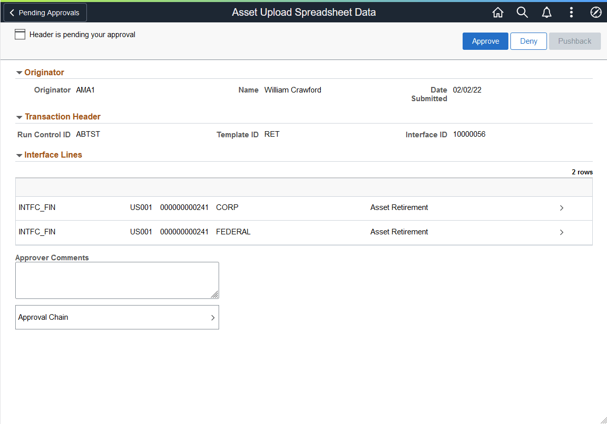

Asset Upload Spreadsheet Data - Approval Header Detail Page
Use the Asset Upload Spreadsheet Data - Approval Header Detail page (EOAWMA_TXNHDTL_FL) to view asset upload spreadsheet data, summary, and interface line detail information, and approve, push back, or deny the asset upload transaction.
Navigation:
Select Asset Upload Spreadsheet row from the Pending Approvals - Asset Upload Spreadsheet page.
Review asset upload information, then select a row in the Interface Lines grid to access the Approval Line Detail page and view line details.
