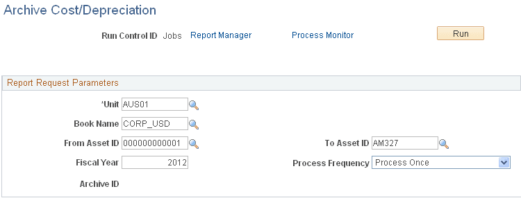

Archive Cost/Depreciation Page
Use the Archive Cost/Depreciation page (RUN_ARCHIVE) to run the Asset Archive process (AMDPARCH) to archive inactive cost and depreciation data.
Navigation:
Asset Management, Asset Transactions, History, Archive Cost/Depreciation, Archive Cost/Depreciation
Asset Management, and then Asset Transactions, and then History, and then Archive Cost/Depreciation, and then Archive Cost/Depreciation.
This example illustrates the fields and controls on the Archive Cost/Depreciation page. You can find definitions for the fields and controls later on this page.
Field or Control Description
Unit
Select the business unit from which records will be archived.
Book Name
You must archive an asset using each book it is associated with.
From Asset ID and To Asset ID
Use these fields to archive a range of asset IDs. To archive one asset, enter the asset ID in the From Asset field.
Fiscal Year
By default, the process will archive data up to the last period of the fiscal year you enter here. The fiscal year must be closed before an asset can be archived.
Archive ID
When you run the process, the system populates this field with the run control ID and stores the archive ID in the ARCHIVE_NO field on the depreciation table. You must keep a record of this archive ID if you want to restore archived data.
The Asset Archive Application Engine (AM_CSDP_ARCH) process copies inactive data from the application tables to archive tables. This process then deletes the archived data from the application tables and consolidates the rows that are left.
For cost rows, the Asset Archive process consolidates multiple cost rows of data into one row.
For depreciation rows, all the depreciation rows prior to the Fiscal Year are summed up to create one ADD row for accumulated depreciation. The archived records are stored in the depreciation history table.
