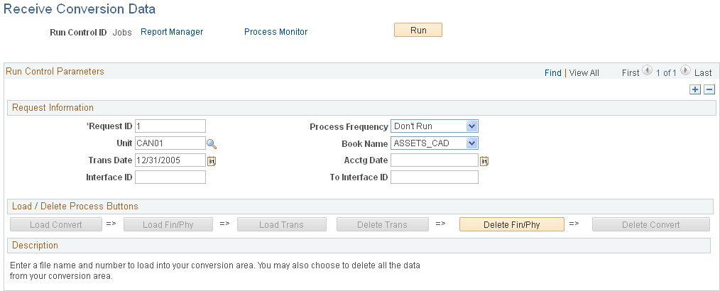

Use the Receive Conversion Data page (RUN_AMCV2000) to run the Interface Loader program to delete data from the loader tables.
Navigation:
Asset Management, and then Send/Receive Information, and then Load Interface, and then Receive Conversion Data, and then Receive Conversion Data
This example illustrates the fields and controls on the Receive Conversion Data page. You can find definitions for the fields and controls later on this page.
When the conversion is complete, you will want to release the disk space that is occupied by all the interim tables that you used in the process. Working backwards, you can delete data from the tables that were populated by using the Interface Loader.
Load/Delete Process Buttons
Select Delete Fin/Phy and run this request. Process Scheduler runs the AMCV2000 process at user-defined intervals.
