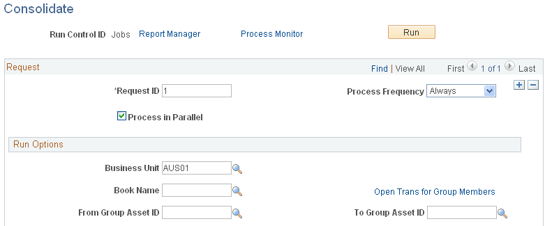

Consolidate Page
Use the Consolidate page (AMGRPCON_RQST) to Run the process that consolidates cost information for group member assets.
The process summarizes cost information of group members at the group level, based on the ChartFields that you specify on the Business Unit/Book Definition page. Run this process before calculating depreciation for group assets.
Navigation:
This example illustrates the fields and controls on the Consolidate page. You can find definitions for the fields and controls later on this page.
Accumulated depreciation for group member assets is loaded at the member asset level, and the Group Asset Consolidation (AMGRPCON) process consolidates at a group level.
