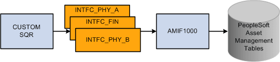

To transfer data from an existing system into PeopleSoft Asset Management loader tables, you can write a custom SQR and use the delivered Asset Management application engines in this way:
  1. Write and run a program that transfers data from the existing system into the Asset Management loader tables.
    The following table describes the interim tables in Asset Management:

  4. Use the Transaction Loader process (AMIF1000) to transfer information from the loader tables into your Asset Management tables.
    This process reads data in the INTFC_FIN, INTFC_PHY_A and INTFC_PHY_B tables and then populates the Asset Management tables with the asset data. This data appears in Asset Management as open transactions.

The following diagram shows the Asset conversion process:
