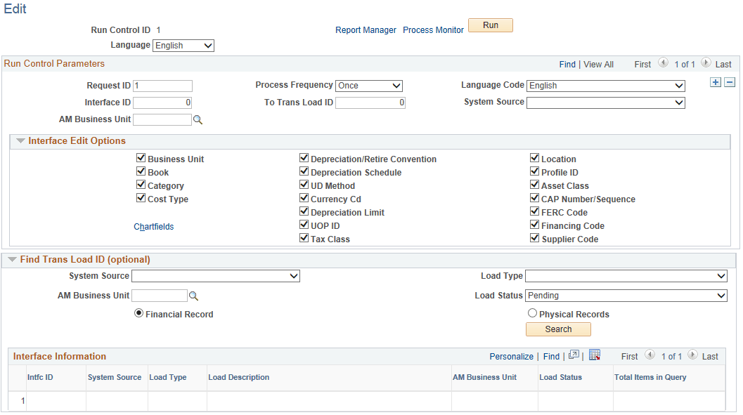

Edit Page
Use the Edit page (RUN_AMIFEDIT1) to run the Transaction Edit program.
Navigation:
Asset Management, and then Send/Receive Information, and then Interface Transactions, and then Transaction Loader Edit
This example illustrates the fields and controls on the Edit page. You can find definitions for the fields and controls later on this page.
Edit Page
Interface Edit Options
Select all the fields on which you want to perform the edit valuation. Deselect those fields that will have no values because you do not use the field (that is, optional fields Category and Tax Class.).
The default condition is to run edit checks on all of these fields. They are all selected when you first display the page. To prevent an edit check on a particular field, deselect that check box.
Find Trans Load ID (transaction load ID)
Field or Control Description
System Source
Generates the transactions that you want to edit.
Load Type
A more detailed version of Trans Type. One trans type can generate several different load types.
Whenever you rerun the Transaction Edit program, old message files from the previous run are deleted.
