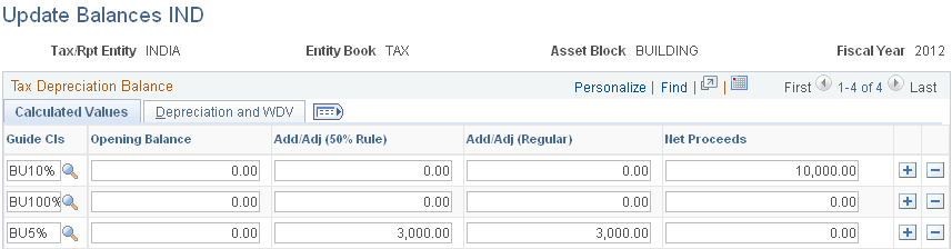

This example illustrates the fields and controls on the Tax Depr Bal page (1 of 2). You can find definitions for the fields and controls later on this page.

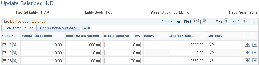

This example illustrates the fields and controls on the Tax Depr Bal page (2 of 2). You can find definitions for the fields and controls later on this page.
If your setup options have enabled manual adjustments to depreciation balances, you can access calculated balances and enter adjustments in the Manual Adjustment column. No recalculations are processed on the basis of any manual adjustment entered, but the values are added to the WDV.

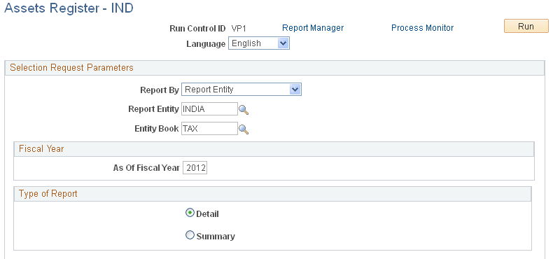

Assets Register - IND Page
Use the Assets Register - IND page (RUN_AMDP2510) to reports historical depreciation for the fiscal year.
Navigation:
Asset Management, and then Financial Reports, and then Cost and Depreciation, and then Asset Register India
This example illustrates the fields and controls on the Assets Register - IND page. You can find definitions for the fields and controls later on this page.
Field or Control Description
Selection Request Parameters
Define the parameters for the asset register to report by business unit or report entity. Complete these fields as dictated by your needs:
  • Unit.
  • Book.
  • Report Entity.
  • Entity Book.
  • As of Fiscal Year.
  • Detail or Summary (available only when you select to report by report entity).
