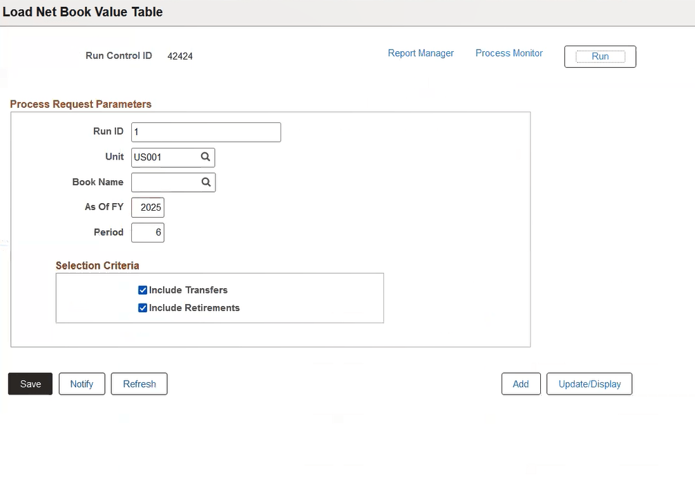

This example illustrates the fields and controls on the Net Book Value Table page. You can find definitions for the fields and controls later on this page.
Specify the as of fiscal year (in the As Of FY field) and accounting period (in the Period field).
