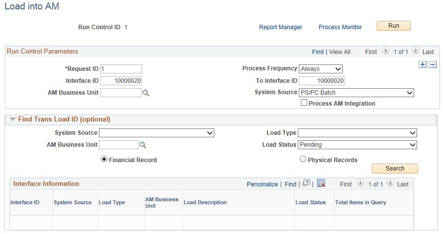

This example illustrates the fields and controls on the Load into AM page. You can find definitions for the fields and controls later on this page.
Load into AM
Locate the Find Trans Load ID (find transaction loader ID) group box.
Field or Control Description
System Source
If you do not know the transaction load IDs, enter the system source that generated the transactions that you want to load, such as AM Batch or Strategic Sourcing. Also, enter the load type.
Load Type
A load type is a more detailed version of a transaction type. One transaction type can generate several different load types.
Specify the transactions to load, such as Asset Add or Phys Add (physical addition), if you know the range of transaction load IDs. You can specify transactions by system source, from transaction load ID, and to transaction load ID.
AM Business Unit
Select a business unit if you want to limit the load process by business unit.
Load Status
Select from the following values:
  • Consolidat: (consolidated): Transactions consolidated.
  • Errored: Transaction errors.
  • Excluded: Transactions excluded.
  • In Process: Transactions in process.
  • Loaded: Transactions loaded.
  • On Hold: Transactions on hold.
  • Pending: Transactions pending.
  • Replaced: Replaced by other interface records.
  • Unitized: Transactions unitized (will not be loaded).
Financial Record or Physical Records
Select one depending on the type of transaction that you want to load.
