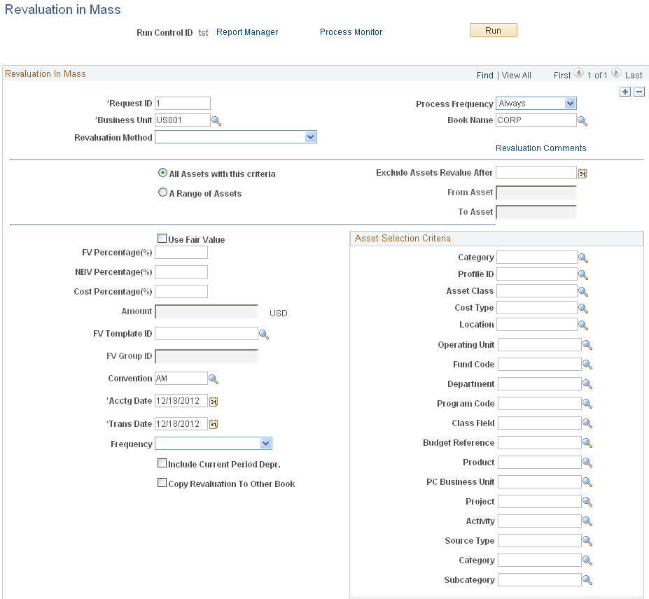

This example illustrates the fields and controls on the Revaluation en Masse page. You can find definitions for the fields and controls later on this page.
Revaluation in Mass page
