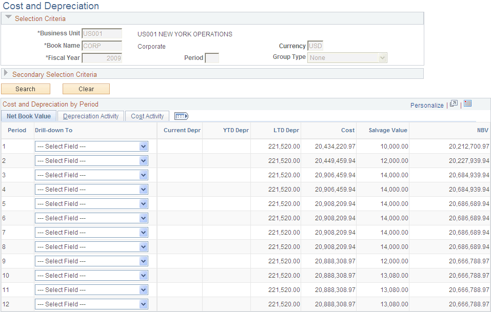

This example illustrates the fields and controls on the Cost and Depreciation page. You can find definitions for the fields and controls later on this page.
Selection Criteria
Field or Control Description
Business Unit, Book Name, Fiscal Year, and Currency
All of these values are required.
The business unit is based on the user ID options.
The book name is the default book for the business unit, if the business unit is not blank.
The fiscal year uses today's date from the calendar table, if the book name is not blank.
CurrencyThe system uses the business unit, book name base currency for the default currency.
Period
Enter the period when the expected data is of high volume and selection criteria is entered. If you leave the field blank, all periods display after performing your search.
Group Type
This field is used only when the business unit/book name uses group assets. If group assets is not defined at the installation level, Group Type will not display. Select Group Asset, Group Member, or None.

After you have entered the selection criteria and performed the search, the resulting data is summarized by period. You can now drill down on any asset to the lowest level of data that can be viewed. This option is set when you create the group ID definition. Drill down enables bidirectional summary data, so that you can drill down and go back to a previous level of data. The system displays breadcrumbs to manage your drill down layers.
Related amounts are grouped and viewed in separate tabs.
Net Book Value
Net book value includes period depreciation, year-to-date (YTD) depreciation, LTD depreciation, cost, salvage value and net book value.
