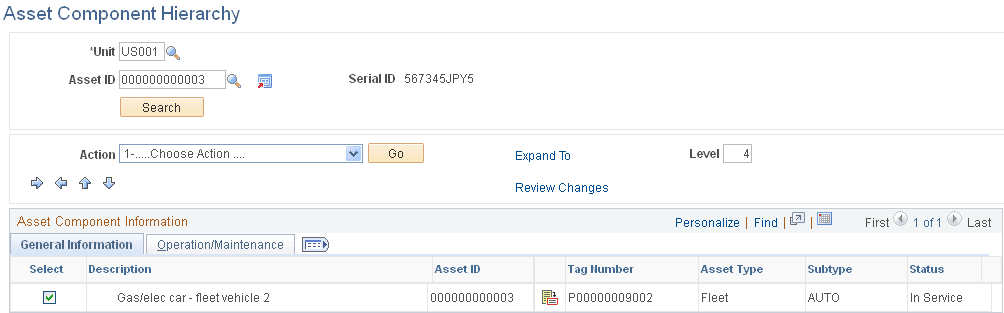

Asset Component Hierarchy Page
Use the Asset Component Hierarchy page (AM_HGRID) to View associated asset component relationships within the hierarchy (display only).
Navigation:
Asset Management, and then Asset Transactions, and then Owned Assets, and then View Component Hierarchy
This example illustrates the fields and controls on the Asset Component Hierarchy page (View). You can find definitions for the fields and controls later on this page.
This page appears as display only. Review the details within the Asset Component Hierarchy.
Field or Control Description
Action
After selecting a check box beside an asset, select one of the following actions and click the Go button:
  • Focus on Selected Row - Refresh the grid using the selected row as the starting point of the hierarchy.
  • Focus on Top Asset - Refresh the grid using the highest asset as the starting point of the hierarchy.
The View Component Hierarchy provides a subset of actions that are available within the Manage Component Hierarchy.

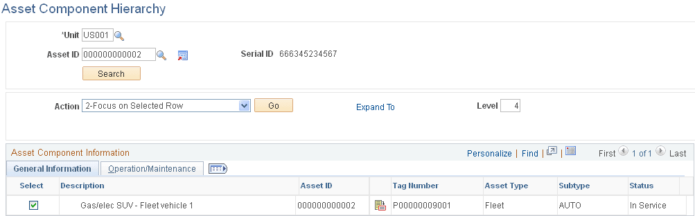

Use the Asset Component Hierarchy page (AM_HGRID) to Update associated asset component relationships by moving assets within the hierarchy.
Navigation:
Asset Management, and then Asset Transactions, and then Owned Assets, and then Manage Component Hierarchy
This example illustrates the fields and controls on the Asset Component Hierarchy page (Manage). You can find definitions for the fields and controls later on this page.
Select component assets and move them within the hierarchy. The Asset Component Hierarchy page displays up to nine levels. If the hierarchy of asset components is more than nine levels deep, you can manipulate the whole hierarchy by focusing on specific branches of the component tree.
Property asset types are not editable. When you enter a property type of asset, after clicking the Search button, the page will display as if the View Component Hierarchy was used.
Action
Choose one of the following actions:
  • Insert Asset on Row Below - Insert a row in the grid just below the selected row. When selecting the first row of the grid, the insert creates a child of the first row.
  • Remove Asset from Hierarchy - Remove the row from the grid and enter a reason for the removal on the secondary page that is provided.
Indent Row buttonIndent Row
Select that asset and click the Indent Row button. This action moves the selected asset down in the hierarchy so that it is a child of the prior row number (asset) in the grid.
Outdent Row buttonOutdent Row
Click the Outdent Row button to move the selected asset up one level in the hierarchy.
Move Item Use Sequence Up buttonMove Item Use Sequence Up
Click the Move Item Use Sequence Up button to move the indented asset up to a different parent. If the parent asset is moved, all of the child assets are moved with it.
Move Item Use Sequence Down buttonMove Item Use Sequence Down
Click the Move Item Use Sequence Down button to move the selected asset down one row level.
Expand All link
Click to expand the entire hierarchy to view and manage all assets within the grid.
Review Changes link
Click to display a summary of changes made within the asset hierarchy (Summary of Changes page.)
Comments buttonComments
Add a comment to explain the reason for the change on the Provide Reason for the Modification page.
Comments Warning iconComment Warning
Upon save, this icon indicates that there have been no comments entered for the hierarchy change.
Warning iconWarning
Upon save, this warning icon displays; mouse over text provides a detailed description of the warning for the following reasons:
  • No comment provided.
    Click the comment icon to add or update a comment.
  • Custodian information not updated.
    Select the Operation/Maintenance tab to add or update the employee ID or department.
  • Location information not updated.
    Select the Operation/Maintenance tab to add or update the location or area ID.
Row Deleted iconRow Deleted
Indicates that the row has been removed from the hierarchy.
Error iconError
Indicates an invalid use of the Component field.
Asset Search iconAsset Search
Click the Asset Search icon to search for an asset. The system searches PeopleSoft Maintenance Management (MM) assets if that product is installed. If MM is not installed, the search is directed to PeopleSoft Asset Management for retrieval.
Asset Details buttonAsset Details
Click to view asset details for the given asset. You will be directed to the Define Asset Operational Information page when PeopleSoft Maintenance Management is installed. When PeopleSoft Maintenance Management is not installed, you are directed to the Basic Add page for asset details.
Operation/Maintenance Tab
This page displays only if PeopleSoft Maintenance Management is installed. It provides the Operation/Maintenance details for the assets such as Custodian, Asset Criticality, Repairable Flag, Repair Status, VIN, Serial ID, EmplID, Department, Location Code, and Area ID.

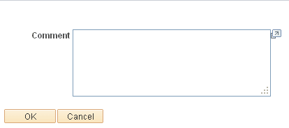

Comment Page
Use the Provide Reason for the Modification page (AM_HGRID_REASN_SEC) to Provide a reason and details for the modification.
Navigation:
Click the Comments icon from the Asset Component Hierarchy page. This icon is visible when a change is made to move an asset within the hierarchy.
This example illustrates the fields and controls on the Comment page. You can find definitions for the fields and controls later on this page.
Comment page
When a component is removed from the hierarchy, you must indicate a reason for this action. This comment page is automatically displayed and contains a reason drop down list in addition to the comment entry field. Both Reason and Comment are mandatory in the case of a removal from the hierarchy.

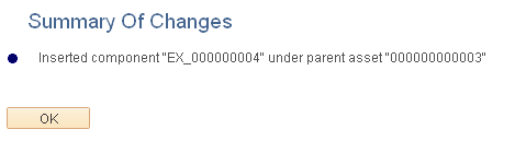

Summary of Changes Page
Use the Summary of Changes page (AM_HGRID_DISP_CHG) to Review the summary of changes made within the asset hierarchy.
Navigation:
Click the Review Changes link from the Asset Component Hierarchy page.
This example illustrates the fields and controls on the Summary of Changes page. You can find definitions for the fields and controls later on this page.

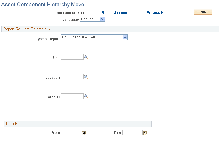

Asset Component Hierarchy Move Page
Use the Asset Component Hierarchy Move page (RUN_AMCH1000) to Run the Asset Component Hierarchy Move report to view a list of assets that were moved.
Run this report for all assets, financial assets or nonfinancial assets. (SQR)
Navigation:
Asset Management, and then Financial Reports, and then Asset Details, and then Asset Component Hierarchy Move.
This example illustrates the fields and controls on the Asset Component Hierarchy Move page. You can find definitions for the fields and controls later on this page.
Type of Report
Select to run the report for All assets, Financial Assets, or Non Financial Assets. When you select Financial Assets, the financial asset parameters appear.
