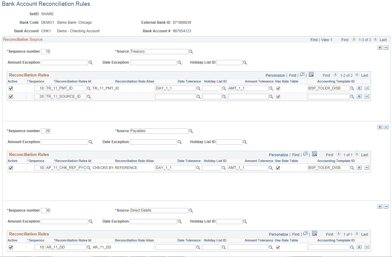

Bank Account Reconciliation Rules Page
BANK_ACCT_RCN_RULE
Assign reconciliation rules by source to a bank and bank account. The Automatic Bank Reconciliation process (BNK_RECON) uses these rules to reconcile bank statement lines with transaction lines.

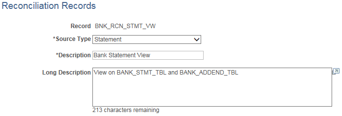

Reconciliation Records Page
Use the Reconciliation Records page (RCN_RECORD_PNL) to set up the sources of information that will be the foundation of the reconciliation process.
Using this page, you create or map the source records of your reconciliation process. You can map to items in PeopleSoft applications, such as Payables and Receivables, or to third-party information sources.
Navigation:
Banking, and then Administer Reconciliation, and then Reconciliation Records
This example illustrates the fields and controls on the Reconciliation Records page.
Field or Control Description
Record
Select from the following records delivered for and used by automatic reconciliation:
  • BNK_RCN_AP_PYMN (Payables)
  • BNK_RCN_DEBIT (Receivables Direct Debits)
  • BNK_RCN_DEPOSIT (Receivables Deposits)
  • BNK_RCN_DRAFT (Receivables Drafts)
  • BNK_RCN_PAYMENT (Receivables Payments)
  • BNK_RCN_TR_PYMN (Treasury)
  • BNK_RCN_TRAN (External Transactions)
Source Type
Select either Statement (bank statement side) or Transaction (system transaction side) for the reconciliation record.

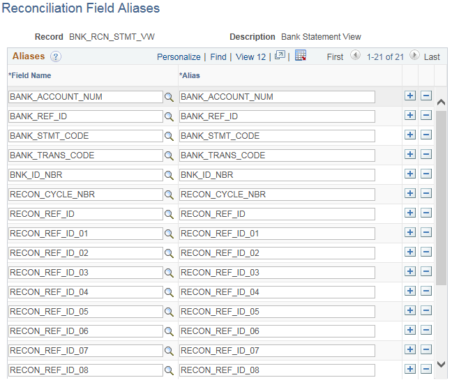

Reconciliation Field Aliases Page
Use the Reconciliation Field Aliases page (RCN_DEFINE_EFLD_PL) to create aliases for field names to make field names easier to identify in setup pages.
Navigation:
Banking, and then Administer Reconciliation, and then Reconciliation Field Aliases
This example illustrates the fields and controls on the Reconciliation Field Aliases page.
The selected reconciliation record determines which field names you can access on the Reconciliation Rules page.
Field Name
Enter the field name in the record.
Alias
Enter an alternate name from the field name to use when defining reconciliation rules.

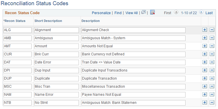

Reconciliation Status Codes Page
Use the Reconciliation Status Codes page (RCN_STATUS_PNL) to view system-defined statuses that are applied during the auto-reconciliation process.
If you want to add additional exception status values and generate exceptions with those status values, a system administrator must customize the Bank Reconciliation program.
Navigation:
Banking, and then Administer Reconciliation, and then Reconciliation Status Codes
This example illustrates the fields and controls on the Reconciliation Status Codes page.
This list shows the delivered reconciliation exceptions generated for each reconciliation source:
Reconciliation Source Exception Status
Amount Tolerance, Date Tolerance, Type Tolerance
Payables
Alignment Tolerance, Amount Tolerance, Date Tolerance, Duplicate Tolerance, Overflow Tolerance, Type Tolerance
Receivables Debits
Receivables Drafts
Treasury

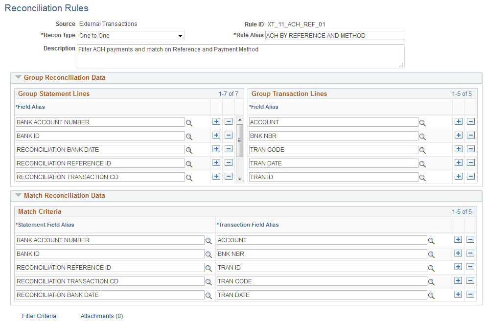

Use the Reconciliation Rules page (BANK_RECON_RULE) to define reconciliation rules for an individual transaction source. Set up aggregate criteria, match criteria, and filter criteria for statement lines and transactions.
Navigation:
Banking, and then Administer Reconciliation, and then Bank Recon Rules, and then Reconciliation Rules
This example illustrates the fields and controls on the Reconciliation Rules page.
Source
Bank reconciliation supports rules for these sources:
  • External Transactions
  • Payables
  • Receivables Deposits
  • Receivables Direct Debits
  • Receivables Drafts
  • Receivables Payments
  • Treasury
Recon Type
Select from the following reconciliation types:
  • Many to Many
  • Many to One
  • One to Many
  • One to One
Rule ID
Enter the rule ID.
Rule Alias
Enter a rule name.
Description
Enter a description of the rule.
Reconciliation Criteria
Group Statement Lines
Enter aggregate criteria for statement lines.
Do not include the amount field.
When one statement line should be matched with one or more transaction lines (One to One or One to Many), group statement lines by Bank ID Number, Bank Account Number, Statement ID (Recon Cycle Number), Record Sequence Number, and Value Date. Add additional grouping criteria as needed.
When multiple statement lines should be summed up to match with one or more transaction lines (Many to One or Many to Many), group statement lines by Bank ID Number, Bank Account Number, Statement ID (Recon Cycle Number), and Value Date. Add additional grouping criteria as needed.
Group Transactions Lines
Enter aggregate criteria for transaction lines.
The transaction field alias varies by reconciliation source. When one transaction line should be matched with one or more statement lines (One to One or One to Many), group transaction lines by key fields, bank information, and transaction date.
Use the following grouping criteria for each source:
  • External Transactions: Bank ID Number, Bank Account Number, Transaction Date, and Transaction ID.
  • Payables: Bank SetID, Bank Code, Bank Account Key, Bank ID Number, Bank Account Number, Payment ID, and Date.
  • Receivables Deposits: Deposit Business Unit, Deposit ID, Bank ID Number, Bank Account Number, and Date.
  • Receivables Direct Debits: Direct Debit Business Unit, Direct Debit ID, Bank ID Number, Bank Account Number, and Date.
  • Receivables Drafts: Draft Business Unit, Draft ID, Bank ID Number, Bank Account Number, and Date.
  • Receivables Payments: Deposit Business Unit, Deposit ID, Payment Sequence, Bank ID Number, Bank Account Number, and Date.
  • Treasury: Source Code, Source Business Unit, Source ID, Business Date, Cash Flow Line, Cash Flow Leg, and Sequence Number.
Add additional grouping criteria for each source as needed.
Match Criteria
Enter match criteria.
Only match using criteria that have been used to group statement lines and transaction lines. For all rules, match on Bank ID Number, Bank Account Number, and Date. Add additional match criteria for each rule as needed.
Filter Criteria
Click this link to access the Filter Criteria page (BANK_RCN_FLT_SP), where you can add statement filter criteria and transaction filter criteria.
Click to view/ add attachments. See Application Fundamentals: Installation Options - Multiple Attachments Page to define the maximum attachment upload limit for various products.
Viewing Bank Reconciliation Rules
You can run the BANK_RECON_RULES query to view all configured bank reconciliation rules.
The query provides the following information for each rule:
  • Source Name
  • Reconciliation Type
  • Rule ID
  • Rule Alias
  • Description
  • Statement Group
  • Statement Filter
  • Transaction Group
  • Transaction Filter
  • Match Criteria

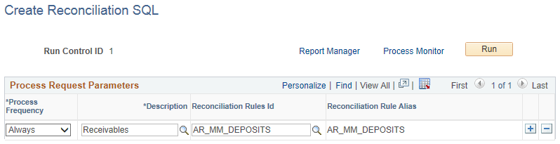

Create Reconciliation SQL Page
Use the Create Reconciliation SQL page (RCN_CREATE_SQL) to run Reconciliation Rules SQL processing for an individual source and the specified rule within the source.
Run the RCNCREATESQL process each time a new reconciliation rule with filter criteria is added to a source or filter criteria are added or modified for a rule.
Navigation:
Banking, and then Administer Reconciliation, and then Bank Reconciliation SQL, and then Create Reconciliation SQL
This example illustrates the fields and controls on the Create Reconciliation SQL page.
Bank Reconciliation processing (RCNCREATESQL) evaluates the source and reconciliation rules to build the filter SQL, and stores the SQL.

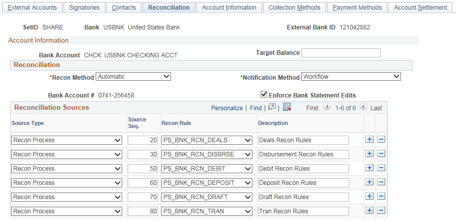

External Accounts - Reconciliation Page
Use the External Accounts - Reconciliation page (BANK_PNLRECON) to select a method of reconciliation to use for each external account. Specify reconciliation sources to be used by semi-manual reconciliation.
Reconciliation sources specified on the External Accounts - Reconciliation page are not used by the Automated Reconciliation process.
Before establishing reconciliation rules for bank accounts, you must set up the bank accounts.
Navigation:
Banking, and then Bank Accounts, and then External Accounts, and then Reconciliation
This example illustrates the fields and controls on the External Accounts - Reconciliation page. You can find definitions for the fields and controls later on this page.
Recon Method (reconciliation method)
Select the method to use for reconciling transactions for this account.
Automatic: Matches bank transactions to system transactions automatically. You must receive transaction information from your bank in an electronic format or enter your bank statements online to use this option.
Manual: You must use manual reconciliation when you have only printed bank statements. With this option, you view only the system transactions online and match them to those in your printed bank statement.
None: Use this option when reconciliation processing is not necessary.
Semi Manual: Use this option to compare system transactions and bank transactions online and match them manually.
Notification Method
Select a notification method for bank reconciliation exceptions. The reconciliation method must be Automatic to select a notification method. If the reconciliation method is Manual, None, or Semi Manual, the notification method is No Workflow.
If the reconciliation method is Automatic, you can choose from these options:
  • No Workflow - Select this option to disable user notifications.
  • Notification Framework - Sends email and worklist notifications using the Events and Notification Framework in Enterprise Components. This method notifies users by email and worklist, and consolidates all exceptions for one bank account statement into each notification. You can view the exceptions for a bank account statement on the Automatic Reconciliation Exceptions page.
  • Workflow - Sends notifications for each bank reconciliation to users using PeopleSoft Virtual Approver.
Enforce Bank Statement Edits
Selecting this option affects bank statement entry by:
  • Displaying a warning message if the bank balance entry is missing an opening or closing balance (codes 010 and 015).
  • Displaying a warning message if the sum of the bank transactions plus the opening balance does not match the closing balance.
Reconciliation Sources
The source types that you select determine which system data (reconciled against the bank statement) appear on the different reconciliation pages (Semi Manual Reconciliation page and Manual Reconciliation page).
Source Type
Defines the process type to take place. Assign Recon Process to all rows for semi-manual and manual reconciliation.
Source Seq (source sequence number)
Specify a number to order the processing of the source types. The first row contains the lowest number and executes first, and the last row has the highest number.
Recon Rule (reconciliation rule)
Identifies the reconciliation rule used for reconciling the reconciliation sources. PeopleSoft delivers seven rules:
PS_BNK_RCN_DEALS - Treasury Cash Flow Rules.
PS_BNK_RCN_DEBIT - Receivables Direct Debit Rules.
PS_BNK_RCN_DEPOSIT - Receivables Deposit Rules.
PS_BNK_RCN_DISBRSE - Payables Disbursement Rules.
PS_BNK_RCN_DRAFT - Receivables Draft Rules.
PS_BNK_RCN_PAYMENT - Receivables Payment Rules.
PS_BNK_RCN_TRAN - External Transaction Rules.
Note: For receivables, reconcile either Deposits or Payments, not both. Ensure that both the External Accounts - Reconciliation page and the Bank Account Reconciliation Rules page are configured to reconcile the same source. If you choose Deposits on the Bank Account Reconciliation Rules page, then also choose Deposits on External Accounts - Reconciliation page. Semi-manual reconciliation displays Deposits or Payments on the transaction grid based on the configuration on External Accounts - Reconciliation page.
If you use your own rules, the system administrator should make appropriate code changes.

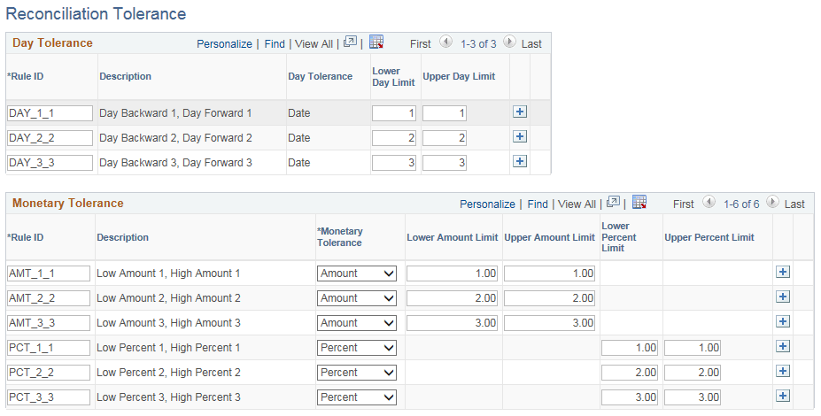

Reconciliation Tolerance Page
Use the Reconciliation Tolerance page (BANK_RECON_TOL) to define day or monetary reconciliation tolerances to associate with a reconciliation rule.
For monetary tolerances, the tolerance type can be an amount or percent.
Associate tolerances defined on this page with a reconciliation rule on the Bank Account Reconciliation Rules page.
Navigation:
Banking, and then Administer Reconciliation, and then Bank Recon Tolerances, and then Reconciliation Tolerance
This example illustrates the fields and controls on the Reconciliation Tolerance page.
When you select Day Tolerance, enter the following values:
  • Rule ID
  • Day Tolerance
  • Lower Day Limit and Upper Day Limit
When you select Monetary Tolerance, enter the following values:
  • Rule ID
  • Monetary Tolerance - Select from Amount or Percent.
  • Lower Amount Limit and Upper Amount Limit
    or
    Lower Percent Limit and Upper Percent Limit
Some reconciliation tolerances are delivered as system-defined tolerances, and these cannot be deleted.
Use the Bank Account Reconciliation Rules page (BANK_ACCT_RCN_RULE) to assign reconciliation rules by source to a bank and bank account. The Automatic Bank Reconciliation process (BNK_RECON) uses these rules to reconcile bank statement lines with transaction lines.
After setting up reconciliation rules and running the Reconciliation Rules SQL process, you can attach the bank reconciliation rules to a bank and bank account.
Navigation:
Banking, and then Administer Reconciliation, and then Bank Account Recon Rules, and then Bank Account Reconciliation Rules
This example illustrates the fields and controls on the Bank Account Reconciliation Rules page.
For each bank and bank account, assign the reconciliation source and assign reconciliation rules associated with the source. For example, for one bank account, you do the following:
  • Select a source and identify a sequence number.
    • Enter date and amount exceptions for the bank account reconciliation rule, and a holiday list ID, if desired.
    • Add reconciliation rules, including the reconciliation rules ID, a date or amount tolerance, and an accounting template ID.
    When the amount on the bank statement line is different from the amount on the source transaction, reconciliation process checks if the difference is within the acceptable amount tolerance limits associated to the reconciliation rule. If the difference is within the acceptable amount tolerance limits, reconciliation process creates an external transaction for the difference that is stamped with the accounting template ID associated to the reconciliation rule.
  • Use the Add a New Row button to select another source and corresponding reconciliation rules for the bank account.
Deselect the Use Rate Table check box to use the exchange rate at the transaction level. This option is available only for these reconciliation sources: Payables, Deposits, and Receivables Payments. For other sources, this option is display-only and the market rate table is used by default.
When assigning the reconciliation source for a bank and bank account, you can configure either Receivable Deposits or Receivable Payments, not both at the same time.
