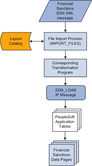

Understanding the SDN List Import
This diagram illustrates importing the Specially Designated Nationals (SDN) List from an XML data file using the File Import Process and populating the corresponding application tables with the SDN data
SDN List Import process
The SDN List Import process involves the following steps:
  1. An administrator enters information pertaining to a financial sanctions, SDN data file in XML format.
    This initiates the File Import Application Engine process (IMPORT_FILES), which functions as an interface or shell to define the necessary commands for the system to import the SDN data files.
  2. The File Import Application Engine reads the layout definition data for the file (which is stored in the Layout Catalog) and calls the corresponding transformation process.
  3. Using the SDN_LOAD IP message, the transformation Application Engine loads the data into the application tables.
See PeopleSoft Financial Gateway: Understanding Electronic Banking.

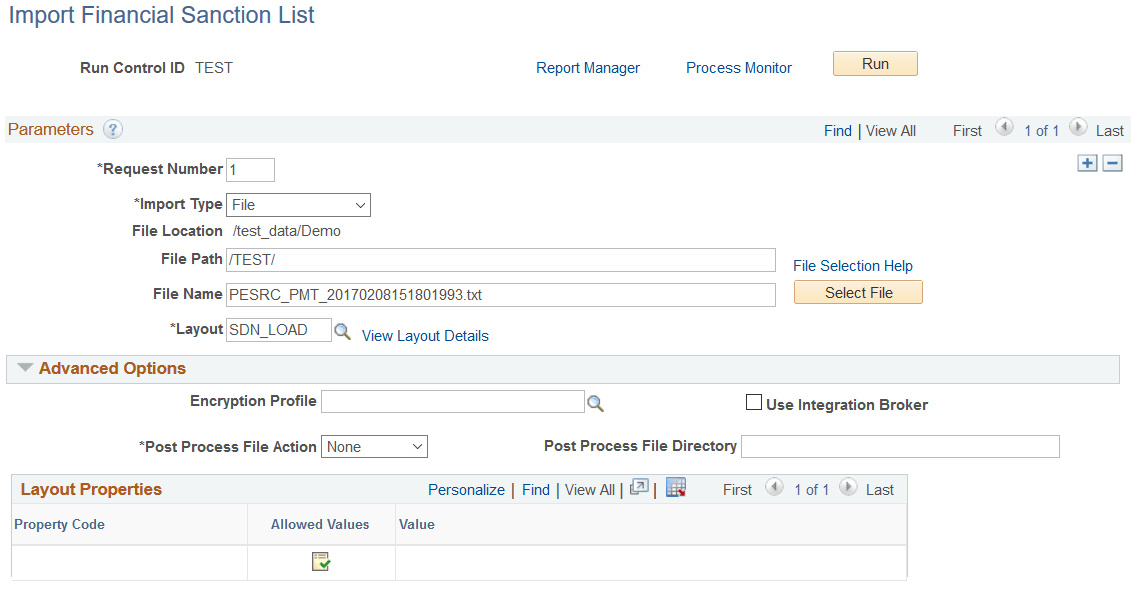

Import Financial Sanction List Page
Use the Import Financial Sanction List page (BSP_IMPORT) to load the financial sanctions SDN List into the system.
Navigation:
Banking, and then Financial Sanctions, and then Import Financial Sanction List
This example illustrates the fields and controls on the Import Financial Sanction List page. You can find definitions for the fields and controls later on this page.
Field or Control Description
Import Type
Select the method to import the sanction data. Options are:
  • FTP: Select if you are importing the file by using file transfer protocol, and enter a node through which to transfer the data.
  • File: Select if you are importing a file from a file server, and complete the File Path and File Name fields.
  • HTTP: The OFAC and European Union (EU) websites provide access to the sanctions list using a URL. No file path or file name is required.
File Location
Appears when using the File import type only. Displays the file location entered on the configuration page by a bank integration administrator. Users have access only to the folders below the base path displayed in the File Location field.
For more information, see PeopleSoft Banks Setup and Processing: Managing Import File Locations.
Integration Node
Enter the bank node that was used to transfer the data. This field appears only if FTP or HTTP is selected as the import type.
View Integration Node Details
Click to access the Node Details page and review property details of the selected node. This link is available only if FTP or HTTP is selected in the Import Type field.
File Path
Enter a file path according to the import type selected:
  • File Import Type: Leave this field blank to select a file in the base path shown in the File Location field, or enter a folder name with trailing backslash below the base path, for example, /Bank02/.
    Wildcard characters are not supported when using the File import type.
  • FTP Import Type: Enter the complete file path location. To select files by using the Select File button, you must include a trailing backslash (\) in the file path.
    You can you can also load all files in a given directory by using the *.* notation or search for files of a specific type by entering an asterisk and the extension suffix. For example, to search all files with an .xxx suffix, enter \*.xxx.
  • HTTP Import Type: Does not require a file path and the field is unavailable.
Note:Be sure that the application server and the Process Scheduler have access to the directory, FTP node, or HTTP node where the files are staged for import.
File Selection Help
Click to view help information about specifying file paths and file names.
File Name
Select the specific file to import. If you want to import multiple files based on extension for the FTP import type, leave this field blank.
Layout
Select the file layout of the SDN List file that is being imported. PeopleSoft provides the following layouts:
  • OFAC: Layout that is used to download SDN data from OFAC.
  • EU: Layout that is used to download financial sanctions data identified by the European Union.
  • SDN_LOAD: Generic that is layout used to download Enterprise Sanctions List data that is generated within your organization.
Advanced Options
Encryption Profile
Select an encryption profile to decrypt bank statements. Encryption profiles contain both encryption and decryption information.
Use Integration Broker
Select to lay out the files and publish the formatted document to PeopleSoft Integration Broker. Integration Broker then processes the formatted file accordingly.
You select this option if you want to use the financial sanctions information as a trigger to Integration Broker to perform other processes, or to integrate with other systems.
Post Process File Action
Select what action, if any, to perform on the bank statement files after the data has been processed. The options are:
  • Copy: Copy the file to the directory that is entered in the Post Process File Directory field.
  • Delete: Delete the file after the data in it is processed.
  • Move: Move the file to the directory that is entered in the Post Process File Directory field.
  • None: Perform no action.
Enter a file path to the directory to which the file will be moved or copied if either option is selected as the post process file action.
Layout Properties
Value
Property codes and values appear by default from values that are defined on the selected layout ID.
If you configure unique code mappings for a layout (on the Code Mappings page), you need to modify the displayed CODE_MAP_GROUP value with the appropriate unique map value.
See PeopleSoft Financial Gateway: Code Mappings Page.

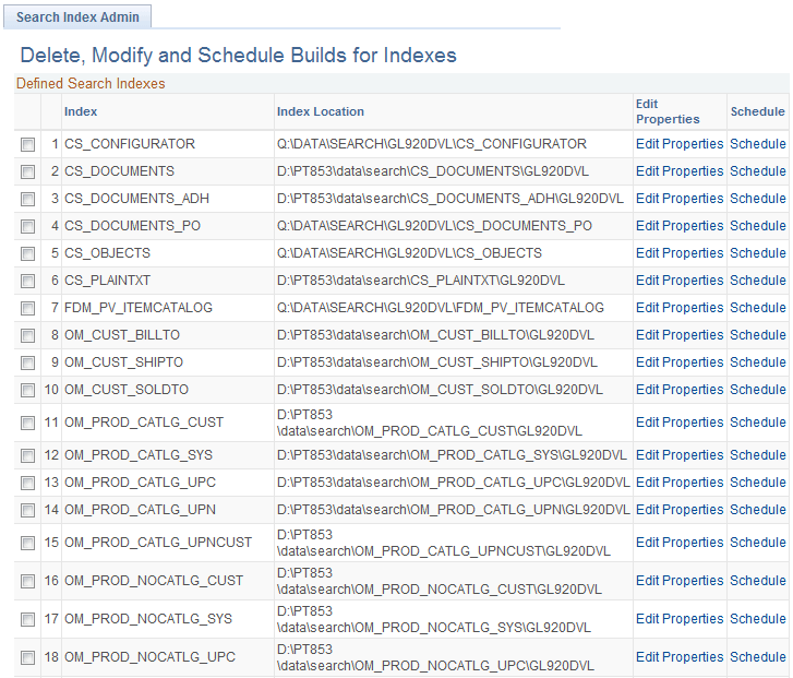

This example illustrates the fields and controls on the Search Index Admin page (1 of 2). You can find definitions for the fields and controls later on this page.

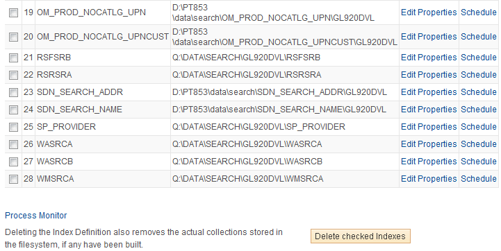

This example illustrates the fields and controls on the Search Index Admin page (2 of 2).
To initially build or rebuild an existing SDN search index:
  1. Select SDN_SEARCH_ADDR and SDN_SEARCH_NAME.
    You must initially build both the SDN_SEARCH_ADDR and the SDN_SEARCH_NAME indexes for the downloaded financial sanctions data.
    You must rebuild both the SDN_SEARCH_ADDR and the SDN_SEARCH_NAME indexes after downloading updated financial sanctions data.

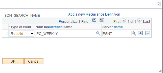

  2. Click the Schedule link for both the SDN_SEARCH_ADDR and the SDN_SEARCH_NAME indexes.
    The Search Index Admin secondary page appears.
  3. In the Type of Build field, select Rebuild.
    Select Rebuild as the type of build for the initial build as well as for the rebuild.
  4. Select the Run Recurrence Name and Server Name, and click OK.
    This returns you to the Search Index Admin page.
  5. Click Save.
This example illustrates the fields and controls on the secondary page to build or rebuild the SDN index.
Search Index Admin - Schedule page
