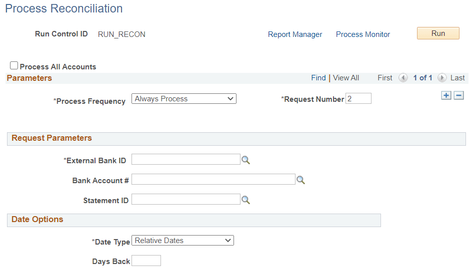

This example illustrates the fields and controls on the Process Reconciliation page. You can find definitions for the fields and controls later on this page.
Process Reconciliation Page
Field or Control Description
Process All Accounts
Select the check box to submit the bank reconciliation process for all bank accounts to which the user has access. The access to bank accounts can be granted using the Financial Gateway security feature.
Note: When you select this option and saves the component, a row is written into the PS_RECON_REQ_RUN table. When the reconciliation process is submitted, application deletes the rows on PS_RECON_REQUEST table corresponding to the Run Control ID. Then, the table is populated with the Bank Account details and the reconciliation process is run. Since a delete happens in the PS_RECON_REQUEST table, all the saved data for the Run Control ID is lost and new data will be fetched based on the Financial Gateway security. Bank Reconciliation (BNK_RECON), Statement Accounting (TR_STMTACCTG) and Load Bank Statements (AR_BNKSTMT) processes share the same run control record. If the user has created one Run Control ID for all three processes and then selects the Process All Accounts check box, the data in PS_RECON_REQUEST table will be rewritten every time the Bank Reconciliation process is run. Hence, it is recommended to use separate Run Control IDs if you intend to run Bank Reconciliation (BNK_RECON), Statement Accounting (TR_STMTACCTG) and Load Bank Statements (AR_BNKSTMT) processes for separate Bank Accounts with Process All Accounts option selected.
Process Frequency and Request Number
Enter your process frequency and request parameters.
Statement ID
You can enter a specific statement ID or you can leave the Statement ID field blank. The system runs the selected process for all statements that are not marked complete (C).
Select any combination of the three reconciliation methods to process the defined transactions, and click OK.
