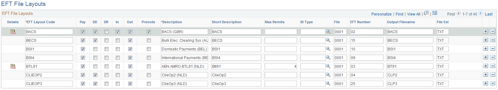

EFT File Layouts Page
Use the EFT File Layouts page (EFT_LAYOUT) to view, modify, and add EFT layouts.
Navigation:
This example illustrates the fields and controls on the EFT File Layouts page. You can find definitions for the fields and controls later on this page.
The options next to the EFT Layout Code field determine the purpose of the EFT file, where applicable.
| Field or Control | Description |
Pay |
Select if the file layout is for payment files. |
DD |
Select if the file layout is for direct debits. |
DR |
Select if the file layout is for draft files. |
In |
Select if the file layout is for inbound files. |
Out |
Select if the file layout is for outbound files. |
Prenote |
Select if the file layout is for a prenote. |
The remaining fields are:
Federal Payment Indicator |
Indicates that an EFT layout is applicable for federal payments. When a voucher is saved, the system verifies that the correct payment format is selected for the vendor/supplier type bank account. Note: This field is visible only when Enable Federal Payment is selected on the Installation Options - Payables page. Select from these options: Employee: You must associate employee vendor/supplier payment methods with a valid PPD or PPD+ EFT file layout. Delivered valid file layouts are SPSTRVL, SPSTRVLSDA, PAMTRVLSDA, SF116TRVL, and SPSIATTRVL. Supplier: You must associate all other vendor/supplier (non-employee) payment methods with a valid CCD or CTX EFT file layout. Delivered valid file layouts are SPSVNDR, SPSVNDRSDA, PAMVNDRSDA, SPSMISC, SPSMISCSDA, PAMMISCSDA, SPSIATVNDR, SPSIATMISC, SF1166VNDR, CTX, and CTX820FED. Both: For employee and vendor/supplier payments. You must associate this option with a valid PPD or PPD+ EFT file layout. Delivered valid file layouts are SPSCHK, SDPR, and SF1166SCHK. For delivered valid layouts, see Understanding U.S. Federal ACH and EFT Layouts in this topic. |
Max Remits (maximum remittances) |
Use to limit the number of invoices that are included on each payment to the specified number. |
ID Type |
Enter the type of identification number to identify the trading partners on the EFT file. You enter these different types of identification numbers when you set up business units, customers, and suppliers. |

Click Details for the CPA005 file layout on the EFT File Layouts page.

Click Details for the DTALSV file layout on the EFT File Layouts page.

Click Details for the DTAZV file layout on the EFT File Layouts page.

Click Detail for the ETEBAC EFT file layout on the EFT File Layouts page.

Click Detail for the FEDI EFT file layout on the EFT File Layouts page.

You define these values on the EFT File Layouts Page.
