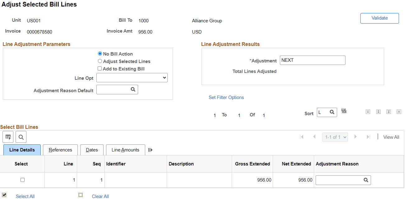

Adjust Selected Bill Lines Page
Use the Adjust Selected Bill Lines page (BI_ADJ_LINE) to adjust specific bill lines.
Navigation:
Billing, and then Maintain Bills, and then Adjust Selected Bill Lines
This example illustrates the fields and controls on the Adjust Selected Bill Lines page.
In the Line Adjustment Parameters group box, select:
Field or Control Description
Validate
Select to validate the original bill for errors before doing an adjustment. Validation errors are displayed on the Validate Errors Page (Adjust Entire, Adjust Selected, Copy Single).You can select one or more lines before selecting this button.
No Bill Action
When you first access the page, the system uses this field as the default bill action. This setting prevents you from adjusting the bill unintentionally.
Adjust Selected Lines
Enables you to adjust any combination of lines on this bill. When you select this option, the Add to Existing Bill check box appears.
Select to add the lines to an existing bill. If you do not select this check box, the system generates a new bill for these adjustment lines. However, you can add only adjusted bill lines that contain value-added tax (VAT) information to a new bill. The new bill will contain an exact copy of the source bill VAT header.
This field is not available for India GST invoices.
Note: If you add lines with summarization templates to a non-summarized bill, a summarized invoice may be printed when the invoice is generated.
Line Opt (line options)
Select a value:
Create Net Adjustment Only: Creates one adjustment line.
Create Reversal and Rebill: Creates two new lines, one that credits the original line chosen, and one that reflects the adjustment.
Credit Line: Creates one line with a reversal of the amounts from the original line chosen.
Adjustment Reason Default
Select the appropriate code from a list of valid reason codes that will be made available to the user via a prompt list. A reason code is required for a reversal line and a credit line.
In the Line Adjustment Results group box, the system displays one of these fields:
Add To Bill
The system displays this field if you elect to add to an existing bill. Enter the invoice number of the existing bill to which you want to add the lines. If you elect to add to an existing bill but there are no existing bills available, select No Bill Action, reselect Adjust Selected Lines, and deselect Add to Existing Bill.
Note: Adjusted Project Costing and Contracts lines should never be added to non-Project Costing or Contracts bills.
Adjustment
The system displays this field if you elect to add to a new bill. The system assigns the default invoice number NEXT to the adjustments. If you specify the invoice ID for this type of bill as user-definable for adjustments on the Invoice Number page, you can assign your own invoice numbers to the credit bill or rebill by overriding NEXT. If you select this option, you can use invoice numbers that are designed specifically for credit bills and rebills.
Note: You can adjust a bill header or bill line only once.
Set Filter Options
Select this link to enter search values and to filter the invoice lines returned that need to be adjusted. After entering the values, the user will have the option to search, clear search or return to the Adjust Selected Bill Lines page.
Header Info 1 and Bill Line - Info 1 (bill line - information 1)
Click to access the corresponding bill in bill entry. You can make any necessary changes there and then process the bill as usual.
Select Bill Lines
All lines that satisfy the search criteria appear in this scroll area. The grid tabs at the top of the list enable you to view different bill fields.
You can control which lines the system returns by defining the Bill Line Number, and Date fields.
If you are initiating multiple searches and changing the criteria often, re-enter the criteria to reset the search path and assure a complete search.
