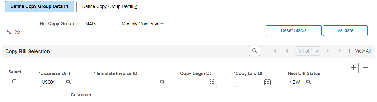

Define Copy Group Detail 1 Page
Use the Define Copy Group Detail 1 page (BI_BILL_CPY_GRP) to assign bills to appropriate copy groups.
This is the second step when defining groups of bills to be copied together in a batch.
Navigation:
Billing, and then Maintain Bills, and then Define Copy Group Details, and then Define Copy Group Detail 1
This example illustrates the fields and controls on the Define Copy Group Detail 1 page.
Bills that are not confirmed for Financial Sanctions Screening (FSS) cannot be assigned to copy groups
Field or Control Description
Validate
Select to validate the selected bills for errors. Validation errors are displayed on the Validate Errors Page (Copy Group). You can select one or more bills before selecting this button.
Select
Select the check box next to the bill that you want copied. Deselect this check box if you do not want the bill copied. Assign as many bills to this copy group as required. You do not have to copy all of the templates in the group each time you use this process.
If you are using this copy group for the first time, attach the bills that are to be used as templates by inserting rows and entering values in these fields:
Template Invoice ID
The invoice number to be copied.
Copy Begin Dt (copy begin date) and Copy End Dt (copy end date)
The start and end copy dates for this template. When you initiate the copy bill group process, the system determines whether the run date is within these copy dates.
New Bill Status
The status that is assigned to the new bill.
After you assign template invoices for this copy group, you can manage them all at once by clicking one of these buttons:
Select All
Click to select all of the template invoices for copying.
Deselect All
Click to deselect all of the template invoices from copying.
Reset Status
Click to reset all of the template invoices to new statuses.
