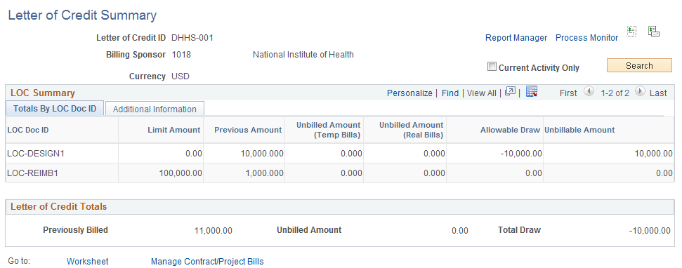

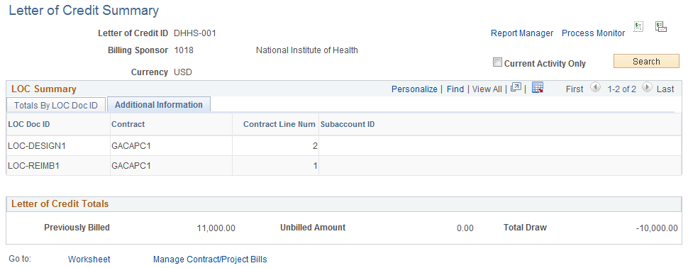

LOC Summary (letter of credit summary)
Click to access the Letter of Credit Summary page, where you can review the letter of credit draw for an individual letter of credit number by document number.

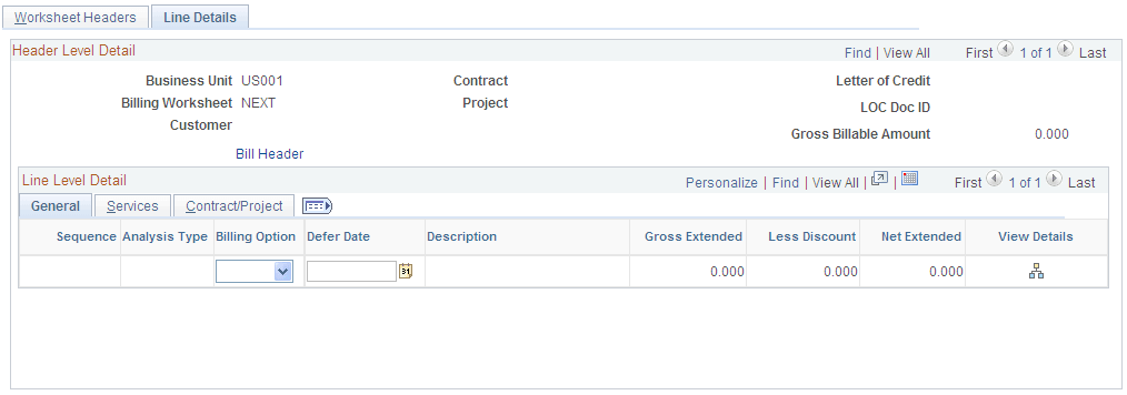

Update Billing Worksheet - Line Details Page
Use the Update Billing Worksheet - Line Details page (BI_TMP_SRCH_DTL) to modify the bill line options, enter a deferred billing date, and review bill line details for the corresponding temporary bill.
Navigation:
  • Billing Manage Billing Worksheet, and then Update Billing Worksheet
    Select the Line Details tab.
  • Select a worksheet from the Update Billing Worksheet - Worksheet Headers page, and click the Line Details tab.
This example illustrates the fields and controls on the Update Billing Worksheet - Line Details page. You can find definitions for the fields and controls later on this page.
You can see multiple views of this page by selecting the tabs (General, Services, and Contract/Project) in the scroll area. The fields that are common to all of the views appear first.
Header Level Detail and Common Line Level Detail
Field or Control Description
Get First Chunk, Get Previous Chunk, Get Next Chunk, and Get Last Chunk
Click these buttons to display worksheet lines that are not loaded in memory. These buttons appear when more worksheet lines exist than the memory could load. To approve or delete these worksheet bills, Oracle recommends that you use the Billing Worksheet batch update program. These buttons do not appear if all worksheet lines can be loaded into memory.
Bill Header
Click to access the Standard Billing - Header - Info 1 page, where you can review the header information for this worksheet bill. You can also navigate to the rest of the standard billing component to calculate taxes, change ChartFields, add additional lines, and generate a pro forma.
Analysis Type
Identifies the type of costs-budgets, commitments, and actuals-assigned to individual resource rows for tracking those costs as they move through different stages of a project.
Billing Option
You can change the analysis type for lines that originate from the PeopleSoft Project Costing system. Depending on the PeopleSoft Project Costing line type, you can change the analysis type to Bill, Defer, Delete, Over Limit, or Write Off. The system initially assigns the billing option based on the line's original analysis type.
You can change the analysis type for lines originating in PeopleSoft Project Costing with a line type other than UTL (utilization) to Defer, Write Off, or Bill.
The Delete value is valid only for lines originating in PeopleSoft Project Costing that have a line type of UTL.
The system copies project lines with an analysis type other than DEF (defer), WTO (write off), OLT (over limit), or DEL (delete) to a real bill when you approve a worksheet. The system does not copy lines to a real bill with analysis types of WTO, DEF, OLT, and DEL. At least one billable line must exist for the worksheet to be processed.
Only lines with an analysis type of BIL can be deferred.
You cannot remove or change lines originating in PeopleSoft Contracts. To change or remove a bill line originating in PeopleSoft Contracts, delete the worksheet and return to the source system to make corrections.
View Details
Click to navigate to the Standard Billing - Line Worksheet page, where you can review the bill line information, make changes, and generate a pro forma.
Oracle recommends that you not change the bill line amount in bill entry for bill lines with SYSTEM_SOURCE = CBI because doing so can produce inconsistencies in data that is maintained within PeopleSoft Contracts, Project Costing, and Billing.

Letter of Credit Summary Page
Use the Letter of Credit Summary page (BI_LOC_SUMMARY) to review the letter of credit draw for an individual letter of credit number by document number.
Navigation:
Billing, and then Manage Billing Worksheet, and then Letter of Credit Summary
This example illustrates the fields and controls on the Letter of Credit Summary page (1 of 2). You can find definitions for the fields and controls later on this page.
Letter of Credit Summary Page (1 of 2)
This example illustrates the fields and controls on the Letter of Credit Summary page (2 of 2). You can find definitions for the fields and controls later on this page.
Letter of Credit Summary Page (2 of 2)
Letter of Credit ID
Indicates the unique identifier code of the letter of credit that an organization has with the federal government.
Generate Pro Forma
Click to generate a PeopleSoft Grants Pro Forma Letter of Credit BI Publisher report. The report includes the amounts for all bills (in the unbilled amount column) with a status of:
TMR: (temporary ready)
TMP: (temporary)
NEW: (new)
RDY: (ready)
HLD: (hold)
PND: (pending)
Pro Forma Letter of Credit is rendered online if the Enable Online Rendering check box is selected on the Billing – General Options page.
Generate Draw
Click to generate a PeopleSoft Grants Finalized Letter of Credit BI Publisher report. The report includes only the amounts (in the unbilled amount column) for bills with a status of RDY.
Note: If Business Process Weaver (BPW) is set up for Billing process, then clicking the Generate Draw icon will initiate the BPW process in a new window.
Current Activity Only
The Current Activity Only check box is selected as default. If the check box is selected, only the LOC Doc IDs that are yet to be finalized on the billing invoices are displayed. Clear the check box to display all the LOC Doc IDs.
Manage Contract/Project Bills
Click to access the Manage CA/PC Bills page, where you can review bills originating in PeopleSoft Contracts and Project Costing.
Worksheet
Click to return to the Update Billing Worksheet - Worksheet Search page.
LOC Doc ID (letter of credit document identifier)
A code that uniquely identifies a funding amount provided under a letter of credit. New awards are given a unique document number. The system populates this field only when CA_CONTR_HDR.GM_METHOD_PAYMENT is LOC (letter of credit).
Limit Amount
The funding limit amount provided by the sponsor from the contract bill line.
Previous Amount
The sum of the pretax invoice amount for bills with the same LOC reference number and LOC document number. This amount includes invoiced bills.
Unbilled Amount (Temp Bills)
The current proposed billing. This column displays all the pending temporary bills: those bills with a status of TMP (temporary) and TMR (temporary ready).
Unbilled Amount (Real Bills)
The current proposed billing. This column displays all the bills approved for billing: those with a bill status of NEW, PND (pending), RDY (ready), and HLD (hold).
Allowable Draw
The maximum that you can bill and draw. If the funding limit, less the previously billed and unbilled amounts, is greater than or equal to zero, the allowable draw is equal to the unbilled amount. Otherwise, the allowable draw is equal to the funding limit less the previously billed amount.
Unbillable Amount
The amount that exceeds the allowable amount. The unbillable amount is equal to the unbilled amount less the allowable amount.
Subaccount ID
Display the unique Subaccount ID entered on the Contract line.
Letter of Credit Totals
The fields in this group box track overall monetary amounts for the corresponding letter of credit number.
